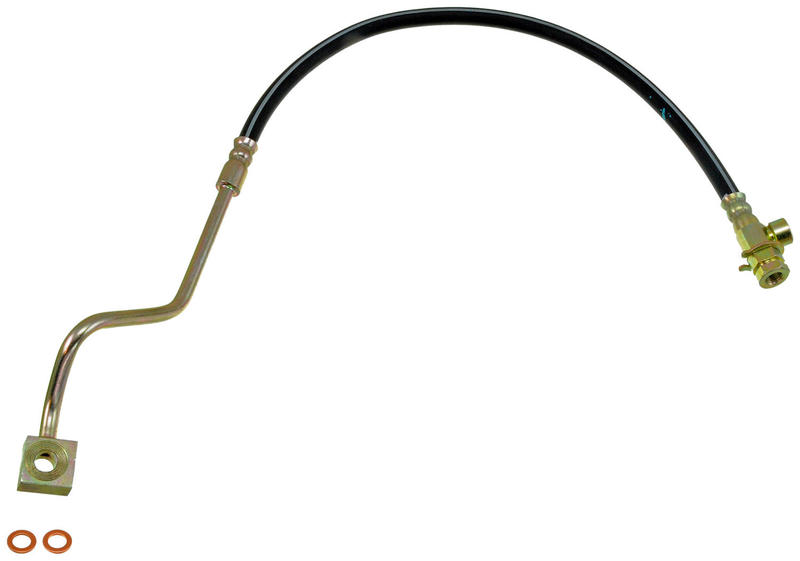

I try to save some $ so i orderd the 2000 F250 brake hoses
(92 with funky fitting)
Dorman H381184 Front Brake Hose
Dorman H381186 Front Brake Hose

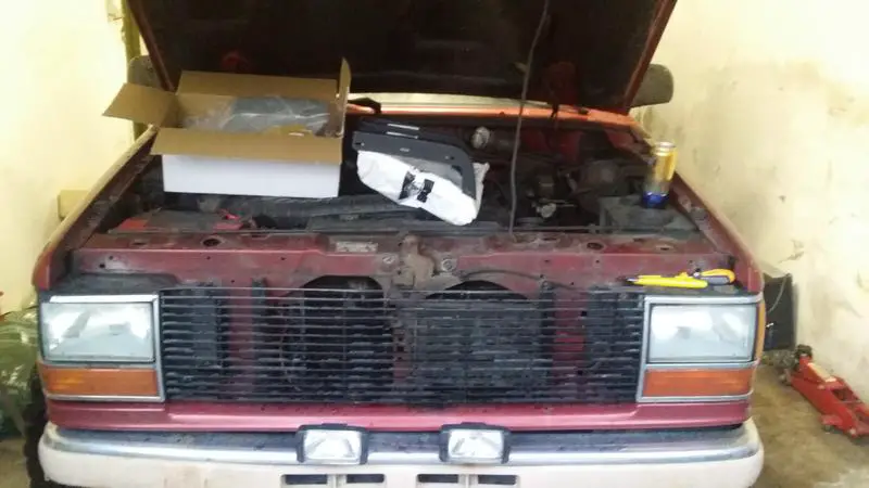

More delays on my lift and fenders...:mad:
ETA 18/3.2015

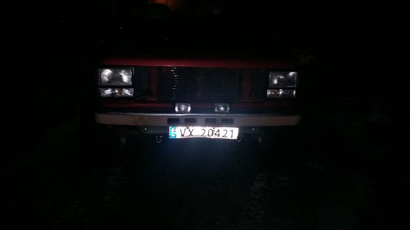

In frustration i post another driveway photo

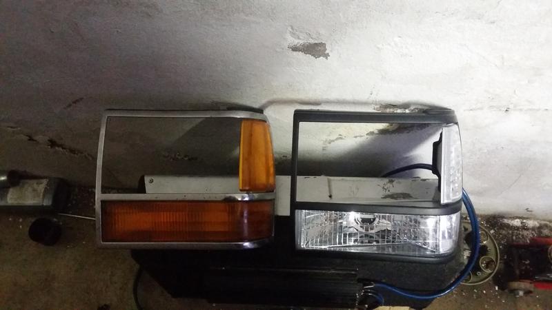

And got my clear turn signals in the mail
(Waiting for black headlight door panels)
Your expo looks great! Where on earth did you find those clear turn signals? Also your u-bolt mounting location, have you had a chance to use them yet? Any issues connecting with the body with your tow line? Very curious as mine is the same year as yours, still mostly stock XLT and I need to fit some tow points before the moab trip in a few months.
