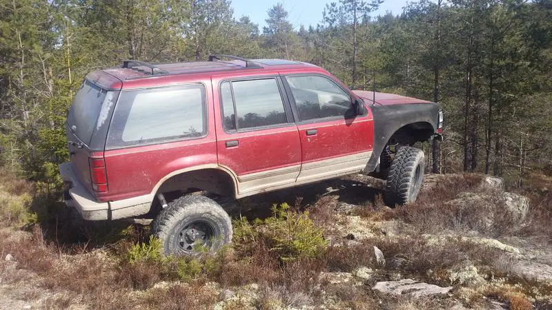

wonder how much lift i got in the rear.. soa gives about 5" but i did mine with some old superlift springs:eek:
It's gotta be more than 6"...my springs sag a bit and the top of the 33's are about in line with the top of that rear trim. Do you have a write up of the SOA and pics of the parts you used? Those shock mounts under your springs look kinda tall...
