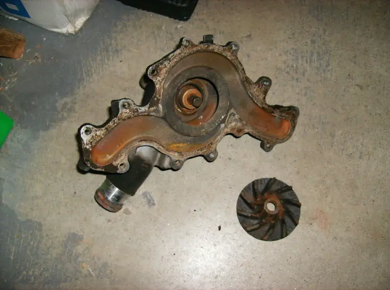

Runs hot after only 3-5minutes.
Top rad hose is very hot, bottom hose is cool
No heat
No water in oil, doesnt see m to be any oil in the water either (flushed dout th coolant and currently running water while I solving the issue)
I'm thinking water pump or thermostat? What do you guyz think?
