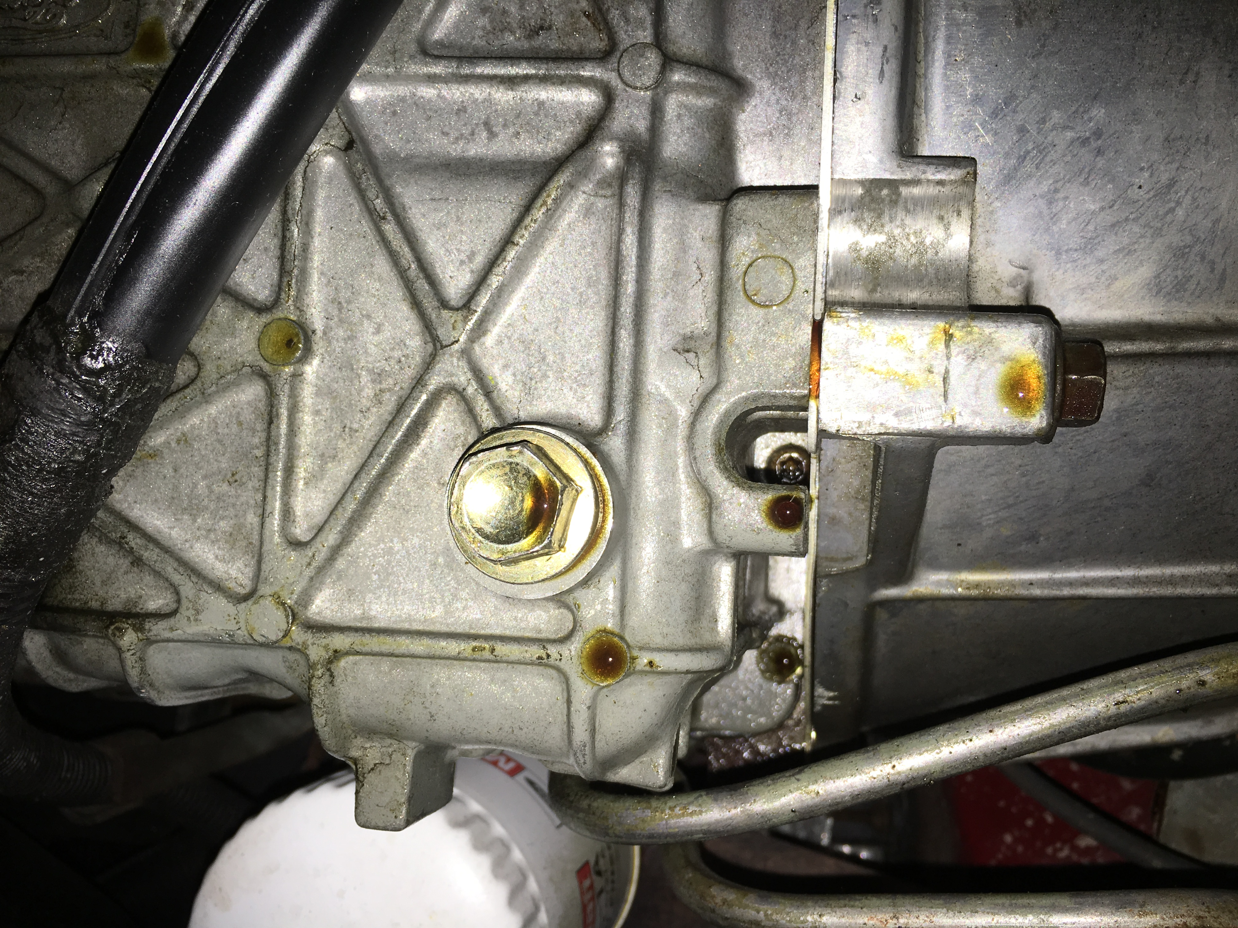

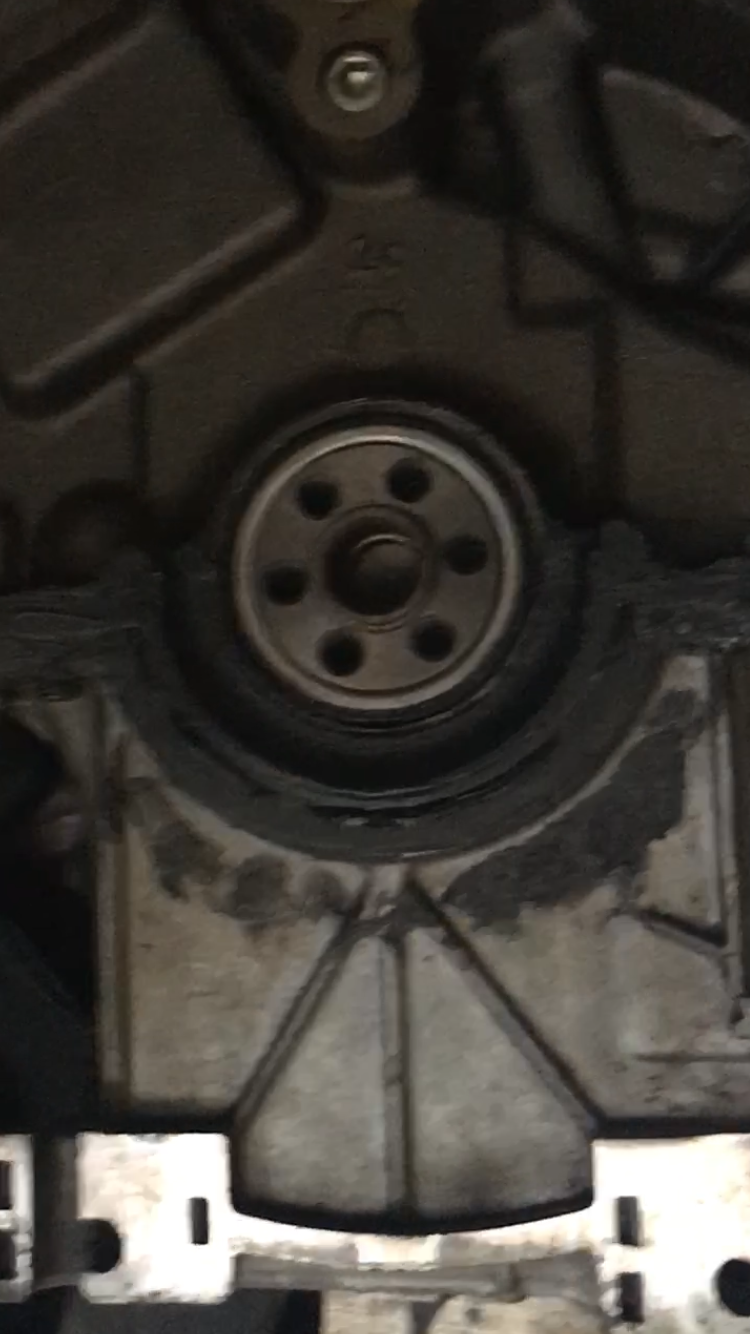

Here are some pics. My oil level stays full but I pull a small boat with it a few times per summer to fish with my Dad. The first oil pool is oct thru March. The second is so far in April.
I am nervous about the whole thing but know it will not get better. It sounds stupid but I love this truck and bought it new when I got out of high school and worked overtime while going to college. I guess like for all of us hard work makes you appreciate what we have in life.

Tossing this out there, maybe it's not a rear main but rather the oil pan gasket? My 1991's hardened and shriveled up so there really was no gasket left, just the metal on metal. You have wet oil forward of the seam between the engine and trans. Sure, oil can be blown around when driving but I'd take a long look at the oil pan as well. It's a common issue and a real turd to replace, much like the rear main.
Thanks for the note. It is at a Ford dealer now. They pulled the trans and saw a metal sleeve was put in the rear seal years ago. This is my third time in 26 years getting addressed. The mechanic showed me how tight the sleeve is against the crank and is now thinking maybe pull engine, take off oil pan to get out and then put in the new rear main with a new sleeve, and also he would put on a NAPA oil pan gasket since a Ford part is no longer available. I won’t have any more info until Monday as the mechanic is out now till Monday. There is also a lot of silicone around the crank/oil pan that he pointed out I assume that independent shop I used in 2008 put on. I checked my records and a rear main was put on in 1995, then again in 1998 both by Ford dealers, then 2008 by a Tuffy shop and now again back at the dealer. I am just praying they can get my baby going again and running ok. It’s tough to see it with the trans out, and maybe now the engine too. Plus my labor bills are running up and I about maxed out money wise.
