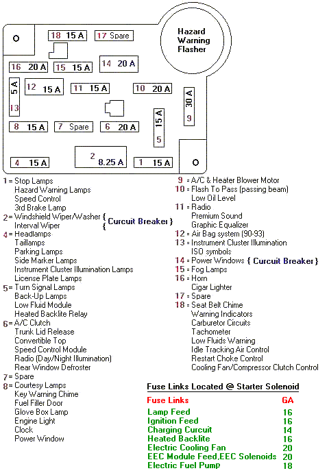

My dome light stays on all the time. I can't find a 92 schematic. The 94 manual says it is #14 but it isn't. I removed all the fuses one at a time on the inside fuse panel and none of them seemed to turn off the light. I would like to fix the problem but killing the circuit is fine for now so I don't run down the battery. Is there some weird wiring system that I need to know about? Can someone look up the fuse on the 92 that it is supposed to be? I searched the net and this forum and can't find the 92 info.
Removing the dome light bulbs did not stop the battery from running down.
Your help would be greatly appreciated!
