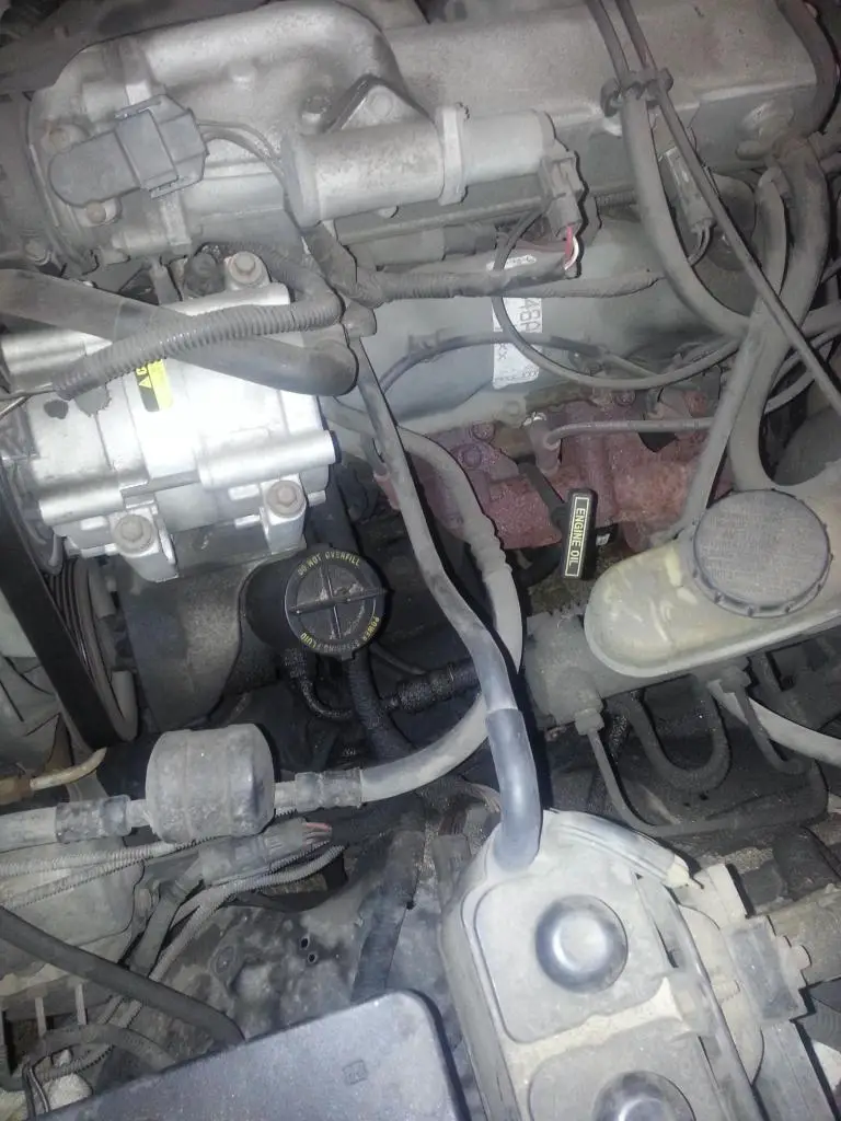

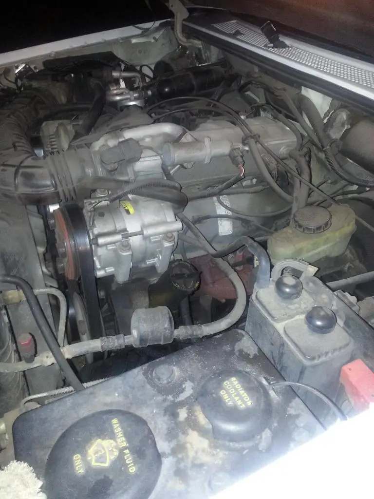

http://s36.photobucket.com/user/Tin...Uploads/20141214_180240_zps621a5496.jpg.html]
[/URL][/IMG]

You do not have EGR. If you did, it would be on that flat side of your intake manifold.
What code did you get exactly?
Looks like an early 93; has the 93/94 style power distribution box, but the earlier style intake ducting and no EGR. Probably does not have a CPS either.

You have no EGR on that truck.
I think you might have had the 111 flashed 2 times at you, which is system check ok
I can see how it would be confused with a 33, since it is 3 flashes 2 times in a row. ;)
