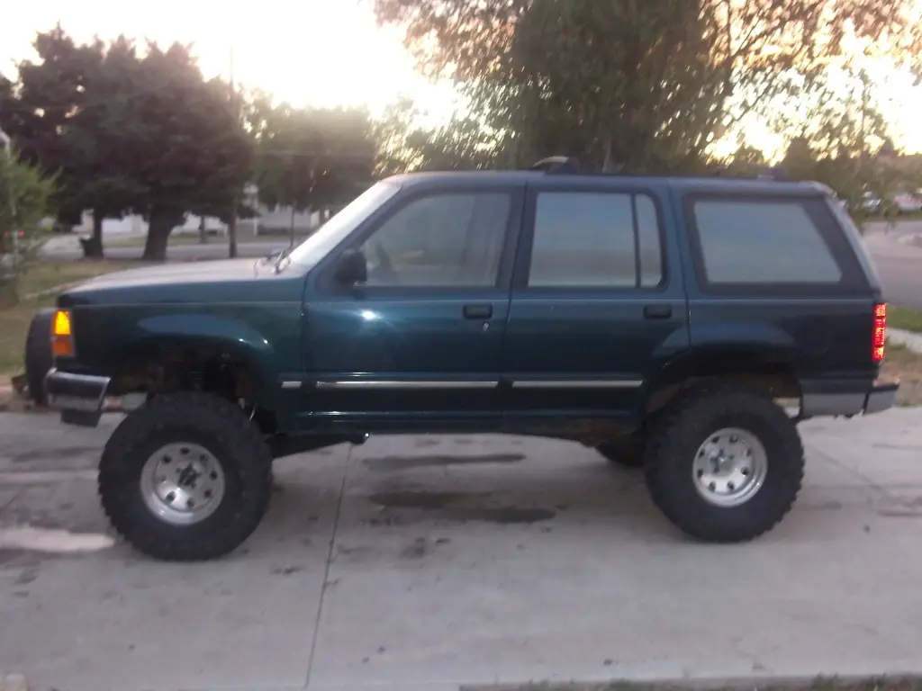

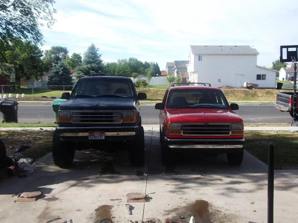

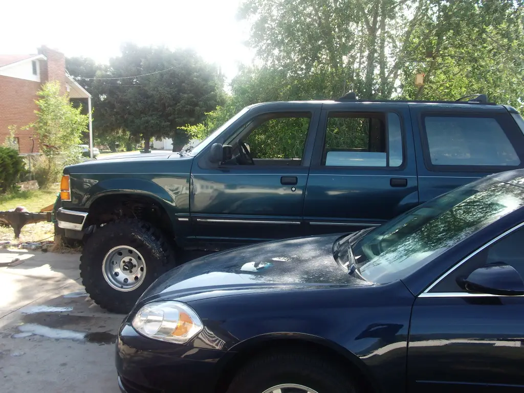

Ok so i didn't take many pictures while working today cause there wasn't anything real new to show just some minor finishing touches. All in all i think its awesome and went pretty good. Still need to get a professional alignment and some NEW tires but i am pretty satisfied. Anyway here is pics of the finished product.

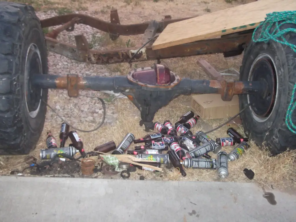

So my kids were looking at the trucks parked next to each other and i had to share the comment made. They said mine is like "The Hulk" and Anthony's is like "Captain America" LMAO we got a huge kick out of that!!! Anyway the next picture is of the beer bottles and brake cleaner bottles that i used!! still gotta clean that up lol!!

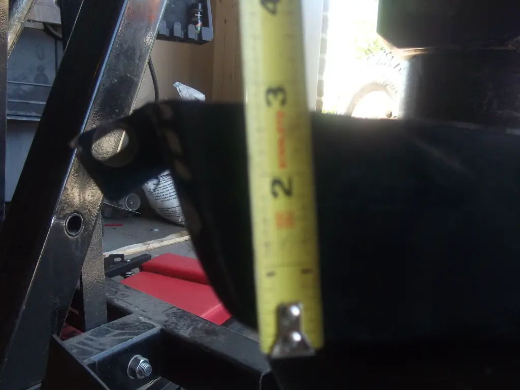

ok here is the pictures of the crossmember!

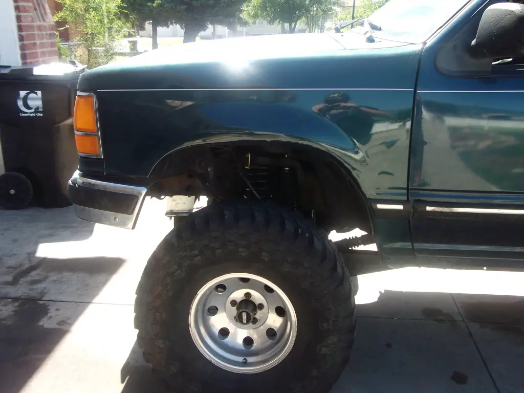

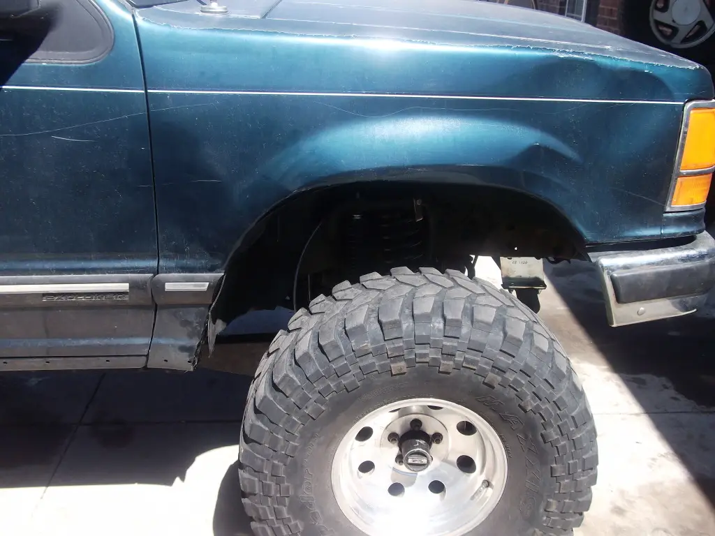

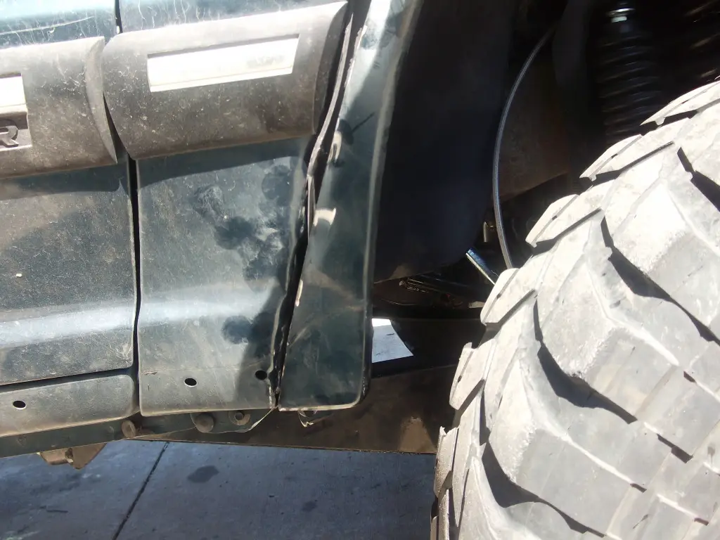

Definitely need to figure something else out with the e-brake cable and i have been given an idea or two so will pursue these and fill ya in on what i did. Meanwhile i did some fender trimming today and i am pretty happy with the results so far. Here are some pics.
What i did was used electrical tape to form the new Edge i was going to cut then i cut it with an angle grinder then used a crescent wrench to bend the lip in and a rubber mallet to try and smooth it out some.

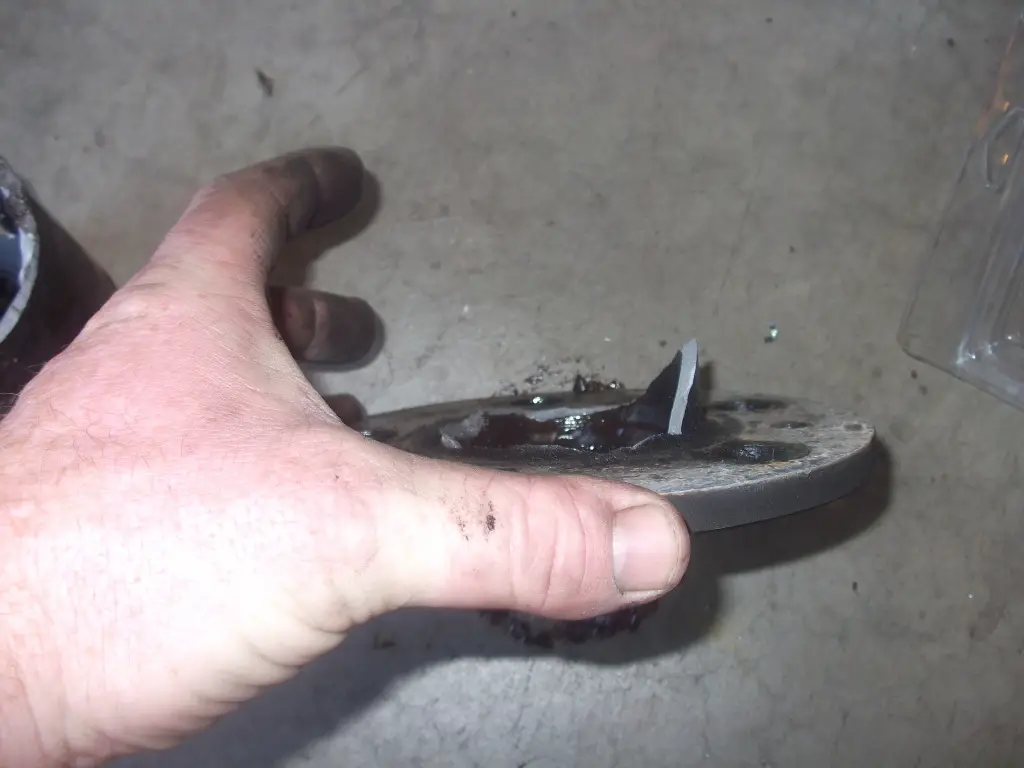

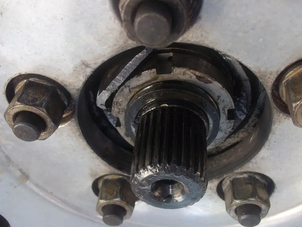

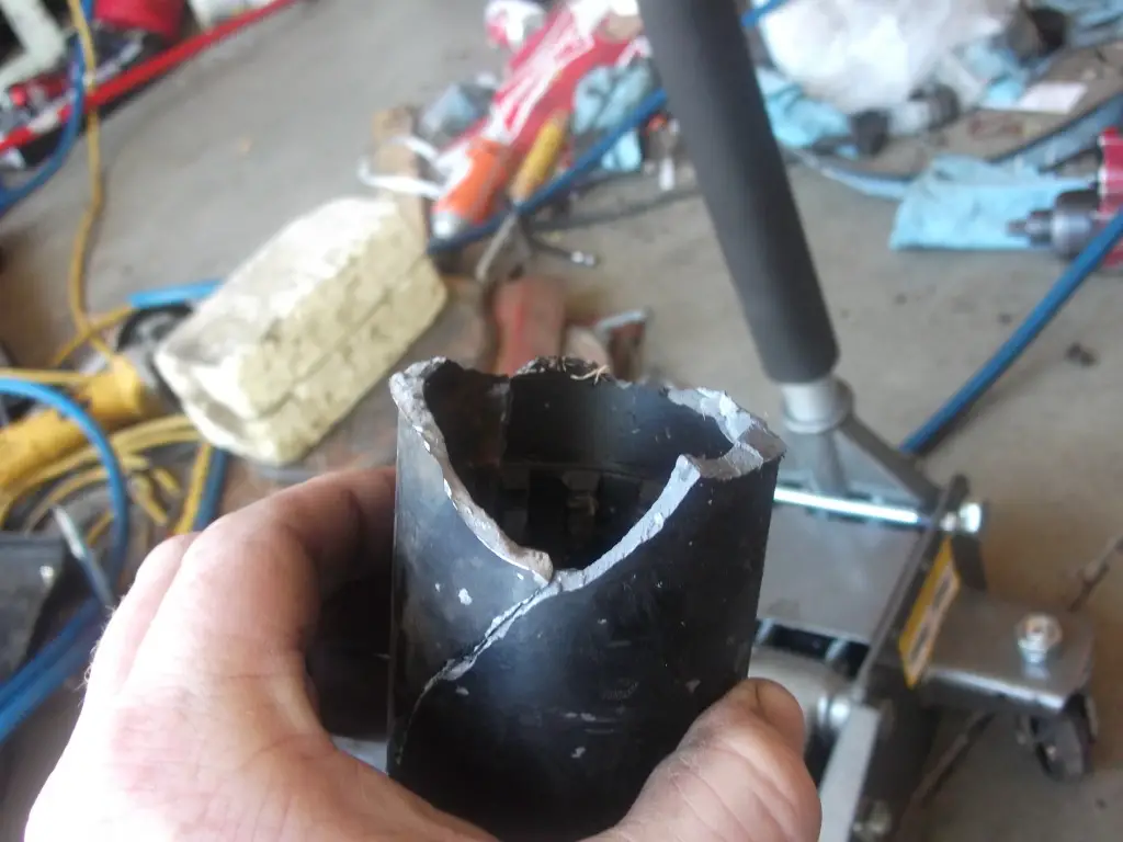

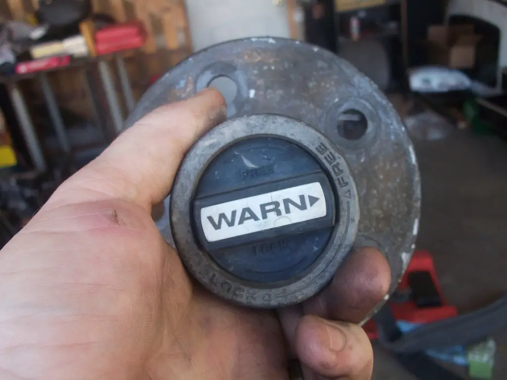

Well my passenger side mile marker hub blew out today!!!! WTF not sure why but I don't think its a coincidence that its the same one that was getting hot! Put it in 4 Lo just to climb a tire or two for a small loser flex pic and it just blew out man! So the hulk will be out of commission until I figure out which route to take for new hub? Not sure if I want to get the jeep ones or not
..The heat (or noise) attributed with the auto hubs is due to the wear on the cams and wear on the innards as hey are trying to continually engage..
..Go to the junkyard and grab yourself a pair of stock manuals (or possibly new) and the hardware for cheap..They are made by Warn and are the same ones selling for over $200 bucks a pair except they don't have the warranty..
..They should hold you over for a while as I go years before I do something stupid with mine..:D

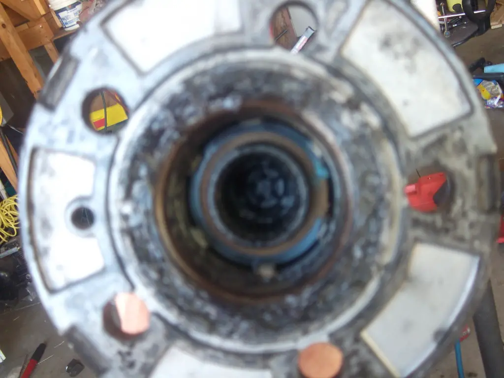

Ok I went ahead and checked out the pick and pull and found a limited with some warn hubs so i took one for 10 bucks. Replaced it and took some pictures of the old one to show what it did, since it was quite impressive in my book.
And here is a couple of the new hub
