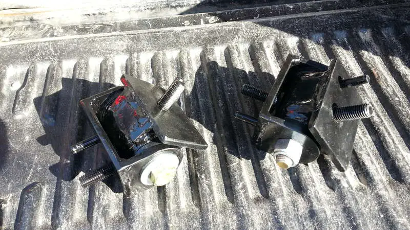

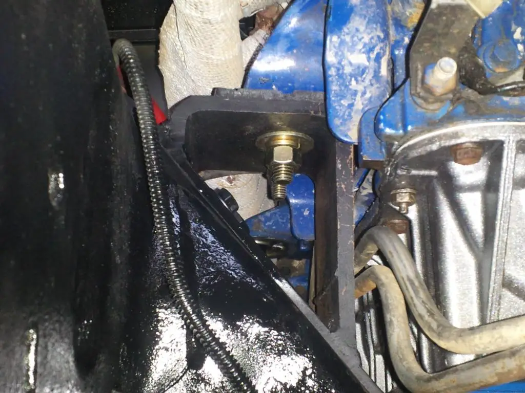

When I recently noticed too much play in my stock, 20 year old mounts, I went with OEM. Slightly modified. I cut out the rivet and put a grade 8 bolt through the rivet hole. Tightened it up until the rubber was compressed slightly. They have been working fine, and took nearly all of the play out of the engine / transmission. I did not come up with this, it has been done quite a bit on the rangerstation.com, and Kirby from this forum gave me the idea. You need a bolt with a flush reduced head so it doesn't interfere with the mount sitting flush on the engine cross member.
Got the mounts through rockauto.com for about $30 shipped. It should hold me until brian1 releases his mounts for sale.

No thread yet. I want to have my prototypes tested for a bit before I start selling them. They use polyurethane bushings.
3/8" taller can be done through the use of a spacer block. My fixtures I use to make them are only made to the stock size and making the actual mount 3/8" taller would require building another set of fixtures which I don't want to do for only 1 set. I could however use longer bolts and dowels then just weld on a 3/8" top plate (in addition) to make what you need. Not as eloquent of a solution but it would achieve the same end result.
Yea I can do the plate if the bolts were long enough, that way I can make the plate to the clearance needed..
Keep me in mind after testing is done.I would be interested in a set if priced right.o and if you think they will stand up to my motor, should be well over 500hp at block:eek:
