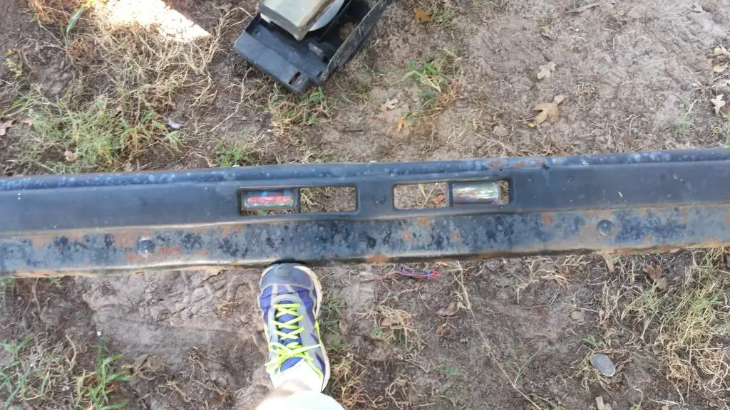

ugly front bumper, so I installed my 94 limited bumper and grille from my other truck.
It had some running boards on it, that I didn't care for so I removed them.
Running board on:
Running board off:

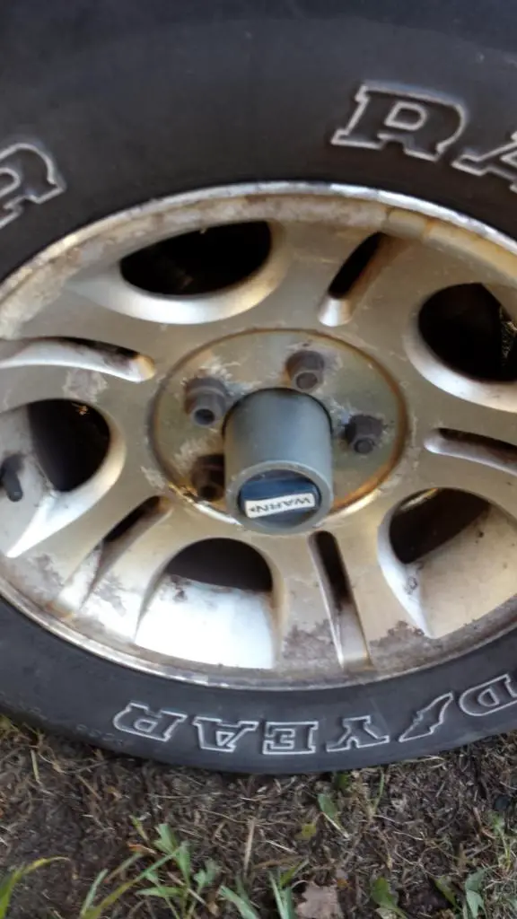

Hubs:

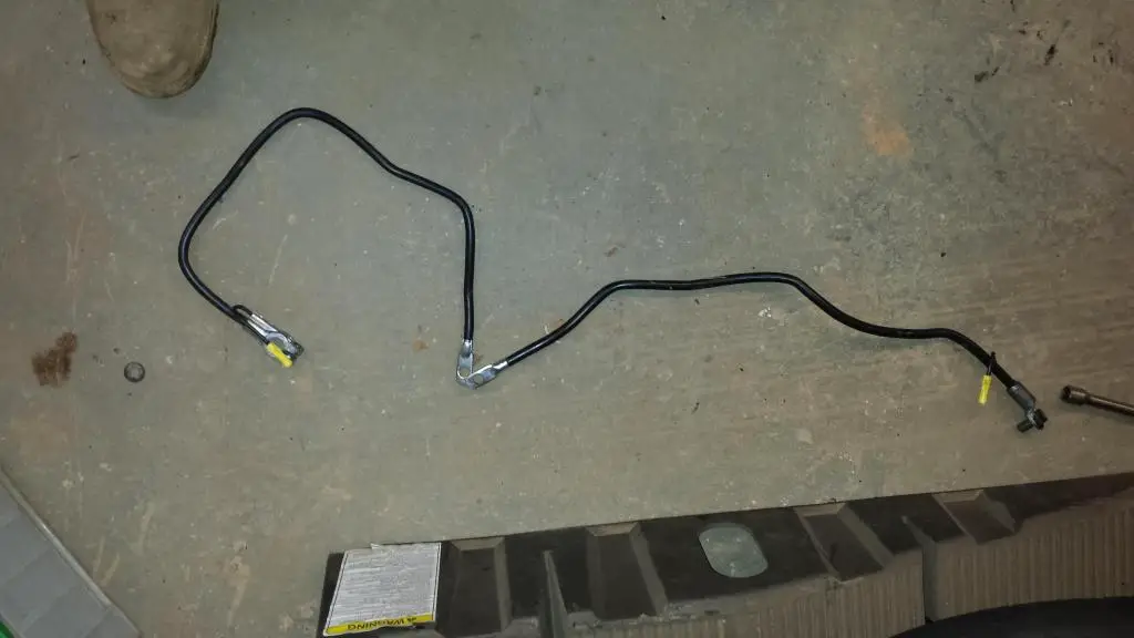

A small update, I replaced the battery cables on 12-15.
I already had the positive cable in possession from my old 92. The positive cable was cracked causing intermittent starting issues.
I decided to go ahead and replace the negative cable, which is now two separate cables, due to age and corrosion.
I did come up with an idea that worked very well for the negative cable, it cost a whopping 17 dollars.
Cracked positive cable.
new negative cable(s)
part numbers used
I highly recommend snipping off the little lead for the cable going to the block, otherwise it will get pinched in the oil filter.
