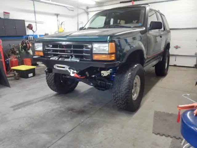

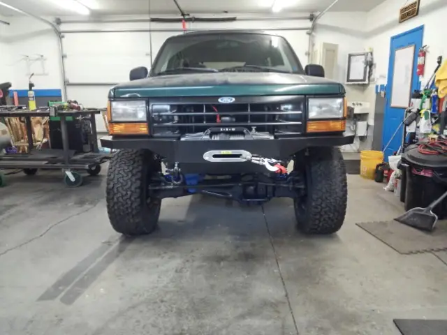

Winch couldn't have for any better Everything looks so clean and tight, I'm having doubts about adding an upper tube.
perfect!!

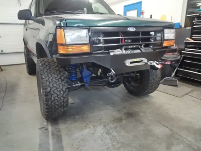

are those cough cough auto hubs????
perfect!!
Haha, ya those are still auto hubs on there. They're only staying until the D44 knuckles go on, which should be shortly after our Thanksgiving snow run.

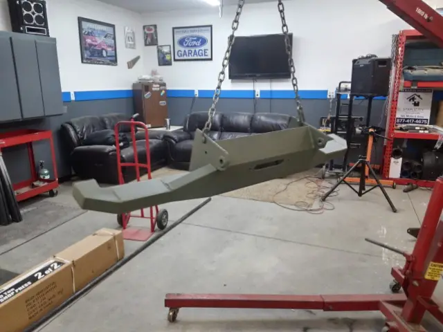

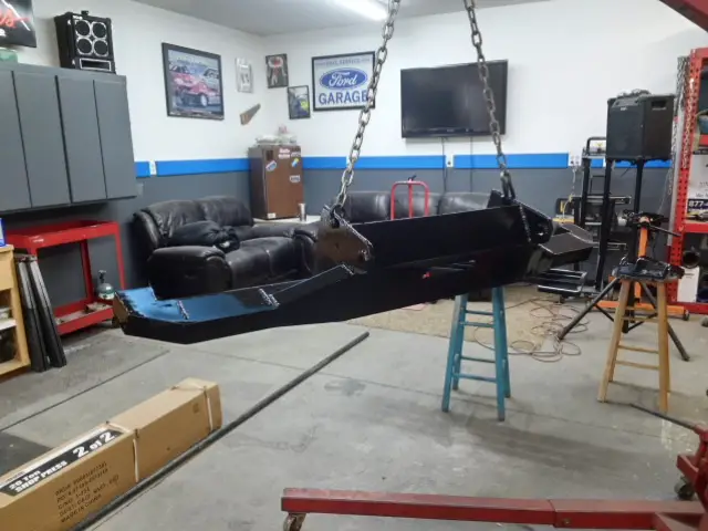

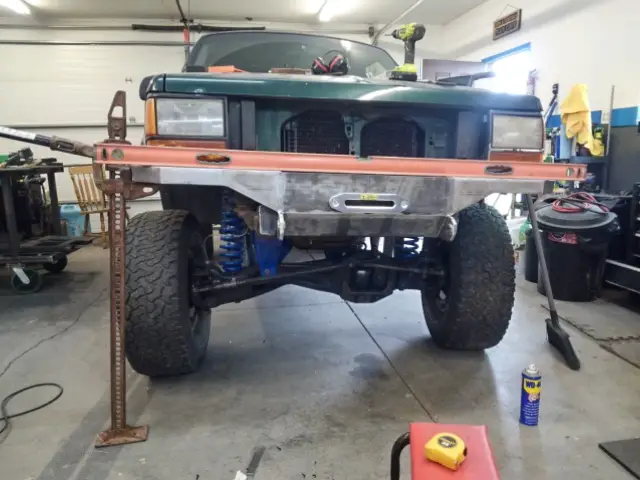

Did a little bend test to verify that I don't need the top bar to support the outer wings of the bumper. Got zero deflection. I'm good with that!
Self etching primer
4 coats of Rust-Oleum Satin

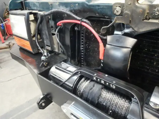

Finalized relocating the solenoid box to the core support and extending the wires for the controller plug. Ran the main wires through a grommet in the core support to go to the battery.
very very very nice!!
I wish I had a lounge area in the shop......it has always been one of the goals but so far the space reserved for couches always gets used up by more parts!!!!
