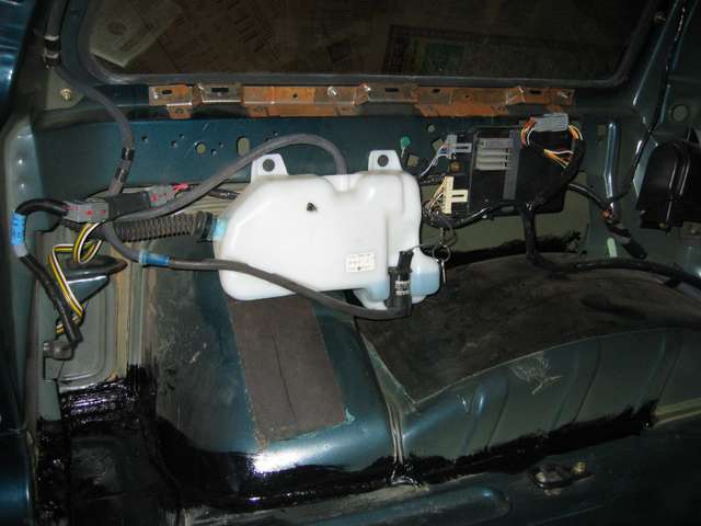

Also, this 4X4 computer I saw mentioned...where exactly is it? Should it be in the back behind the plastic cover where the tire iron is stored?? If so...I think I have a really funny explanation as to why my 4WD isn't working....
The Shift Motor is attached to the backside of the Transfer Case. The 4x4 module is connected in the trunck area where the tire iron is stored.
The 4x4 controller is the box to the right of the washer fluid reservoir.

The stock amp is located on the right side of the vehicle as seen in the picture below. I assume any 1st Gen controller would work, but I'm not 100% positive.

The switch in the dash does NOT send power directly to the shift motor. It sends a signal to the 4x4 controller (pictured in post #30). The controller will only energize the circuit if the geared selector indicates it is in a known location (2H - 4H - 4L). Follow the shift motor link in my sig line and search for "Shift motor" and you'll get a ton of info... The Explorer maintenance site contained a lot of great info, but it is currently offline.

Hi DeRocha, Thanx for the welcome & info! I printed the pix (#30) the other day, which proved to be extremely helpful because we didn't know what that box was?? So, thanx also goes to the guy who thought it was his Amp! (No disrespect intended!) I went to the "Shift Motor" thread you sent and printed it out for my Husband & our Mechanic and will be sure to pass it along as a guigeline for them! Again, thanx for all your help & knowledge! A BIG THANX also goes to EVERYONE for sharing their problems, experiences, solutions & input....It truly is a Godsend for some of us!! Hope everyone has a MERRY CHRISTMAS & HAPPY & SAFE NEW YEAR!! :)
