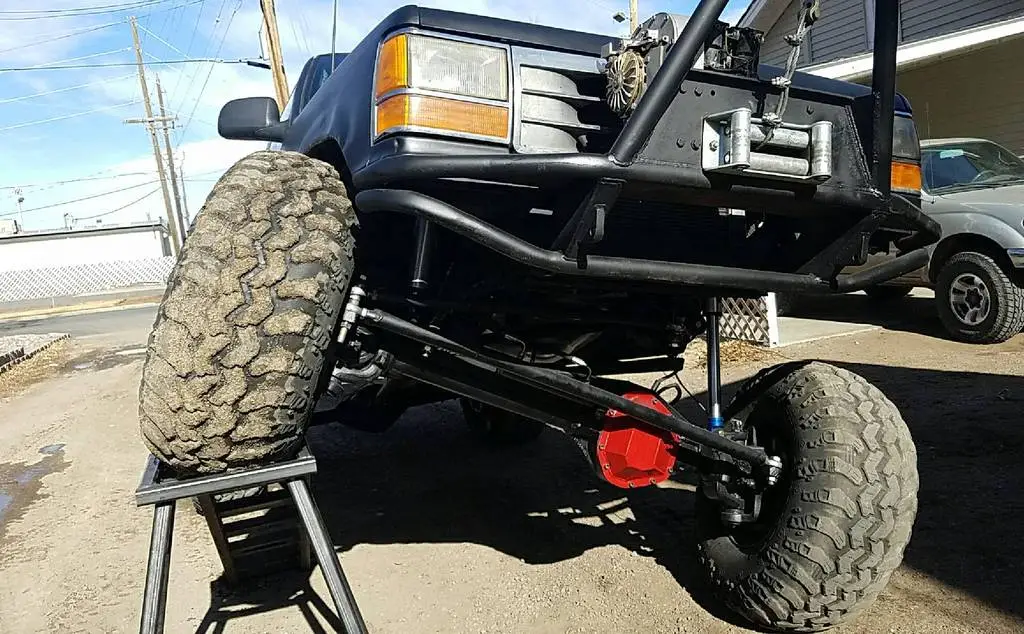

I've been done with my SAS for a little over a year and could'nt be more happy with the results. Here is a condenced list of mods.
HP d44
OX locker
5.38 gears
early bronco coils from Wild Horses
12" stroke Fox Shocks
DOM tie rod and drag link
3 link with johnny joints
home made bead locks
d60 rear
Detroit locker
5.38 gears
mix of x and bronco leafs
11" stroke Fox Shocks

Stretching her legs with the 14" fox air shocks and looking good with the flat black paint job!

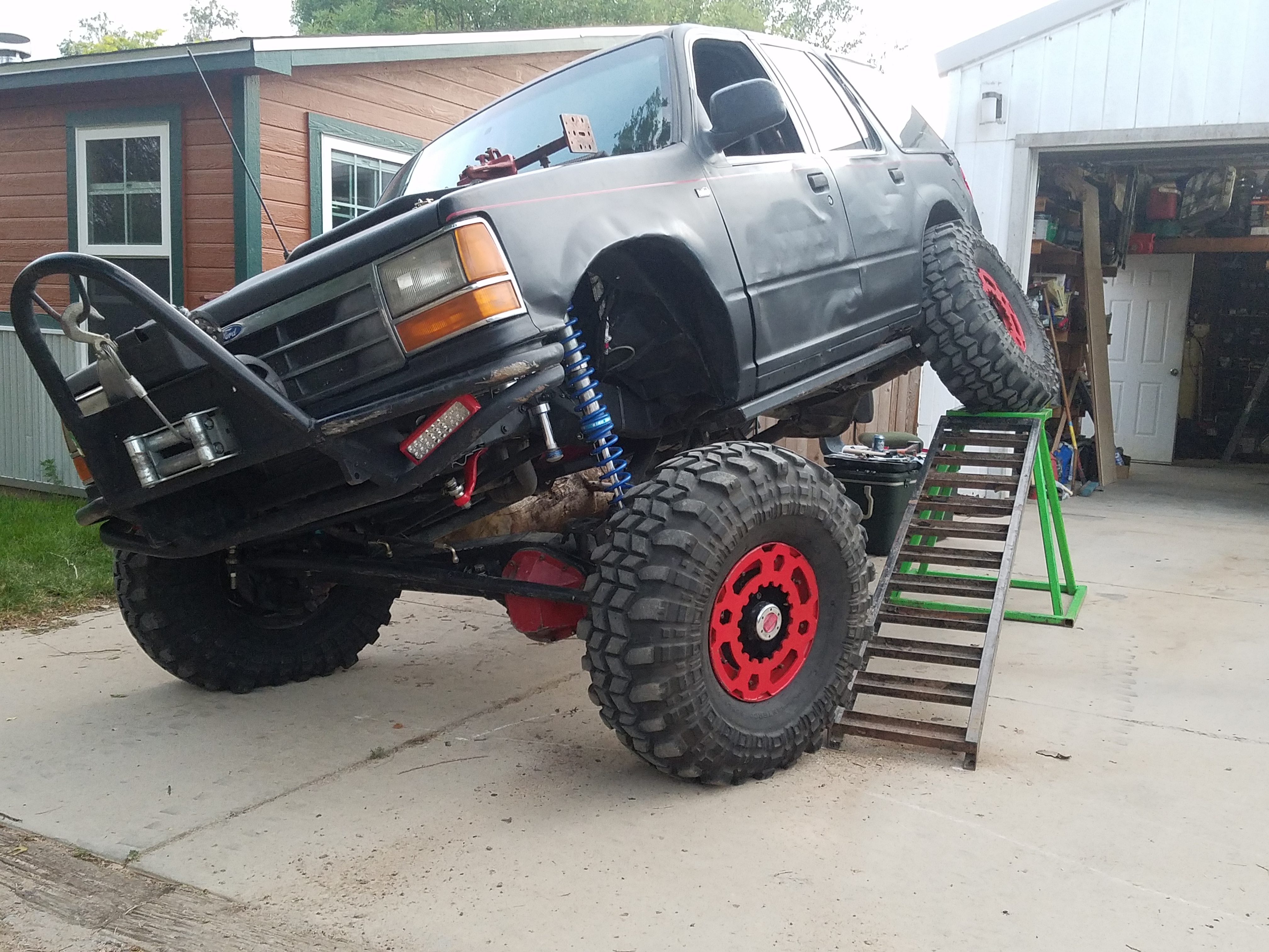

Here's an update on how she sits now.
302
NP435
203-205 triple stick
3 link front
14" kings w/remote res
4" hydro bumps
38.5" tires
H1 bead locks recentered w/rock rings
Stock box tapped for hydro assist
Steering pump drilled out to 5/32"
Basturd pack rear leaves
Plans for the rear
14 bolt shaved
Kings
Hydro bumps
Double triangulated 4 link
Lincoln locked

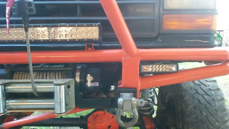

First time noticing your little fog lights in the bumper... I just finished making some brackets for mine. Too much alike:D:bow:
