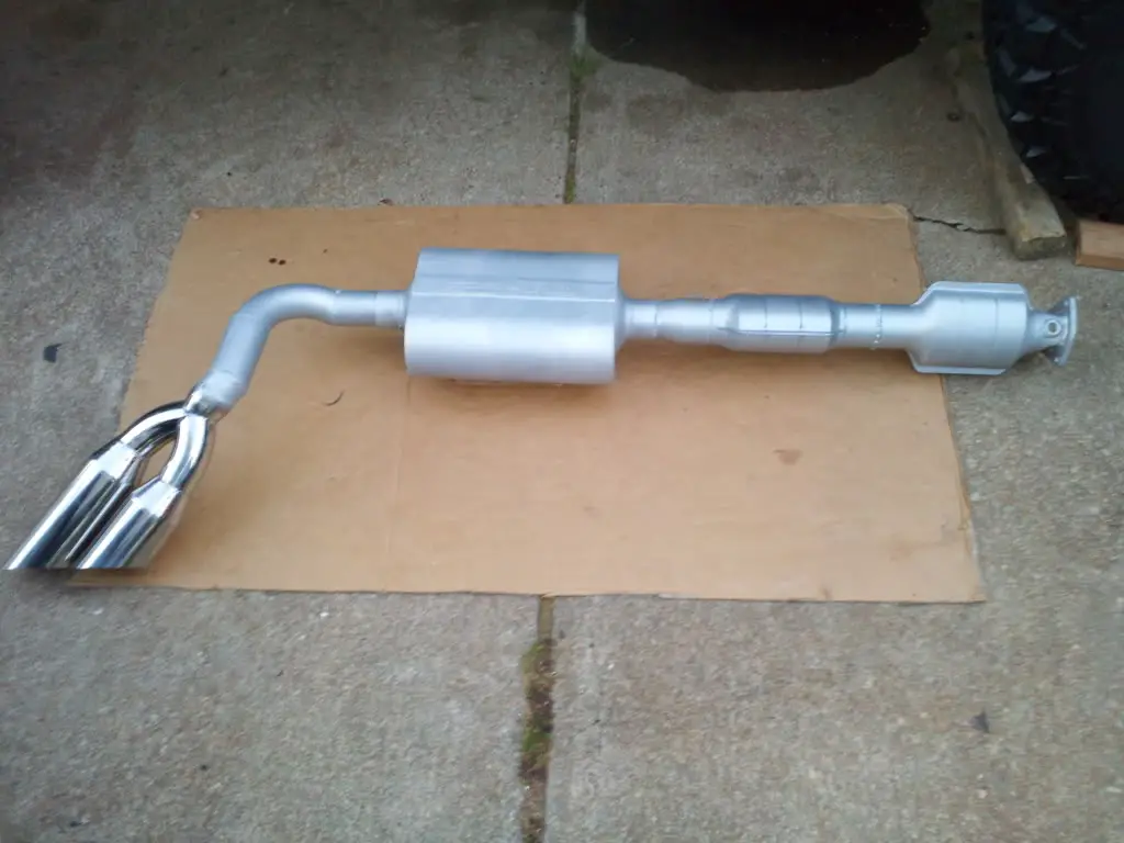

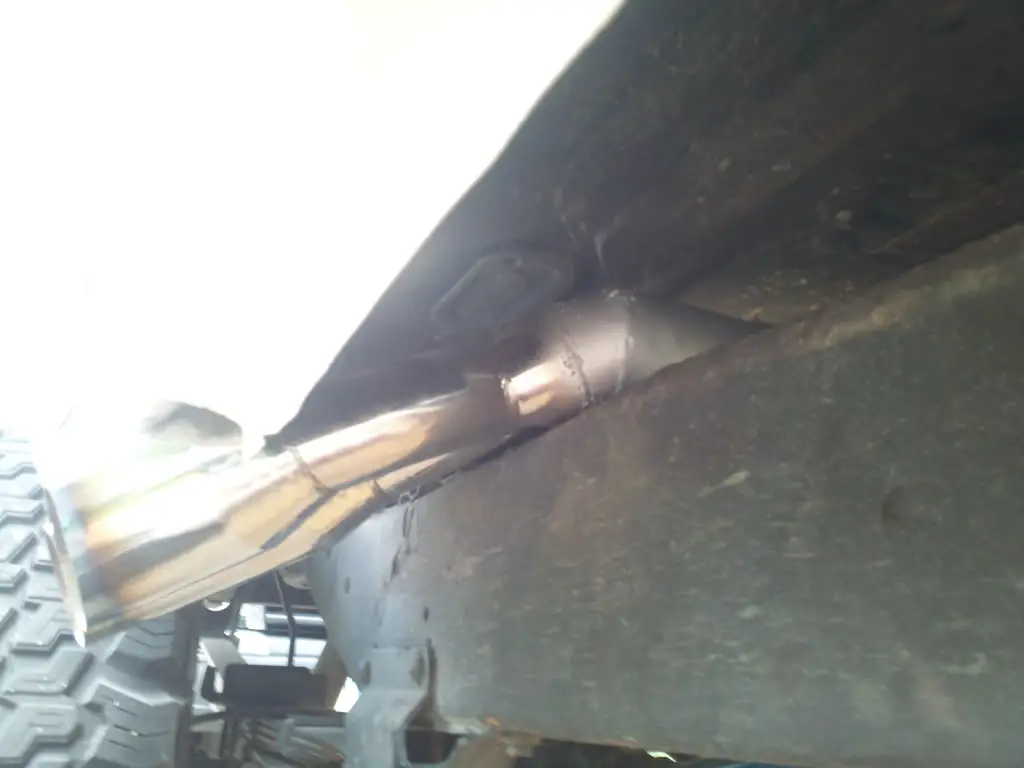

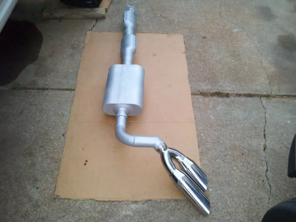

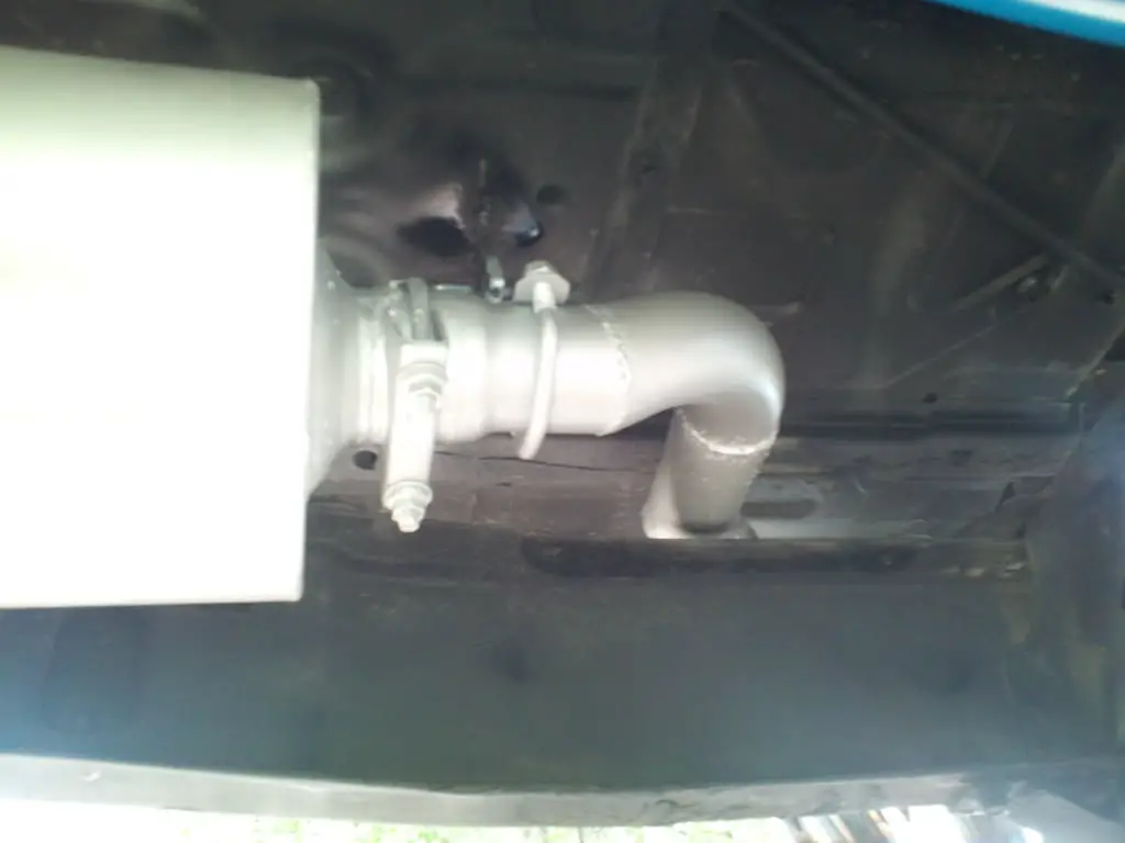

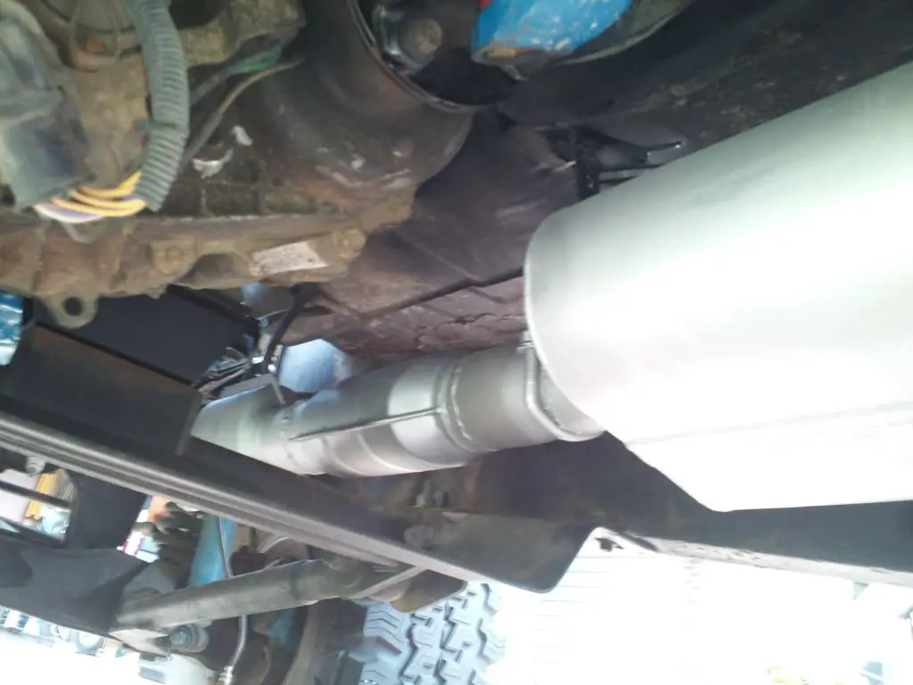

anything is possible with a welder.mine is ran above the frame and trimmed the rocker.i have a 3" body lift and no running boards.you would need a offset or two 45* and a 90*.you need to kick it down to clear the frame.its going to hang real low tho.i would suggest just a dump it(90* down) right in front the axle.if you have inspections in your state i suggest you run it out the back because anywhere else wont pass.here some pics of mine,keep in mind mine is for "OFF ROAD USE ONLY" and my motor and trans is solid mounted;)
