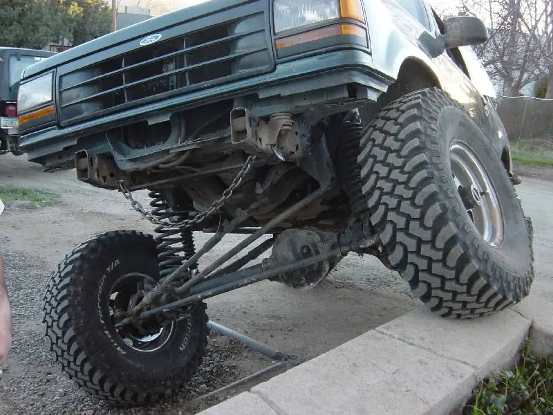

Front Axle
78 Bronco Dana 44 High Pinion
Warn Hubs
4.88:1 Gearing
Lock Right
Custom wristed and extended Radius Arms
Custom Track Bar mount
Wild horses EB 5.5 inch Lift Progressive coils
Pro Comp MX6 Adjustable Shocks
Bronc Spring buckets
7.5 degree C bushings

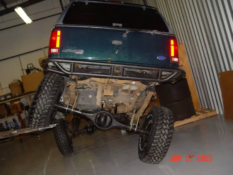

Rear Axle
Ford 9 Inch
4.88:1 Gearing
Detroit EZ Locker
Sprung over with heavy duty perches
3.5 inch Blocks

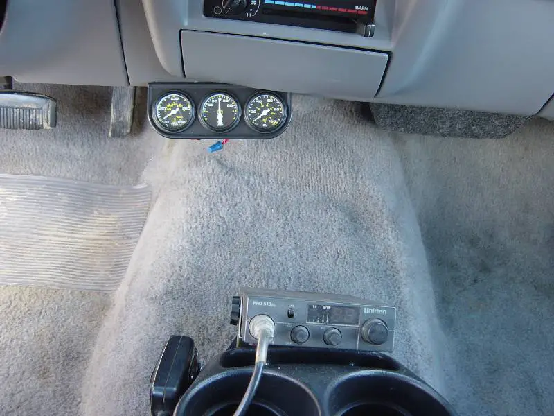

Uniden CB
Ammeter/Oil Pressure/Water temp combo

Custom Rear Tube Bumper

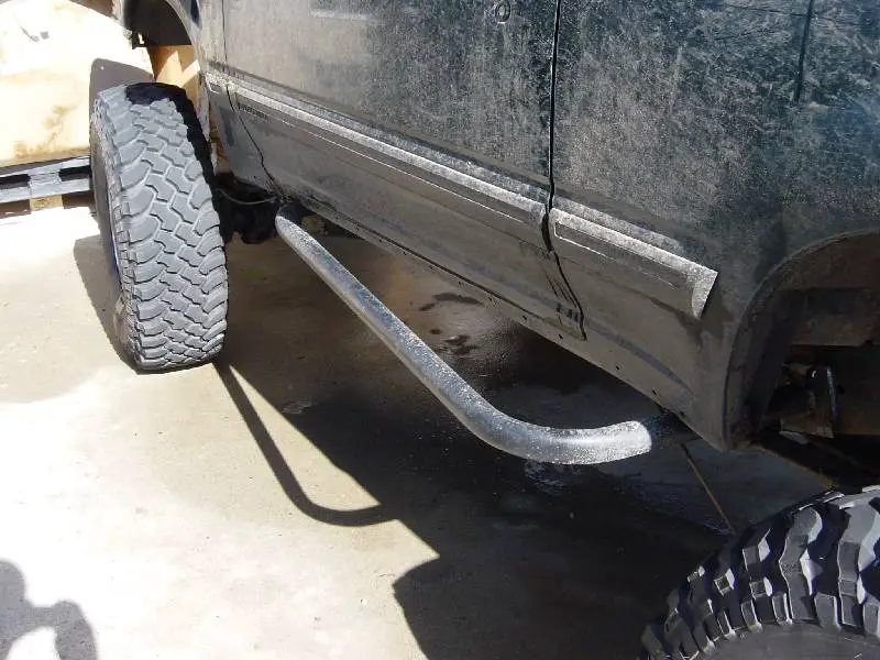

Custom Nerf Bars

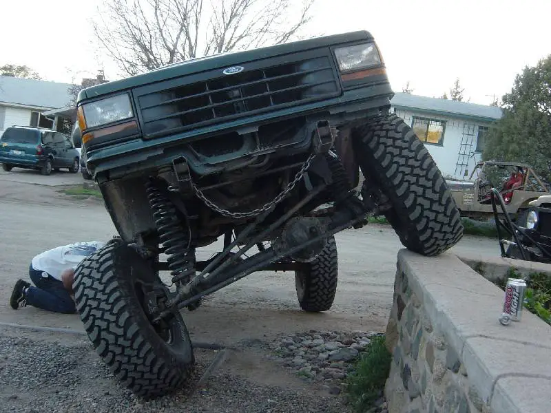

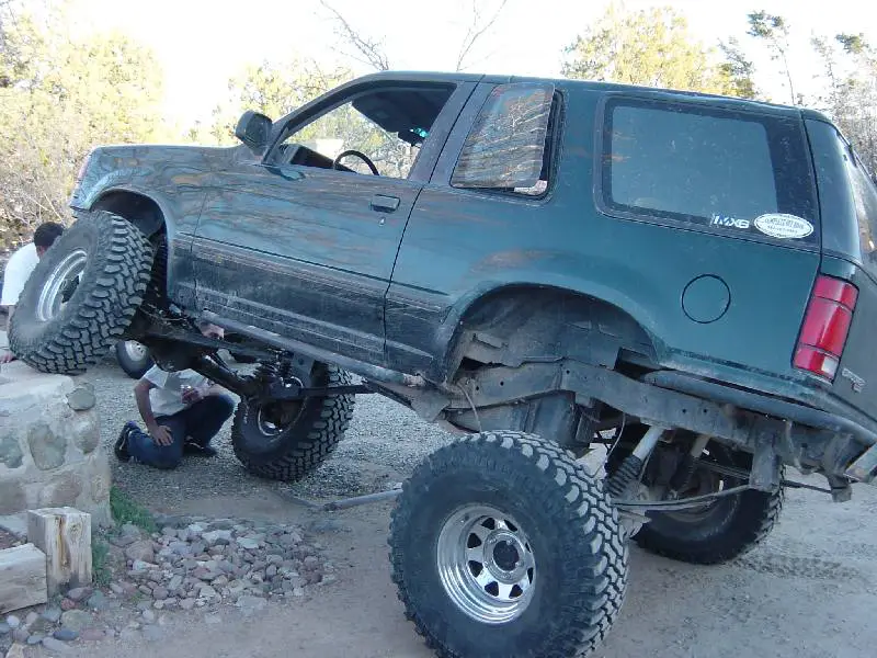

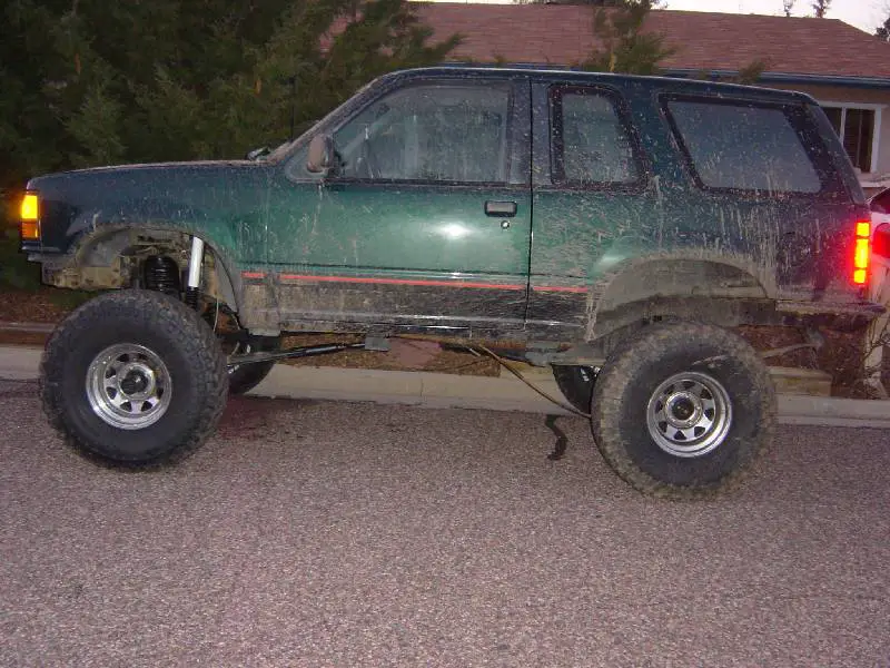

I've taken it out a buch of times and the thing does great, I'll get some action shots up soon.
The First pic is the finished Product w/o the Driverside Nerf

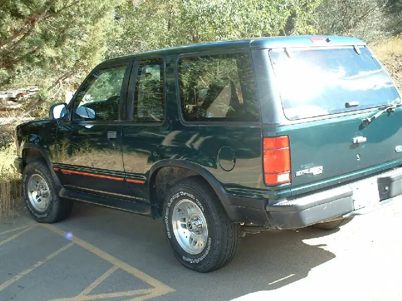

The 2nd is stock
The 3rd is the animal in action.
