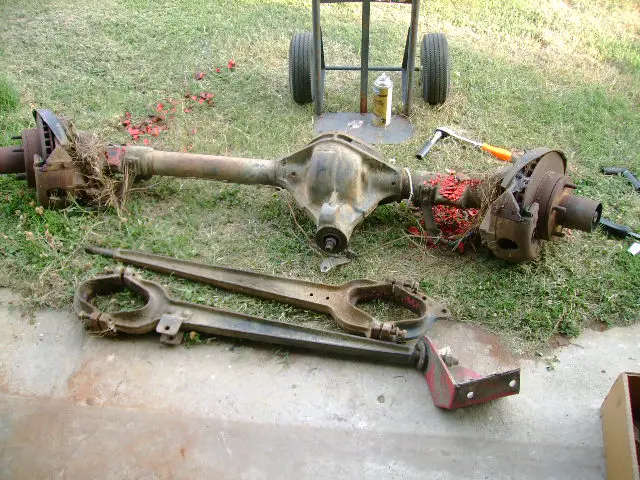

Ok the plan is to go to d44/ 9 inch. This will give me a base to work from for further mods including 3/4 ton front hubs and breaks and a full floating 9". Eventualy the 609/ true Hi9 front I'm daydreaming of. But we must walk befor flight.
So here is the plan. Since I have the d44 and it is a 79 Bronco with cast in wedges, I will be staying with radius arms (extended and thinking of using Johnny Joints rather than hymes). 5.5 wild horses rock crawler springs. 1 ton chevy tre's. Posibly hydro assist. Of corse 4.56 gears and depending on what is in this 9" I'm suposed to look at, choice of locker to come.
I will pull the 35 this weekend and get started .
Here are some pics.

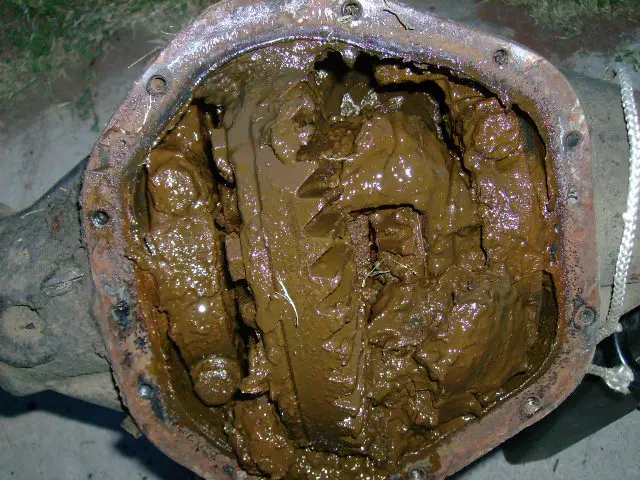

That front diff is looking great, you going to reuse that gear oil?
