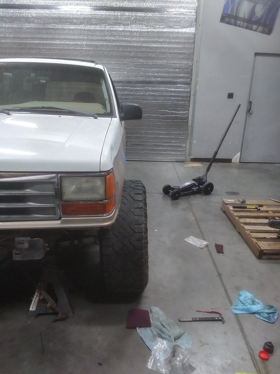

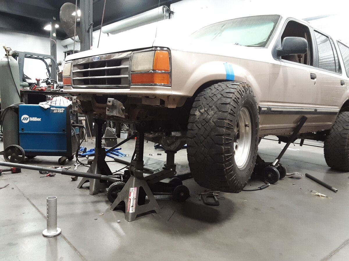

Copy Cat D44 conversion brackets
Dana 44 TTB completely plated uniball pivots

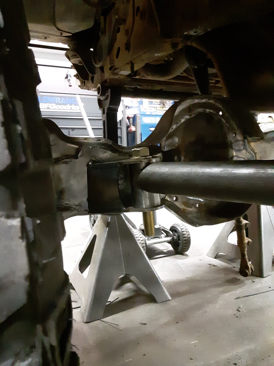

High clearance radius arms attached to the back of the beams, heim pivots
F150 leafs
Disk 8.8 with 5x5.5 conversion adapters
12" 3.0 IBP Fox coilovers in the front
12" 3.0 Raptor IBP rears

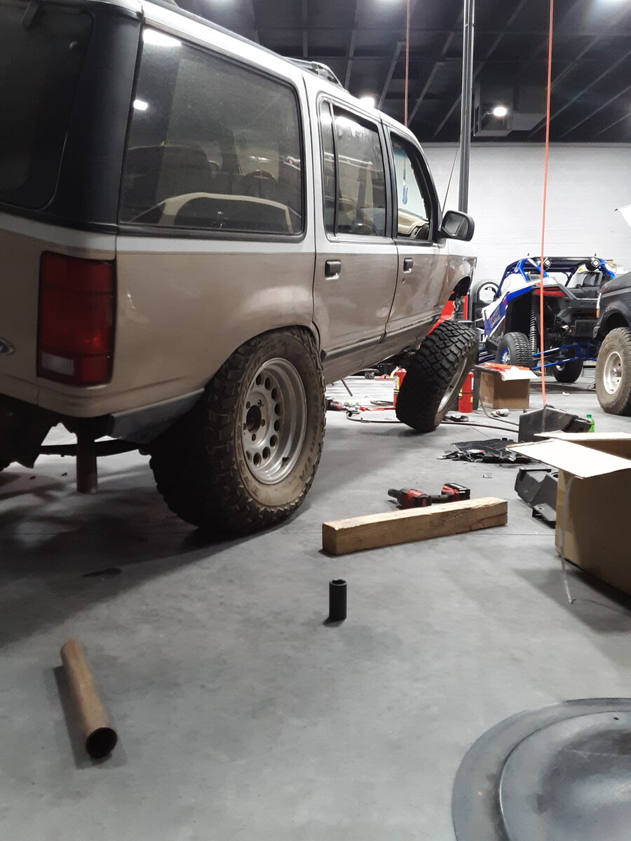

Rear axle mocked up, to be swapped for a 9"
Radius arms tacked up
Pivot brackets finished welded

She should be bad! Front fenders need a lot of trim. Don't plan on running glass. Frame needs to be notched for the diff. Tire hits fender as beam hits frame
Rear is an f150 8.8 and full 91 f150 leaf packs minus overload.
