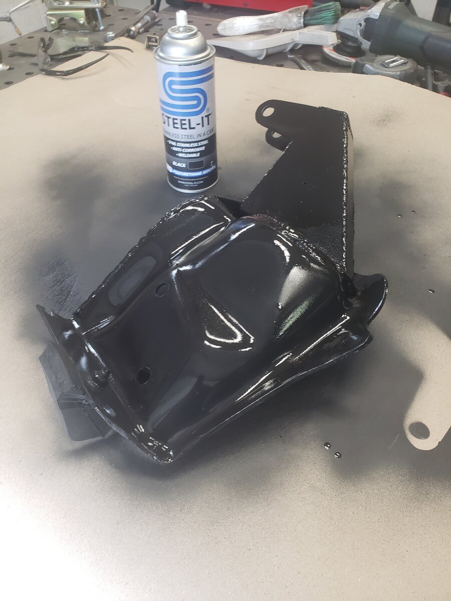

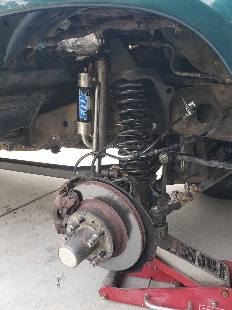

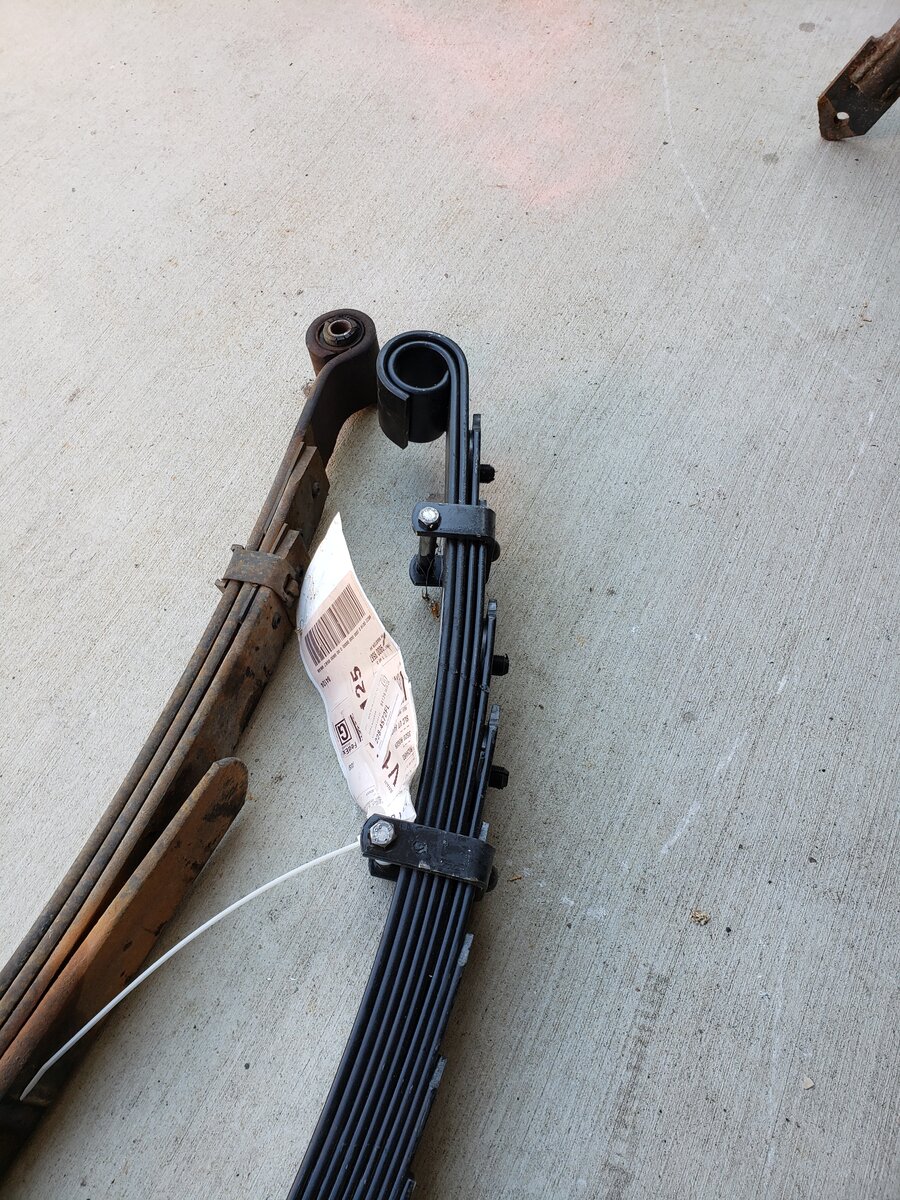

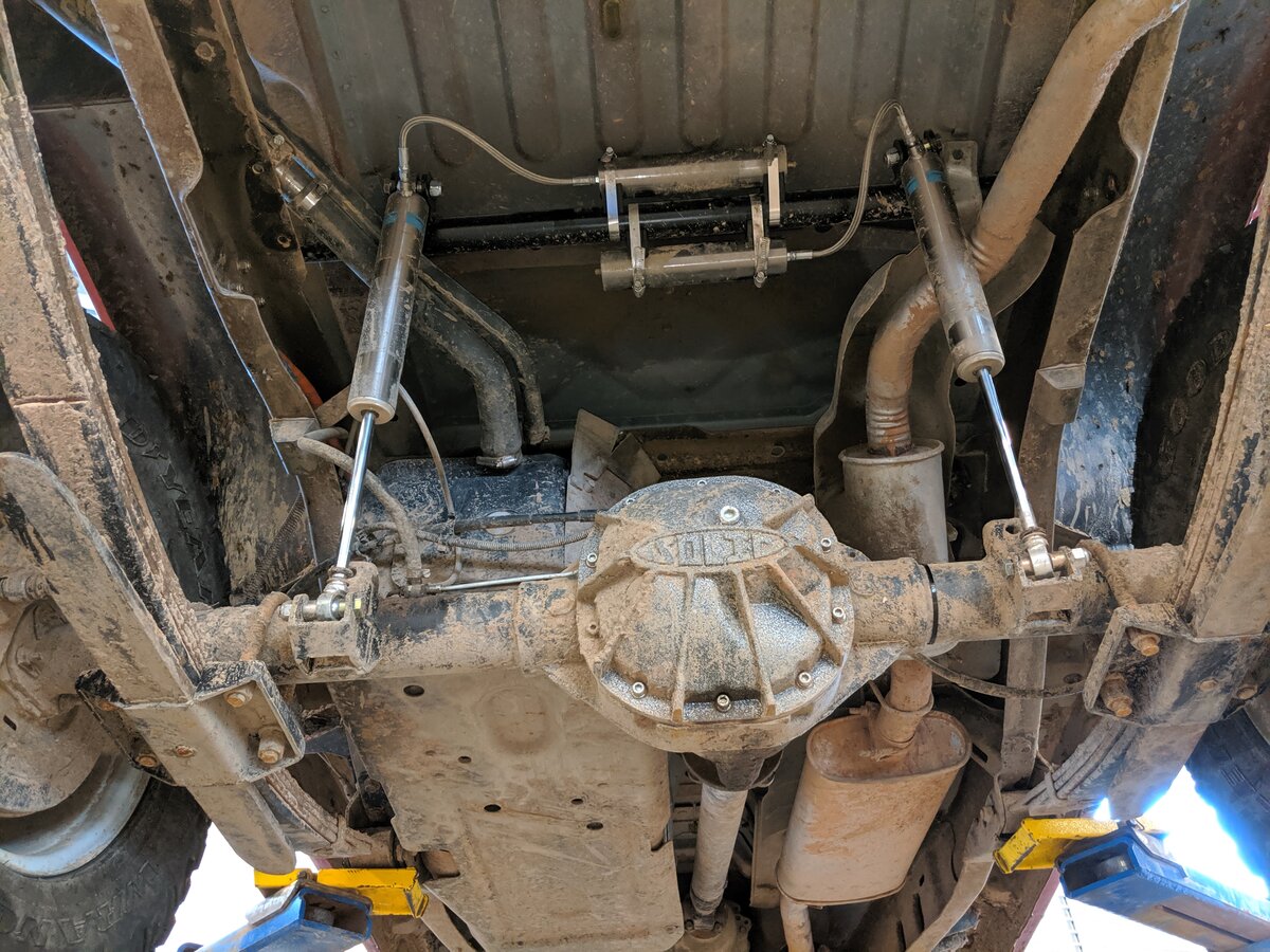

Thought I would post some pics as I work on my 94 explorer 4x4. I bought it about a year ago with the intention of using it for Exploring off road around Utah. I drove it for a year with no mods except 31x10.50 x15's. It was obvious the suspension needed help so I started ordering parts. I got some deaver P62 leafs for the rear and some Deaver 2 inch lift coil springs for the front. I also picked up some parts to extend the radius arms. Shocks for the front are fox 2.0x10 2 tube bypasses that I had. Rears are Fox 2.0x 10's that I also had.
In the front I shortened up the coil buckets and made mounts off the top. Rear I made some bar pin eliminator and mounted the shocks in the stock position
