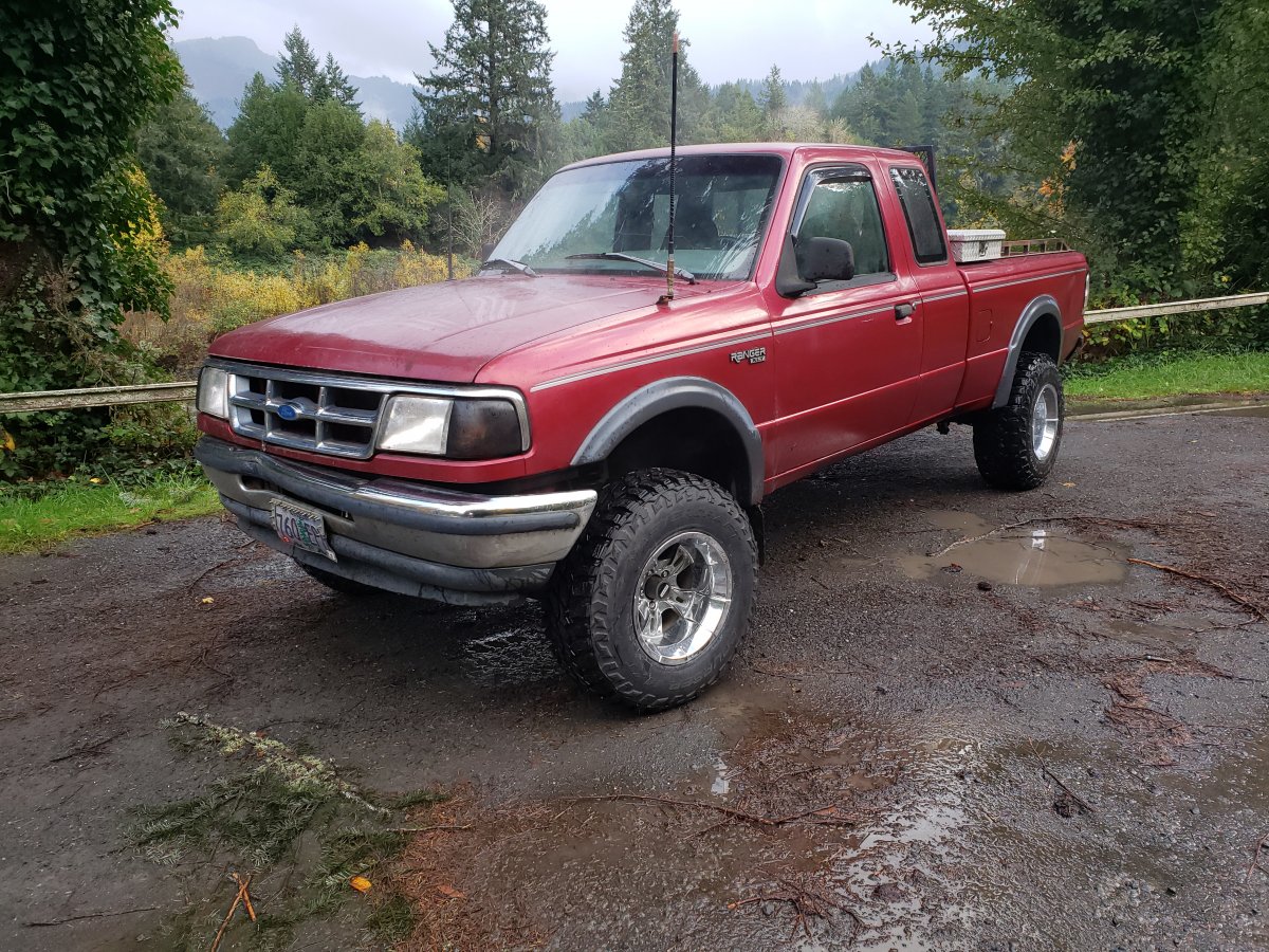

Hello everyone. This is slightly off topic and maybe dumb question to be honest. Lol
So I have 94 Ford Ranger with 3.0. It has a running issue, where your driving and get to about 3,000 RPM's. Then it starts bucking like a bronco (the horse) on steroids. Runs fine at idle or below about 2,700 rpm's.
So its stock besides:
Custom cold air intake system
Custom Exhaust after manifolds, no cat and flow master
High performance ignition control module
Msd coil
Upgraded plugs and wires
Innovation high performance chip
Stock distributor
So is it because I have stock distributor with that other stuff? Every once in awhile, it will run great. But less then half the time. I have replaced fuel filter on frame with k&n. I thought maybe clogged somewhere in fuel system. Any help is highly appreciated. Thanks
