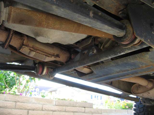

This is a wristed RA
I'll be using the same thing on mine.

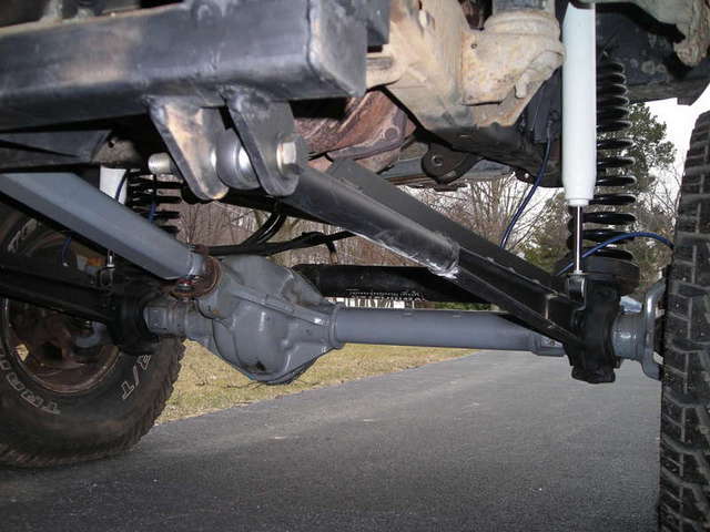

The stock bronco arms are the same length as the extended ttb lift arms. If you can find a ttb skyjacker cross member, you could use that to mount the arms, unless you are moving the axle forward. I also have the wristed arm.
Here is the Skyjacker x-member.
You can see the wristed arm here too.
