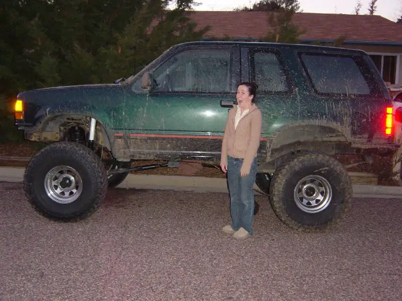

The secret is out, now that my wife has been seen driving around town in this thing.
Yes, it is hers until I buy her something new. :thumbdwn:
She wants a Toyota Sequoia-I need some cash quick :p

rino351
July 31, 2003
1,352
Golden, CO
'94 XLT
how does she get in??
that thing is huge!!!

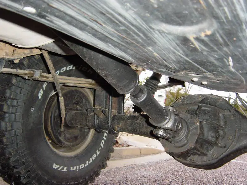

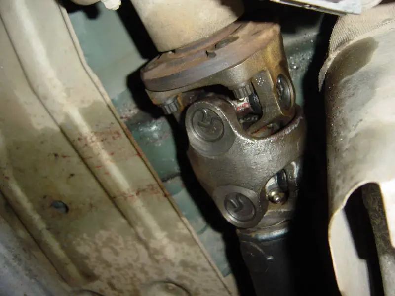

What did you have to do to modify the rear drive shaft to fit the 9", because i going to be putting a 9" in my B4000 and i'm just curious to what you had done.

Bassically, it is a whole new rear driveshaft. I got a new CV at the T case end (the stock one was in bad shape) and new u joint at the axle end. I had him put in a new, longer travel, slip joint too. It cost about 400 dollars, but I decided to do it right the first time, in the hope that I will not have problems later.
My d/s guy has a Navaho and said that if you don't put a CV in the rear you will get a major vibration with this amount of lift.

JIMBO94B4K

will the stock one work until i get a sleaved one?

No, the u-joint is different. ex's have 1310s and 9'' have 1350 usually.
