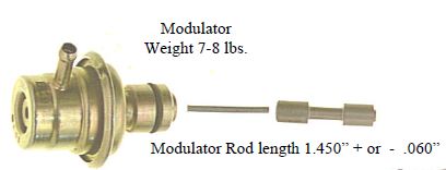

Is it possible that your mechanic forgot about, or dropped, the small metal rod that the modulator hits? If this rod is not reinstalled, you can have a lot of trouble shifting. It is easy to misplace it when you pull the old modulator out.

So, after looking at where the modulator was I opted to have my mechanic do the work. Got the truck back and it has shifting problems, slow to start, high rpms before shifting, downshifts, etc.
I had none of these problems before I had him replace the modulator, it shifted perfectly, used burned a couple of qts a month but shifted just fine. Any thoughts, I am afraid to drive it much and it is all I have. The mechanic said "it shifts hard but it will smooth out" oh really? Also can someone tell me where the vacuum line from the transmission connects up top? Thanks in advance for any and all help.

I used the ATP FX-219 vacuum modulator adjustable... 1994 ford explorer .. i did 4 complete turns clockwise and she now shifts very smooth.
Smooth shifts are slipping shifts, firmer shifts slip less....
Ok here is an update,, it has been a week and the mechanic has been giving me the run around and not only is it hard on my tranny I am getting tired of the run around. Turns out there is an adjustment on the vacuum modulator! Does anyone have any idea how I go about adjusting the modulator? I am really getting desperate so get this up and going, pleease!!
