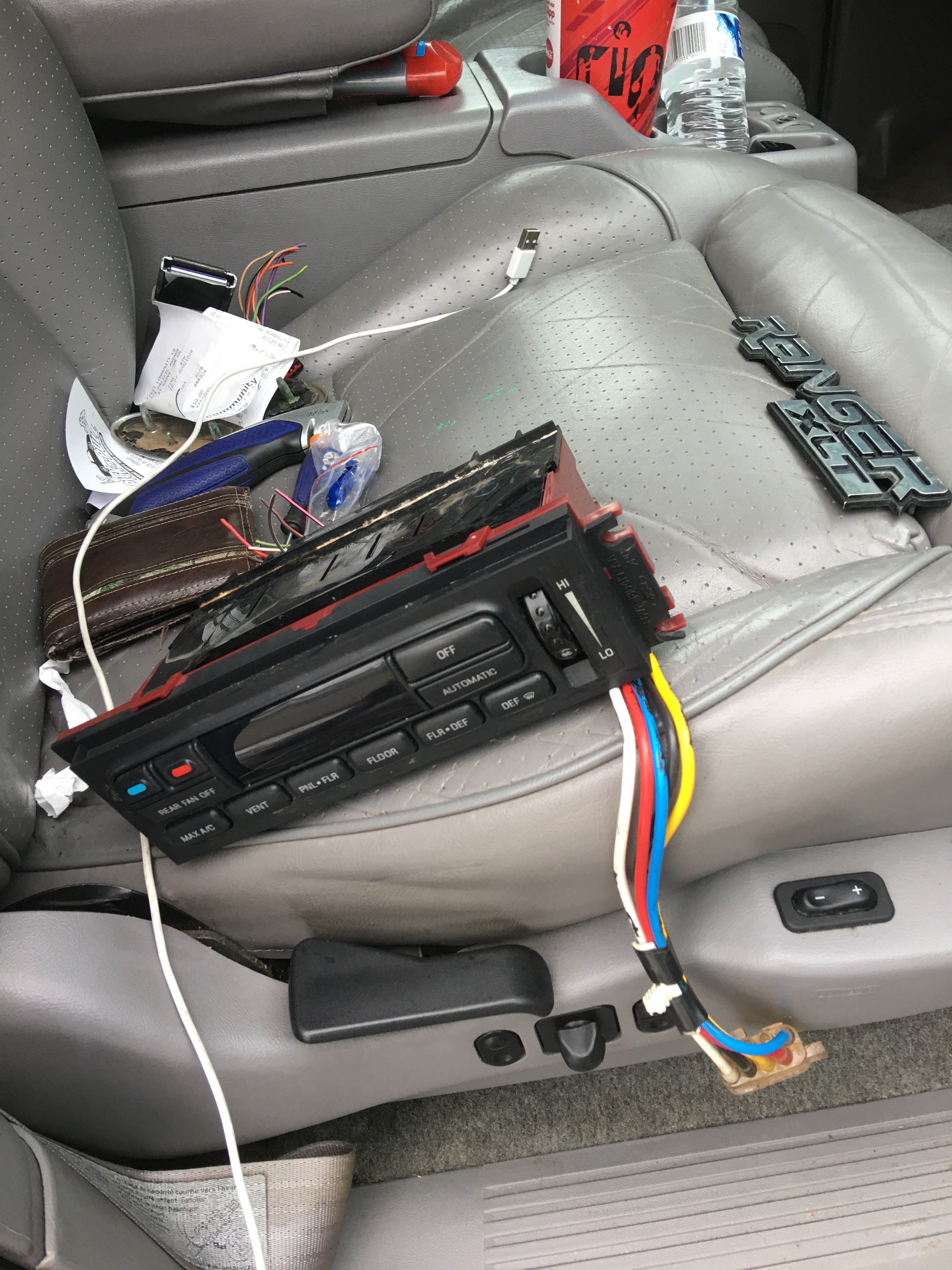

Hey, so yesterday I went to pick n pull and picked up a few things but most important picked up this
all I knew to take was the head unit and some wiring

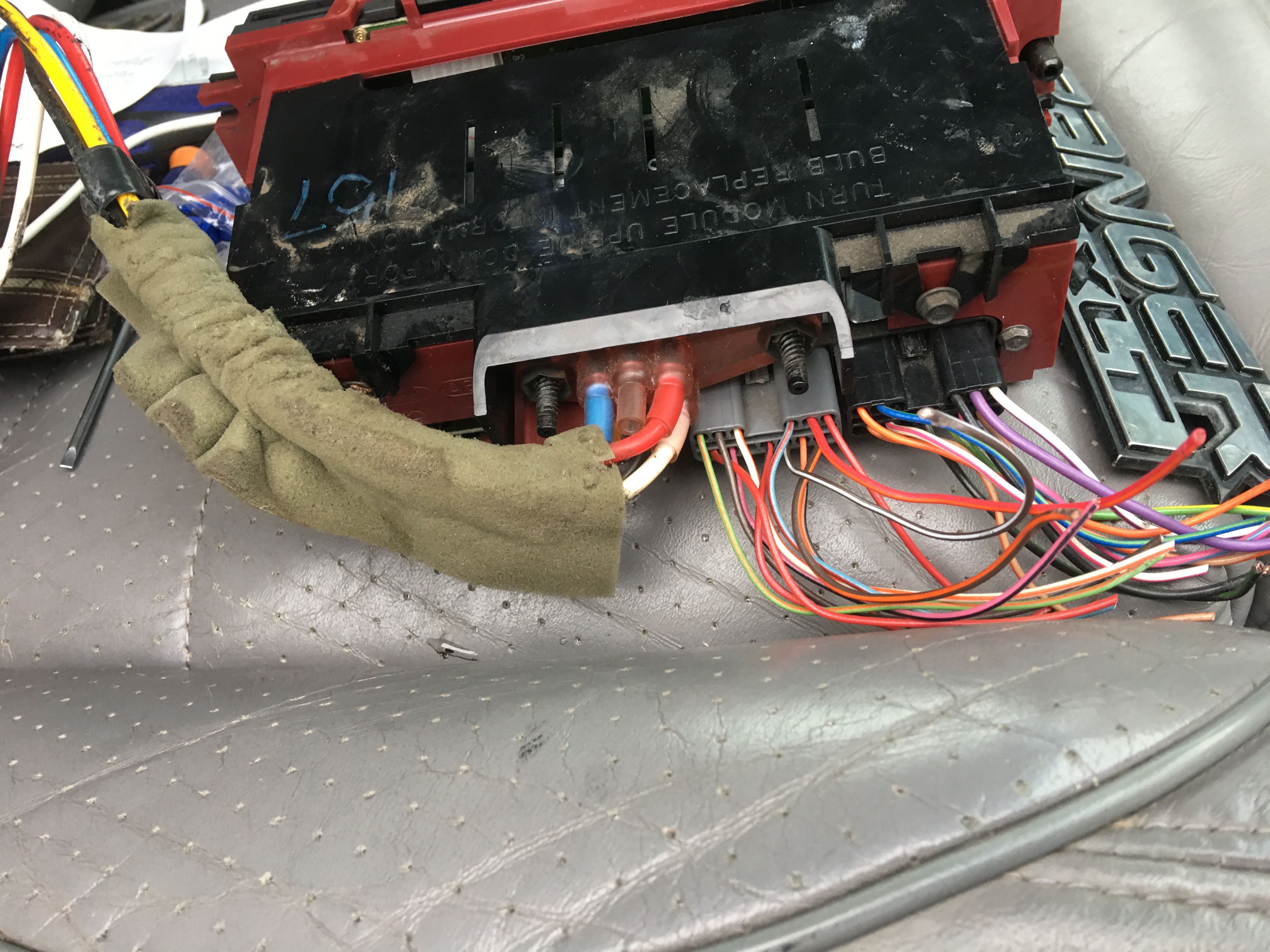

This is all I took
I cut the wires to the connectors. Was that stupid? But yea, I want to do the EATC Conversion. Is there any simple way of just getting it to work first and worrying about the automatic stuff later?

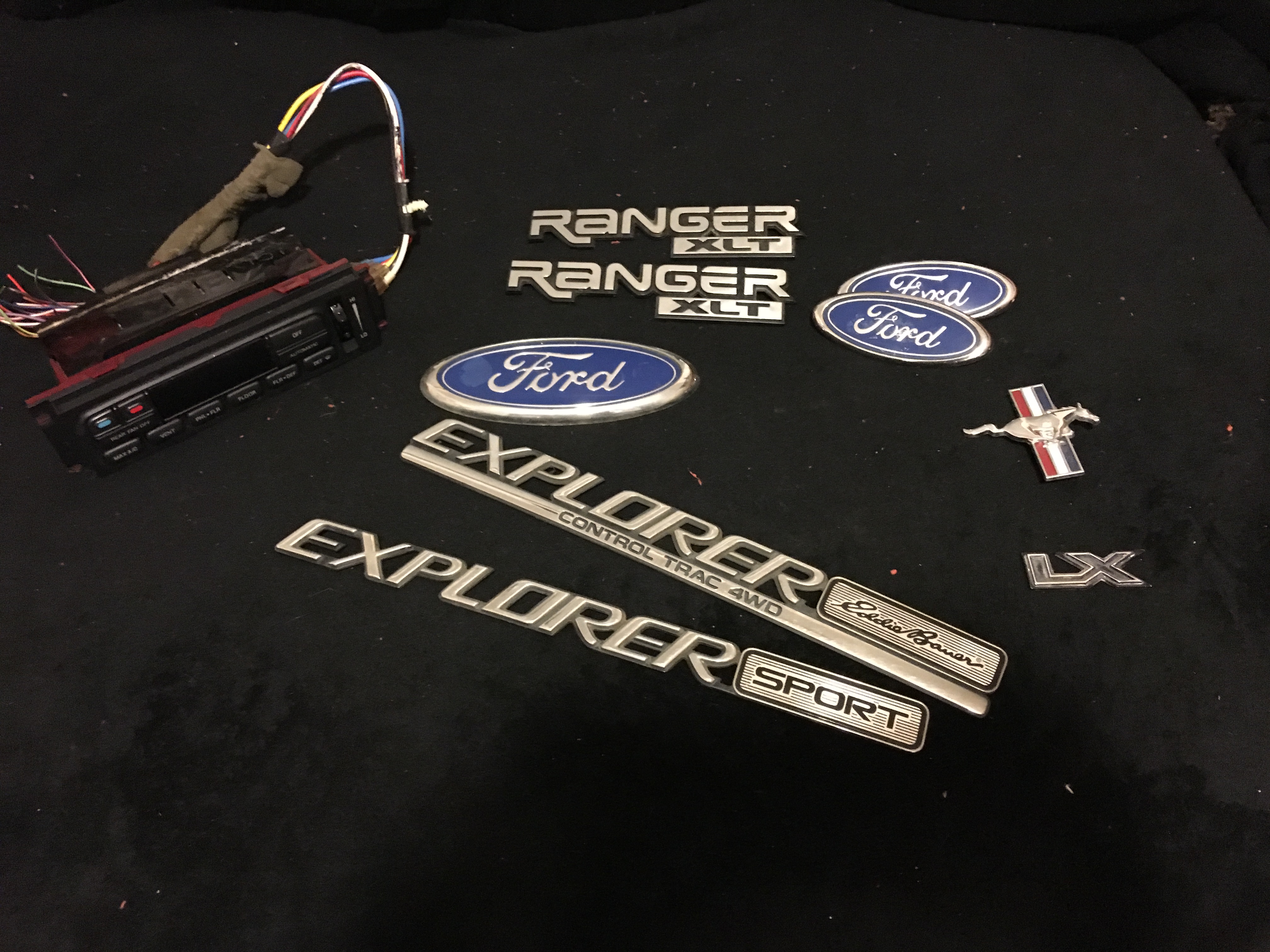

Also picked a pair of mud flaps off a sport

HAhahahahahahahahaha! My friend you just opened a can of heating/cooling head unit whoop-ass on yourself. Yes that mod has been done by a lot of people in this forum including myself. There is a lot more then meets the eye on that mod. There is a couple of members here that have wired in that unit with a stock wiring for the manual controls and was successful. Myself, I went and bought a 98 explorer limited and took the wiring harness out and put it in my 2 door sport. If you want to read up on both ways just type in EATC swap or manual to EATC swap and have fun. Or if you like I can tell you what I did to obtain the convenience of that system.

Do you know the easiest way, like you said somebody used stock wiring. I was looking the wiring yesterday and they shared the same color wires some. How much wiring do I need if I were to do it?
Yes, you can hook it to stock wiring but you will only have off, med and high. It won't work for the blend door actuator, which kind of defeats the purpose of having that control head. Yes, the control head looks way cool but more importantly you want it to be functional. There is a link here on this forum, I have read it but don't know exactly were it is at, that he did the wiring on his ranger, which was almost identical to the explorer of that year he was using. It is a long read but good if you have the time. I found it easier for me to just change the wiring harness out as I had the blend door problem in my rig, which is common in these rigs, and just decided then to do it all. I took the steering column out then the dash so I could replace my heater plenum with on from a limited along with a new doorman blend door so that the blend door problem would not happen again in my life with this rig. At that time I put the new under dash wire harness in so that everything would work and fit great. I was wrong. I needed to change out the engine bay harness as well. The under dash wiring harness on the limited and the under dash wiring harness for the sport or the XLT were identical for everything like lights, window wipers, horn, overhead compass and temperature read out, windows, locks, seats, interior lights, rap module, gem module most everything with the exception with the heating and cooling, and some of the steering wheel controls. Now you asked for the easiest way would be to find that write-up and use it put this EATC in, but the fastest way would be to get a wiring harness, both under dash and engine bay harness, and by engine bay I mean just the one that runs along the sides and front of your rig with the fuse boxes and nothing on the engine, and swap them out. That takes about 3 hours total for the engine bay part of the project. Plus you will need the blower control module on the blower box under the hood. Then to take the dash out and remove and replace the wiring harness will be about 8-10 hours taking your time. You can go faster and have it all done in 8 hours with help. It will take at least 8-10 hours to splice, solider and heat shrink your connections working in a limited space. Just make a plan as to what you want in your rig as was the suggestion of 96green and go from there. You may decide to put the air ride system in from a limited along with other goodies from the limited that the Bauer does not have. This is the point at which now would be the time to decide those options that you want and go from there. Donor rigs are most the time cheap at least in this part of the country. Remember once you have the plan for your rig all decision after that are easy.... Well mostly easy.
