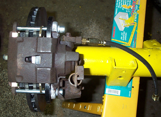

Looks like you've assembled a good list of parts. What did you use for the disc brake conversion?

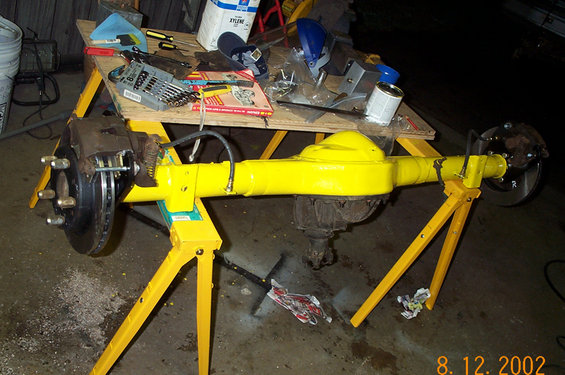

Well I cheated on the disk brake stuff, it was already on it when I got it. I sold my Aussie locked 8.8 with a diff guard for $400 and I got the 9" for $400, can't beat that deal :D
Here is my 9" It won't be yellow for long, thats how I got it.
Keep the yellow!!!!
I think that would look friggin' sweet :D
Seriously though - you're building a big, bad, full width lifted Explorer. Why not have'er stand out a little more with a yellow 9"?
hahah you should leave it yellow just to piss off j**pers.

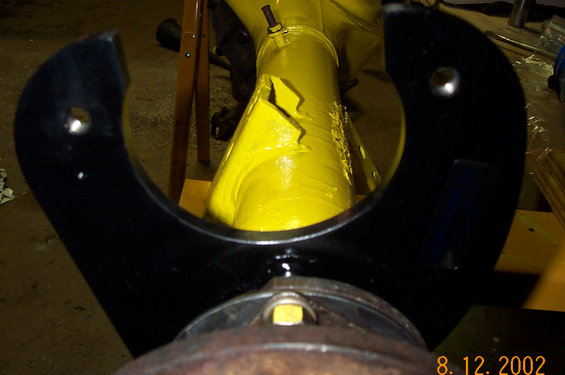

Bout a week later I got back home to do some more work on the X. I got my 9" cleaned up and welded on the new spring perches. That's where it sits right now. I got called back to work again and will be in NYC for the next 2 weeks. After I get back the rear will be finished (once its regeared) and I'll start cutting the IFS crap out around Easter.
