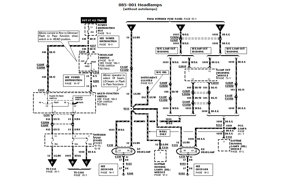

Hi All. Looking for advice on my 1996 Explorer Eddie Bauer 4x4. My driver's side low beam won't come on. Both high beams work. The bulbs are new. Shy of picking through the wiring harness, is there a common cause to check out?
