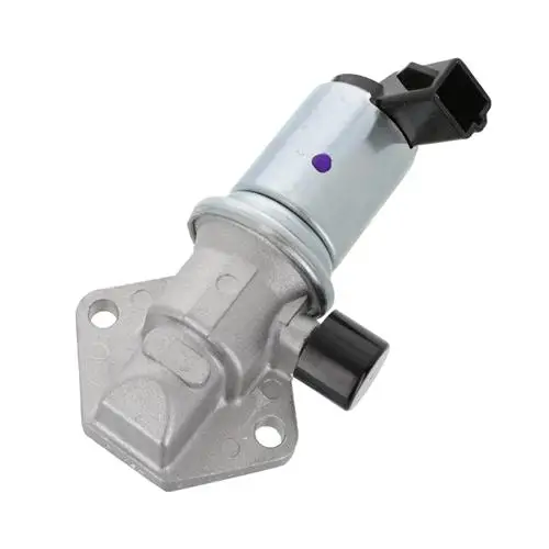

When asking for help, it's always advantageous to specify type of engine, whether any engine codes are present, prior maintenance history (aside from parts you just replaced), mileage, etc. Could be a vacuum leak, faulty IAC sensor, plugs/wires, MAF sensor, etc. But, rather than continuing to throw parts at it, first check for any codes.
If no codes show up I would next go to fuel pressure test.....sounds like possible fuel pump on it's way out.
My vote
Iac and or fuel pump
Help! My sister has a ‘96 Explorer that originally wouldn’t start, when we did get it to start the idle was very rough. Changed the air filter, cleaned the throttle body, replaced the fuel filter. The idle got better, but now when accelerating if you’re giving the truck gas and immediately let off the gas pedal, the RPM’s go down and it struggles to stay idling. It will stall if you slam on the gas and then pull off of the gas quickly. PLEASE HELP
Plugs and wires should be next.

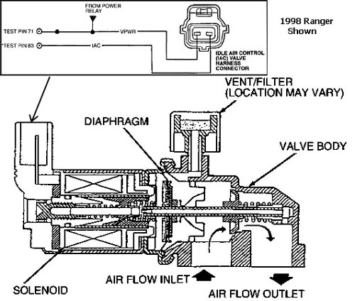

idle air control valve
Was having the same problem with my 96 Explorer XLT, replaced the idle control sensor and it cleared right up for me, may be something different with hers but the part isn't expensive so give it a try! BTW there wasn't any engine codes while it was doing this so I just guessed at it.
