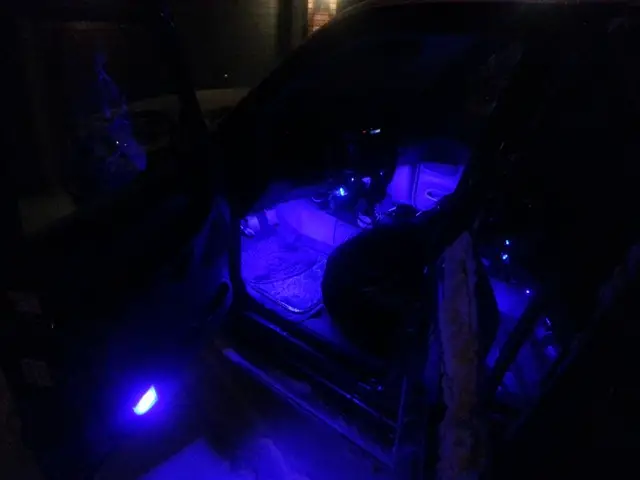

started out with some lights under the dash:

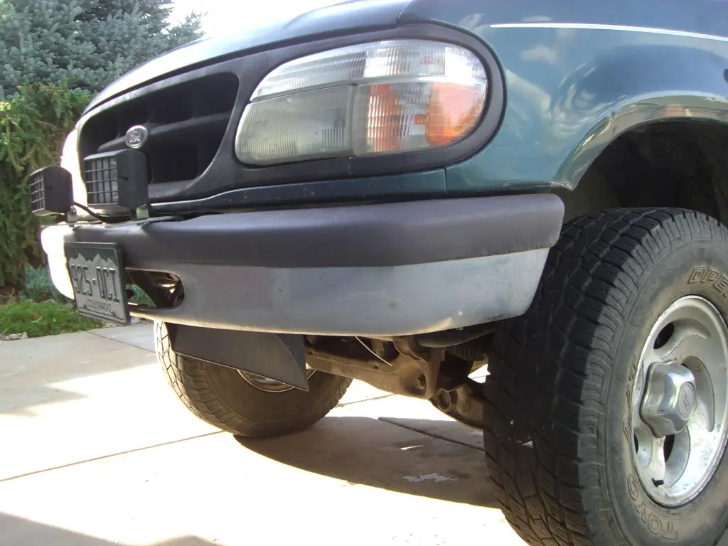

Bought the extra 22 or so inch extension off the shelf, I think that looks much better, and is way more functional too. Then I added one of these: (yes it says ice, it was a cold day).
Next it was time for a AAL and TT:

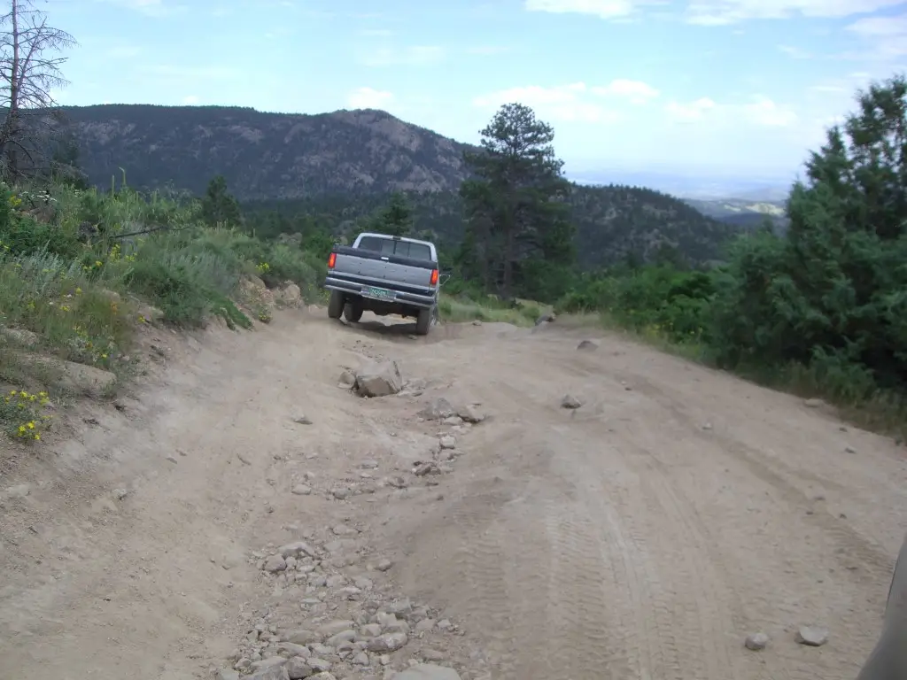

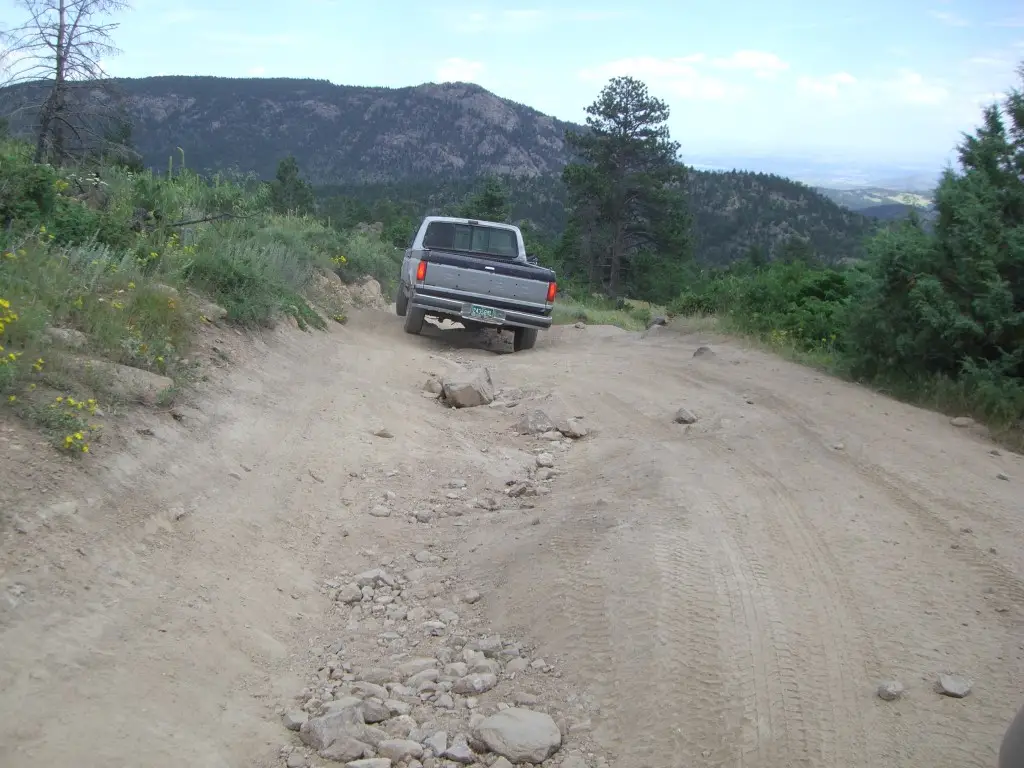

And again, pics never do the steepness any justice, but was steep, and it was loose, just after where I took this, I lost traction and has to turn around. Not a fun task on a steep loose hill, thought we were gonna eat it at one point, but we finally got the nose pointed downhill.

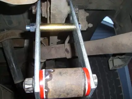

Old shackles are out, spring eye bushing successfully beat into submission and evicted. Tomorrow just need to clean up the spring eyes a bit, prob drill out the new shackles, and I'll be all set when the new bushings show up. Got a couple pics tonight I'll toss on with the rest when it's all done tomorrow. Well.........if it has ***** or wheels it will give you problems........so hopefully will be done tomorrow. (Just a joke ladies).
And I can't sleep........must be the anticipation of getting the shackles done finally. So, I'll just go ahead and give a little update from yesterday. blocked the front tires, took the rear tires off, lifted the whole ass end up with a floor jack under the rear diff, stuck a couple jack stands on the frame right in front of the front leaf spring hangers. lowered the rear axle down a bit and disconnected the shocks. I ran the rear axle up and down to try and get a feel for when the tension was off the existing shackle bolts, but in the end it was just a guess. I had decided early on I wasn't going to mess around with these bolts. I used my angle grinder and a cut off wheel to cut through the lower shackle boltsright between the shackle and the spring eye. didnt spring up or sown muh so my guess with height of the rear axle must have been close . Once all tension was off the upper shackle bolt, they practically fell out. Upper bushings look finer than frog hair, so I'm leaving em for now. This is what is looked like after getting the spring shackle out:

Operation lift Explorer phase 1: COMPLETE Didn't run into any major problems and I'm happy with how it turned out.
Before:
After:
Not a HUGE difference, but quite noticeable to me. The cheapy auto zone kit comes with bolts that are too small of a size. Using those would have meant sloppy play inside the bushing sleeves. I did have to cut the 2 shackle to spring bolts to get the old shackles out, but luckily I had 2 extra laying around from one of my trips to the junkyard. I did use 2 of the bolts that the set included, along with 2 of the inner sleeves that the bushing kit came with to bind the center section of the new shackles together:

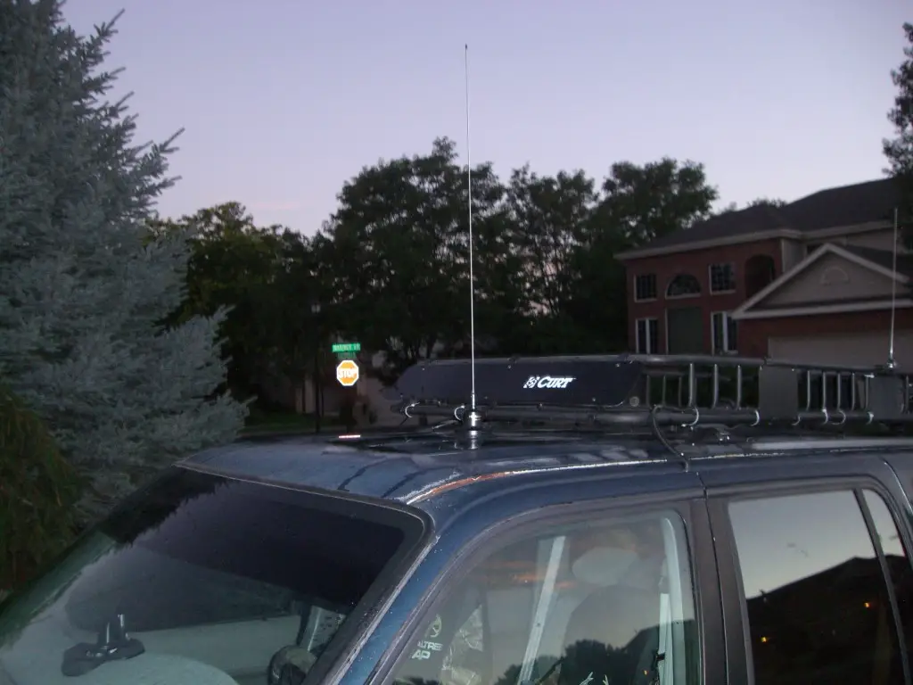

So been a little busy the last few days, but had fun too. Now I just gotta find somewhere or someone that will mount these tires for me really cheap. Plus I'm thinking a CB is next.........

Damn didn't realize that 2nd pic was blurry. I think we're on to some maintenance, repairs, and hopefully a CB if I can find a decent deal on a set up. Think I want to go with a 2' firestick on the roof rack on a spring for those low hanging trees, and garage doors.
