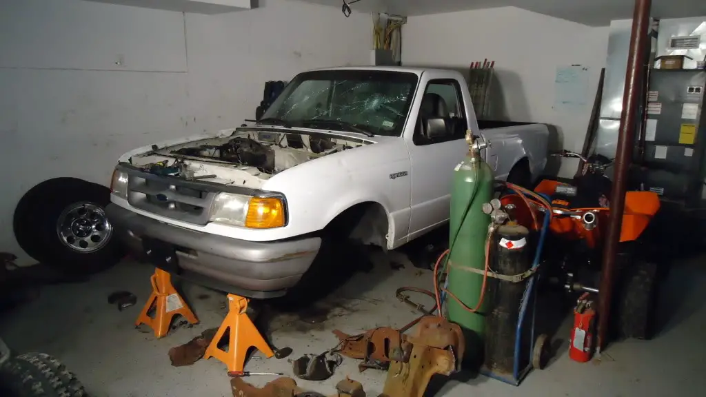

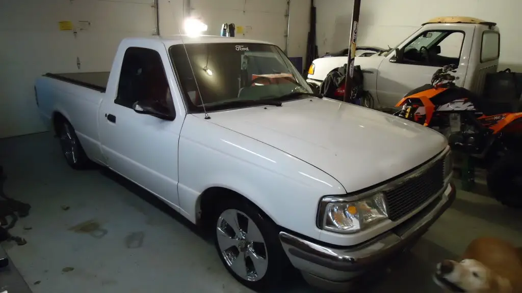

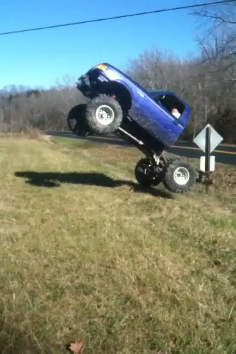

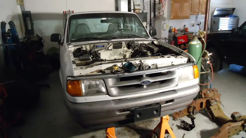

I got bit hard by the tuff truck bug, little lower than my previous rigs, for going fast and smaller jumps 4-5ft or less at this time lol.
Bought 97 Reg Cab 2wd Ranger guy started parting out, little rough.
Truck is getting painted Allis Chalmers Orange- bed will be done on Monday , just fixed dents in it this week at school.

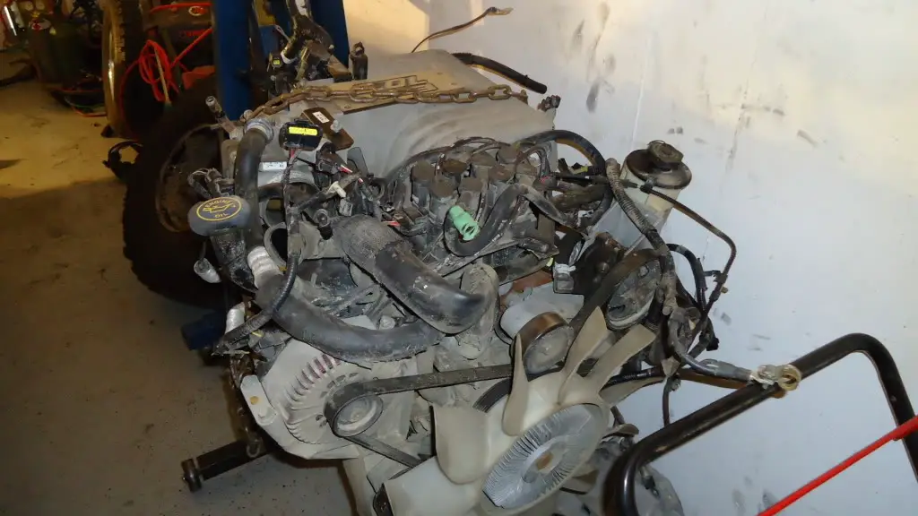

Truck is getting Explorer 302 from my purple truck

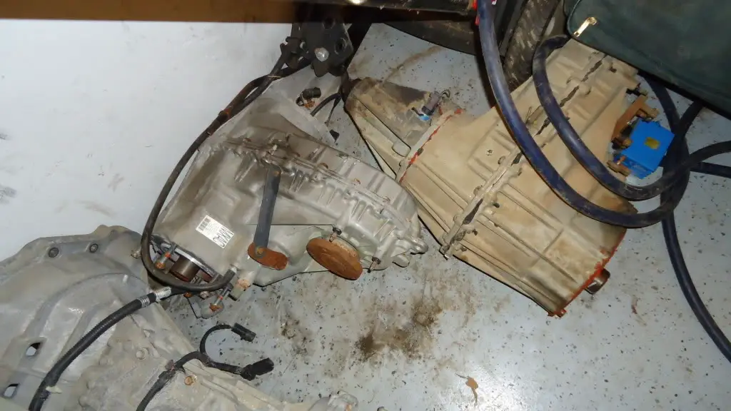

5spd from 98 F150 with 4.2 V6
4406 manual
D35 TTB
James Duff front 5.5 Longarm kits, going to ad Pro Comp bump stops and some limiting straps.
Rear will get Deaver Race pack 2 & 1/2 lift springs
Running Bronco 2 tank in rear to keep wait on rear
Will have full roll cage and Corbeau suspension seats with 3in padded 5-point harnesses
running 31in Procomp Extreme all terrains
Few pics:

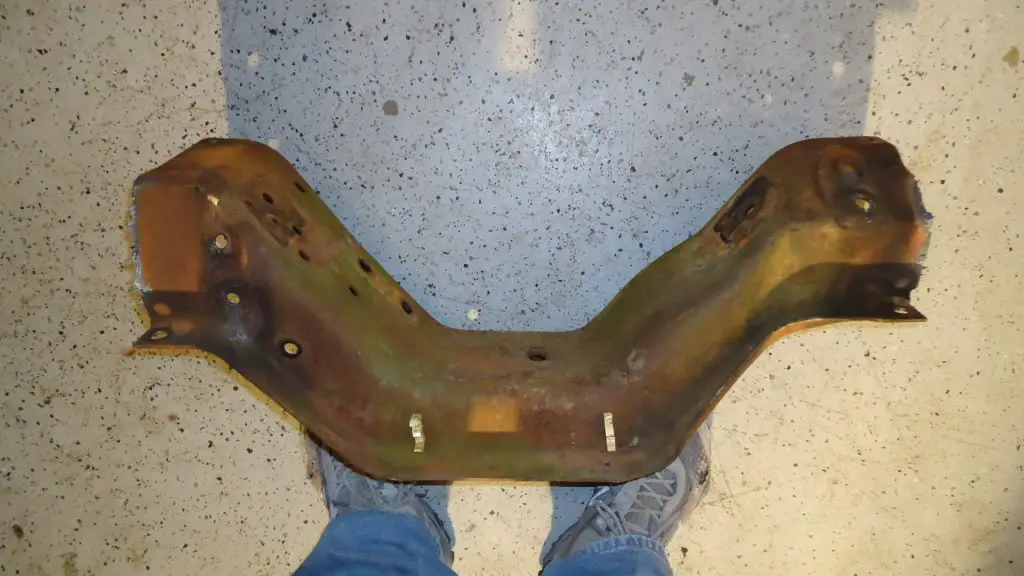

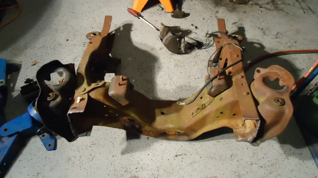

Side note, changing the engine cross member is not fun, I should have found good deal on truck allready 4wd frame, but couldnt find any.

Pretty sure with TTB and V8, gonna need different Oil Pan, this one found from Ford racing that suppose to work
Ford Racings P/N M-6675-A50 For Ford 302/5.0L

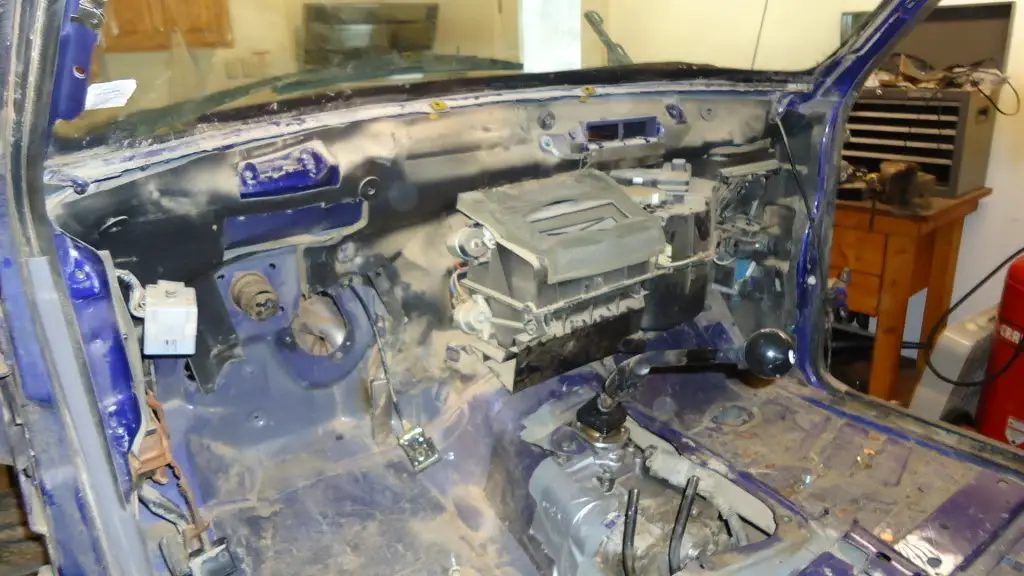

Today goal finish tearing apart purple ranger, clean garage, put eddie bauer in the garage to finish. Hopefully next week finish cross member and get TTB under ranger.

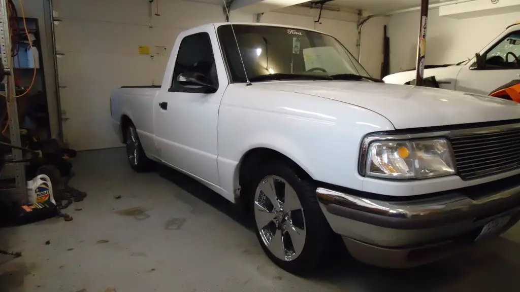

Also I decide just to lower the ranger instead!

Im a little confused here. If the purple Ranger is being stripped of everything for parts, what parts are going where? I imagine the trans & Atlas will go into the TTB Tuff truck Ranger, but what about the rest?
Axles, Custom arms, etc...??

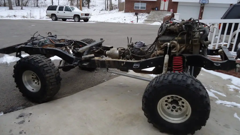

Gman- Tuff truck gets Purples engine, headers, mounts, oil filter relocation. it gets my 4406 and a 5spd I bought in Kc. No need for slow crawlin atlas in tuff truck
My crawler Im building in 99 TJ Wrangler, using purples axles, longarms, atlas, my other explorer v8, still have to buy another tranny, it will use the Boggers also.

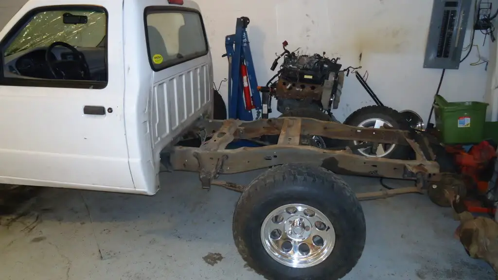

Today finished tearing apart Purple ranger, it is 100% all parts now and just have to do few things on another veh I have and then back to the white Ranger 100%, also somehow on the purple truck left side L&L engine mount I broke it? Not sure what happened, but I can fix it.

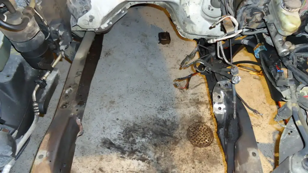

Update: cab if off, been working on the engine cross member and making it all work with my V8, my factory oil pan should clear, and redoing my broken L&L mounts. Should have powertrain in place by the weekend. Just need some d35 peices to finish front, goal is to have cab back on in 2 weeks.
