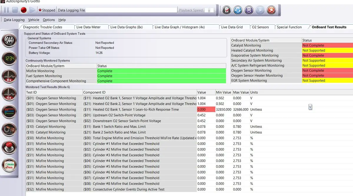

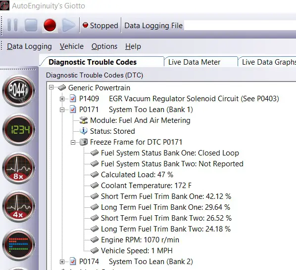

New member, first post. I’ve tried searching for this extensively before posting my own thread.
Ok, I just purchased a 1997 EB 5.0 AWD w/ 156k miles that had a miss. Thinking I could fix it easily but I’m at a loss. Also I am using AutoEnginuity software to look at all of my OBD2 info.
The explorer is mostly stock but I found that the cats have been removed. Everything else is completely stock. The previous owner did a lot of stuff and sold it because he couldn’t get the miss fixed. I did a compression test yesterday, all cylinders were 150-160 psig, verified the proper autolite plugs, plug gap, wires were routed to the right spot on the new coils. By the way he already replaced both coils, all plugs, wires, MAF sensor, injectors, and 1 (bank 2 upstream) O2 sensor.
The engine runs horrible, low erratic RPMs, almost no power, in closed or open loop. All of my STFT and LTFT are really high, O2 readings are high, which if I understand correctly indicated a lean condition and adding fuel. And the O2 graphs are cycling up and down and not flat lined so they’re working. But when I pulled the plugs they were nearly dripping with gas and sooted up. What is going on here??
