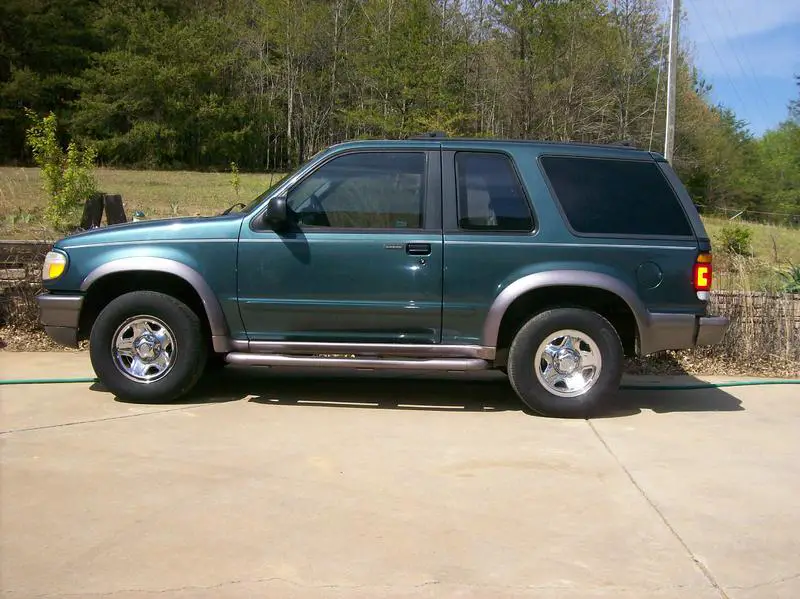

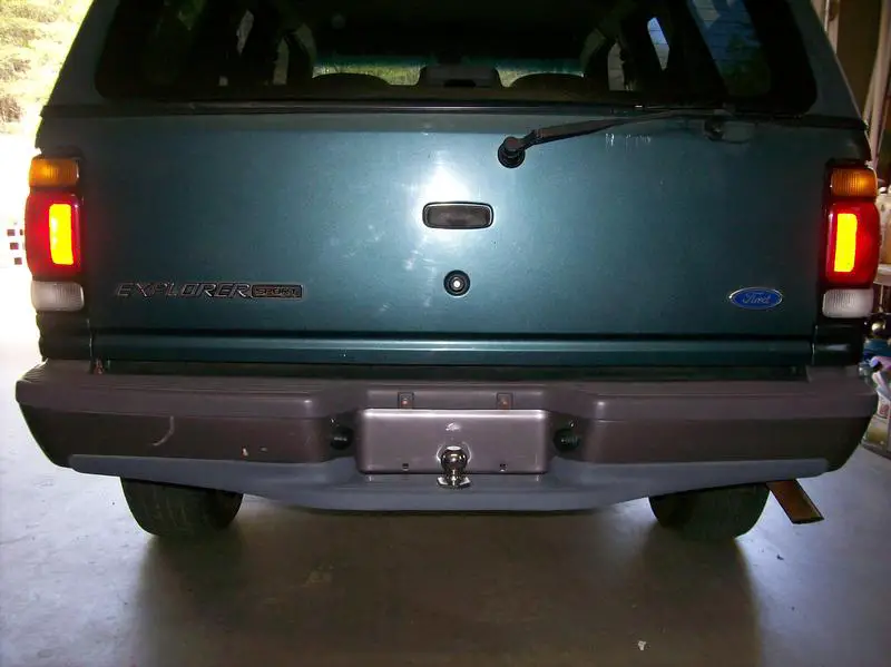

here's some pics with a straightened front bumper, pink door handle now semi-gloss black, the faded rear bumper lower plastic trim painted grey and a new chrome trailer ball (came with the truck and it happens to be the right size for my trailer). oil and filter were changed today (man, the 4.0L SOHC engine makes for a messy oil change. I'd forgotten how messy). it got insured today and tomorrow it gets registered and begins its new life on the road.
