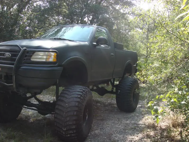

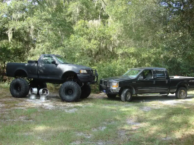

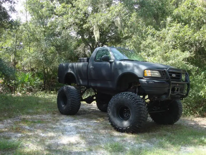

heres a picture of the F150... its not done and actually stripped back down. Going on up to 2.5 tons.
