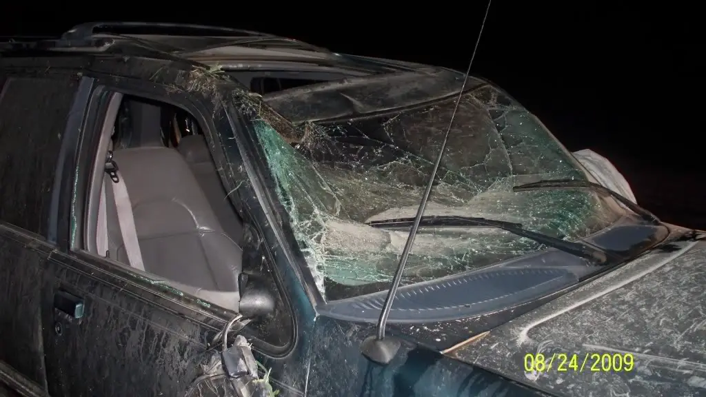

After seeing the video he sent to you on your phone in Moab driving your B2, this does not surprise me to see it flipped over. Hopefully everyone was ok, but damn that is funny......:D
Lacky01
October 18, 2008
748
Eugene, Oregon
1998 Sport
:roll: looks like someone just joined the roll-over posse!! :roll:
if no one was hurt, it was probably scary fun!!! hopefully no one was hurt though ;)

Yea no one was hurt.
