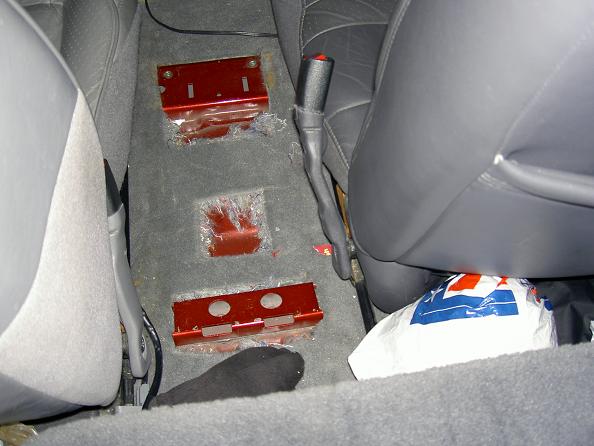

ok the metal part of the console is solid stuck.. i am at the part where all the plastic on the sides is very loose but not comming out. i may have missed a screw i dont think so unless its hard to see its very loose in the back like i can lift it... its hung in the front somewhere i have removed every screw in sight
It's been two years since I pulled my console out, but I'm sure that those four screws/bolts are the main points. The dash screws go straight into the dash under the AC. You can see the two center bolt threaded holes in the floor picture I posted.

yeah i got those screw out i am being kinda gentle cuz i dont want to break anything wish i had a digital to take pics to show you i got my cell but razr cams arent what they are made out to be
Well, will it flex backwards at all? Those steel hooks at the back could be just sticking, it may take a little effort. The whole front 90% should lift up some and twist side to side if it is loose.
yeah the plastic is comming back its just those hooks that are stuck i will go out there and try again i bet they are just stuck like you said
ok gave it a good tug and it came out cut my hand in the process but thats minor :) thanks will keep you up to date on the progress
