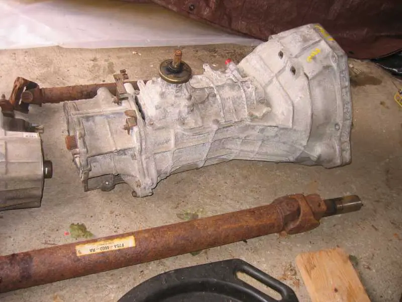

Hey Guys,

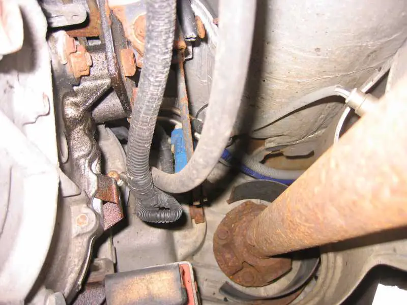

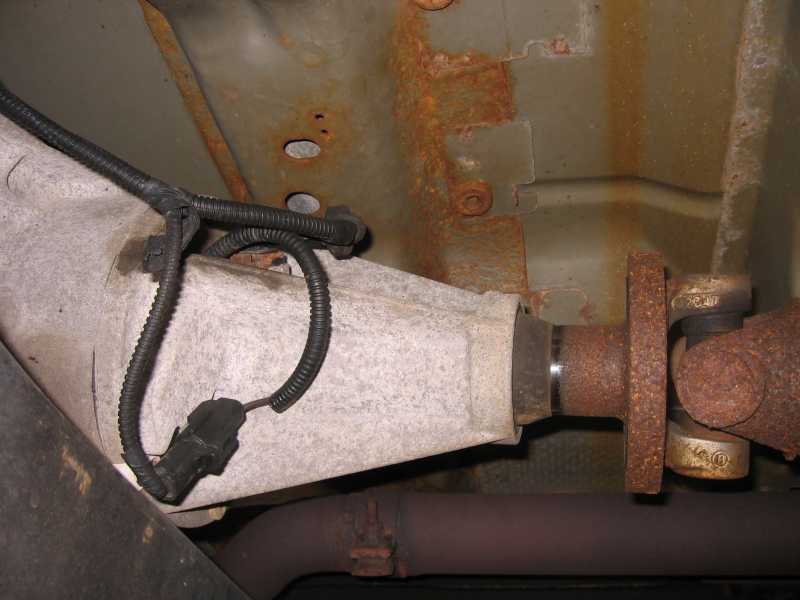

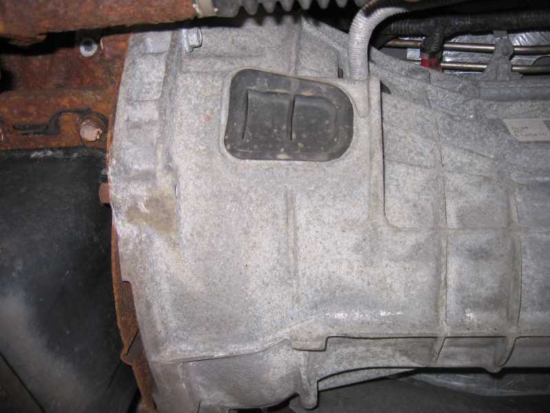

I'm planning on pulling the 4R70W and the 4404 AWD case in my 98 and replacing them with an M5R2 (from a 97 or newer F-150) and a 4406 manual shift. I've been collecting info and measurements about the M5R2 and I know this is uncharted territory for an explorer but I'm pretty sure I will be able to get it to work from everything I've read about it. I also have the convenience of having a friend with an 03 F-150 with a 5 speed (M5R2) and a 4406 M so I have been taking a bunch of pictures and getting measurements off his truck.
For those of you that have done the 4406 conversion I just want to verify, it seems like if you have a 98 or older explorer then you will need a 4406 M from a 98 F-150 for the speedo to work(without going through all the trouble Jamie (410fortune) went through and switching tail shafts and speedo gears)?
However I thought for trucks 98 and newer the VSS was the RABS sensor, or is this only on the 4.0 trucks?
Something else I'm thinking is I do have 33's on the truck so if I go the gear VSS route(not saying I have the option yet, just hypothetical) then it would be a lot easier to adjust the speedo as opposed to getting tunes to do it.
Does anyone know anything about the 2003 4406 and if that might work? The reason I ask is I found one with only 32K and for only $150 which is coming off the same truck I am getting the M5R2 for only $450. Where as the same yard has a 98 F-150 manual shift t-case with 119K on it and for $300 so obviously I'd like the newer, lower mileage, cheaper case if possible.
I plan on doing a little test and unplugging the sensor on my current 4404 and seeing if the speedo still works, and if not then I'll pull the sensor out to see if it is gear driven or one of the doppler kind like the RABS, and if it is then I'll just check and see if the 03 case has the same kind of sensor.
Also it seems both the front and rear drive shafts from a 2000-ish Expedition will bolt right in with the addition of the hybrid 1330 1310 u-joint on the front, correct?
I plan on going to the yard this Friday since I have it off for the holiday to collect as much as I can...
primary list: tranny, tcase(either 03 or 98), F/R driveshafts

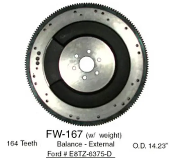

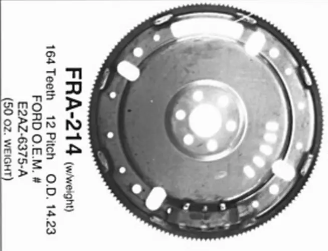

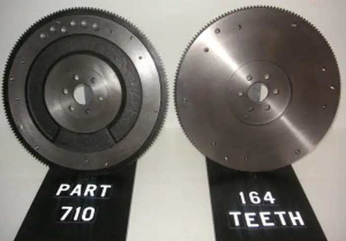

secondary list: 302 flywheel for a 5speed, clutch pedal, master cylinder, and reservoir from either a ranger or explorer(unlikely)
So if anyone can confirm any of my questions that'd be great. Thanks!
