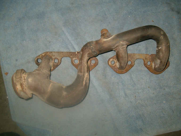

Under the heat shields you will find this--
these have been re-welded -you can see where they crack at the joint of the different material
hum , i wil be a funny job to remove the headers ,
thanks for the hint , i will see tomorrow if i can repair by myself
