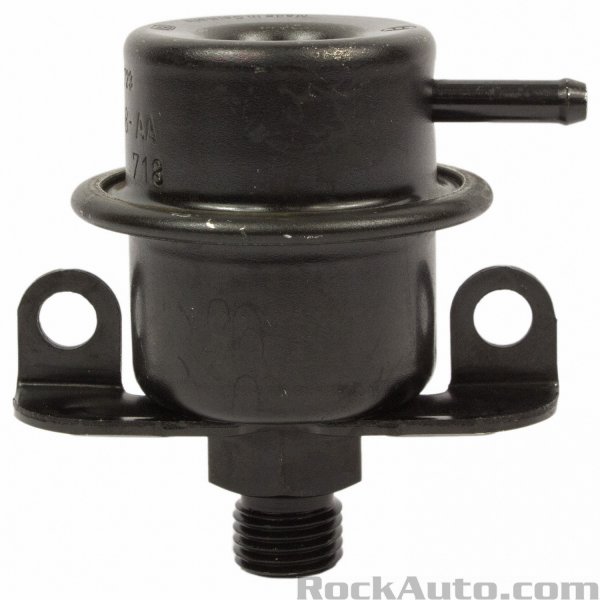

For Reference, my original original fuel pump was getting weak = 28lbs pressure output after 20 years/201,000 miles. But what got me to change it was the following condition: the "check valve" within the pump that holds line pressure for the next start was showing signs that it wasn't sealing after turning the ignition off. The recent cold weather in CA (30's and 40's) made it so that I had to turn the ignition on to the first position, wait a few seconds for the pump to prime the fuel rail, and then turn the ignition key to get a reliable cold engine start the first turn of the key. If I didn't perform that "workaround" operation, on a cold start, I'd have to have the engine spin about 7-8 revolutions before she fired over.
Fuel Pressure Regulator Pic
