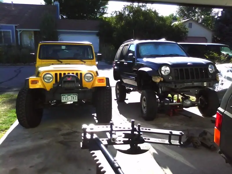

I will post pics after I pick it up. I did SAS swap in a Diesel Jeep Liberty for a friend so already have practice. Plan on using XJ Dana 30 to start and upgrade to 44 at a later date. I welcome any advice and things I should avoid. I have Miller Plasma Cutter, Miller 212 Mig, JD2 tube bender, and garage full of tools so this will be a fun challenge.

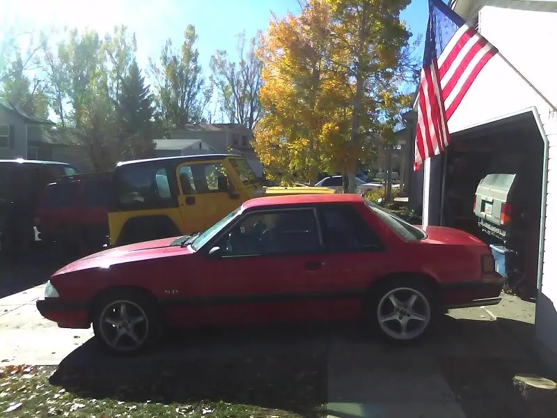

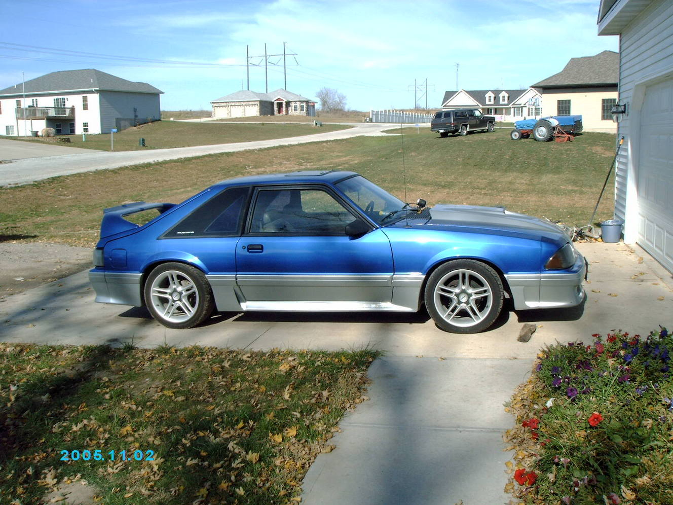

Pictures of my Mustangs...

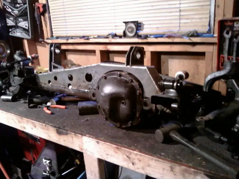

I have trussed a couple XJ Dana 30. Keeps the weak tubes from bowing. I got a hook up on Chrome Moly shafts too.
I have geared about 30+ of these little Dana 30s. They are pretty tough if build them right. And when I upgrade to a 44 make the 30 easier to sell being trussed.

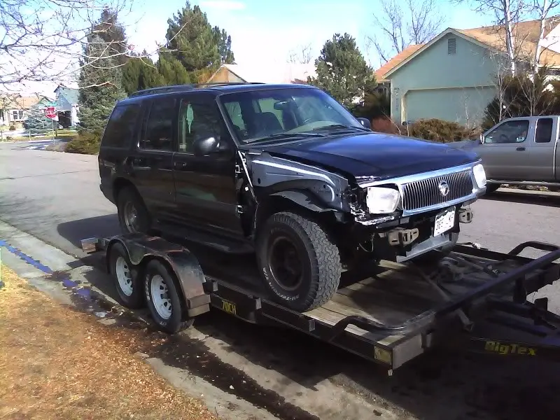

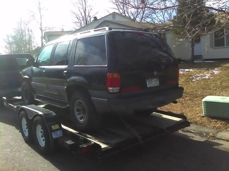

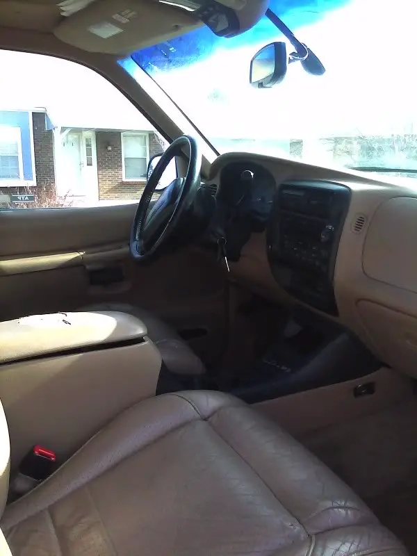

Here it is just picked it. Runs awesome with only 121k miles 5.0 V8. Paid 1500 bucks for it.
Just needs a couple new fenders and I will make bumper for it. :D
Interior needs some scrubbing but is in tack. Need a new center console lid.

nice mustang love the the 5.0 lx !!!.
wow i bought my first used car in 1995 it was a mustang lx 5.0 1993 all jet black with pony rims.i was only 19 years old i hit top speed 138 miles an hour it felt like i was flying! then i lost her year later stupid me drinking and driving dont mix!!i hit a fence and did a 360 and smash my front all up.and till this day i am still looking for a 93 5.0 lx mustang!!very fun car to have!!

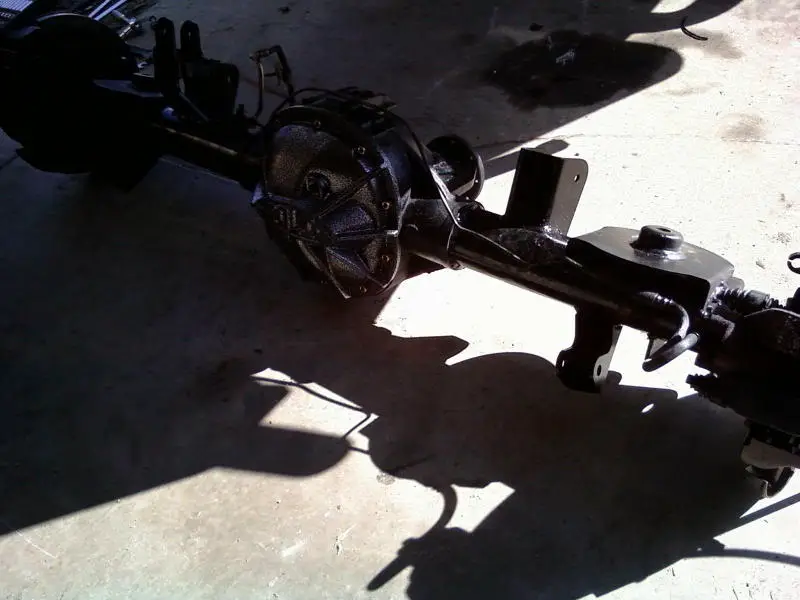

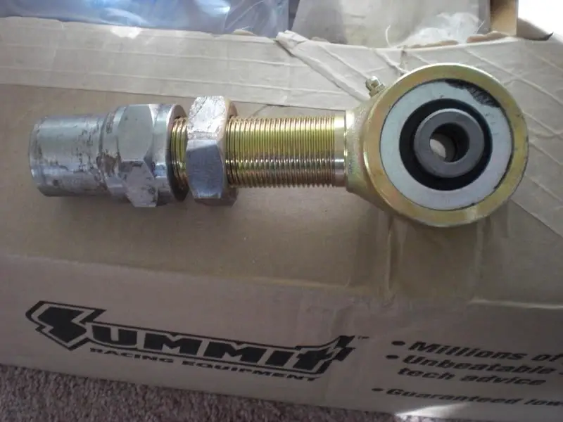

So I have my Currie Johny Joints and weld in bungs, 2 inch .250 wall DOM, Energy Suspensions poly bushings. Picked up a HP Dana turdy. Have some 5/16s plate for brackets. Just need steering box. I have heim joints and 1 1/2" .250 DOM for the steering. Almost ready to get going. Should have it rolling by Feb. sometime. Can't wait.
Thinking I might do 3 link front instead of radius arms. But not sure yet.

Just an FYI three links are a PITA on these trucks. and dear god dont push the *front* axle forward or else no room for a steering box!
Stang5lgt
January 16, 2011
698
2
Parker, CO
98 Mercury Mountaineer
LOL is there any vehicle a 3 link isn't a PITA? More I think about it more I don't even wanna spend time on the 3 link for little bit of extra flex. I like the stock wheel base of these babies so I won't be pushing it forward. Thanks for the advice. :thumbsup:
