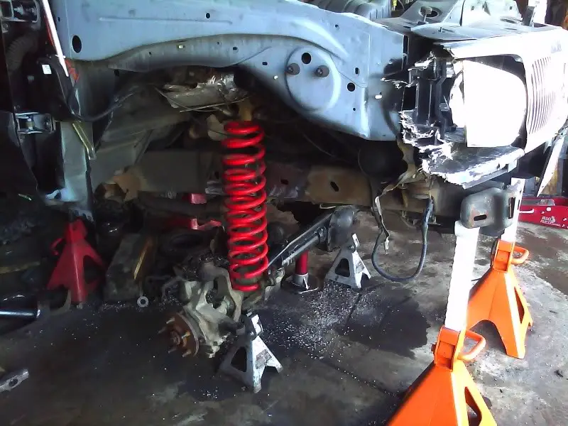

nice job, how did you fab those coil buckets. Ive been trying to figure it out from the few photos but im just not getting it. Im hoping the miller bros can help me as much as you, im waiting for my uncle to let me borrow his miller dynasty 300 tig, he just upgraded to one of those crazy multi-process machines so hopefully ill be able to keep it for awhile.
I just took a piece of 1/4" plate cut circle with my plasma cut off all those little tab things on the coil bucket. Ground it down smooth. Then set the plate on there level. Welded it on. Then took a 8 inch piece of tube and tack welded it in the middle to keep the spring from moving around like Jeep does. Pretty simple. I will finish weld the tube once I test fit everything.
gotcha thanks,was pretty simple i just wasn't sure if there were some steps in between the photos that i missed. so are you going to keep those tubes inside the bucket, or put a set of bump-stops in there. keep up the great work i cant wait to see this finished.
Tubes stay a smaller tube will go inside the larger tube to make a bump stop. If I ever need to change it I can cut right above the weld and put a new tube inside to change the bump stop. Pretty simple you will see soon.

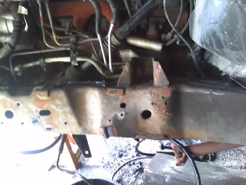

......And now the fun part of grinding forever & ever........ack!
1st gen steering gearbox coupled with a semi-hydro steering ram, makes the steering a breeze. Bronco2guy has that set up with his 302 and ran 37's. One finger steering has to be a dream come true when wheeling. :)

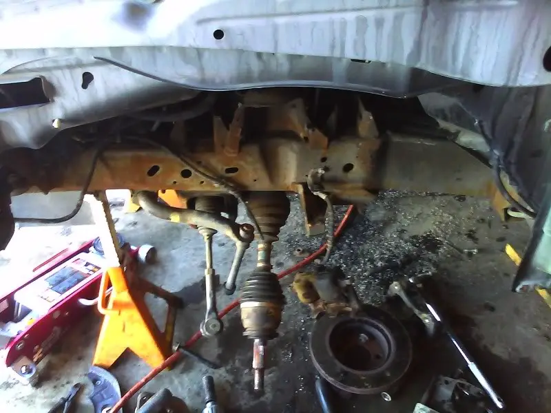

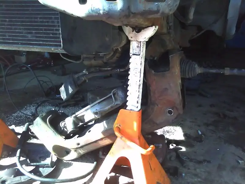

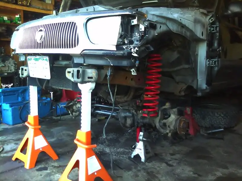

Broke out the big grinder...
It is almost like Ford thought lets make the frame narrow enough to swap Jeep axles under...

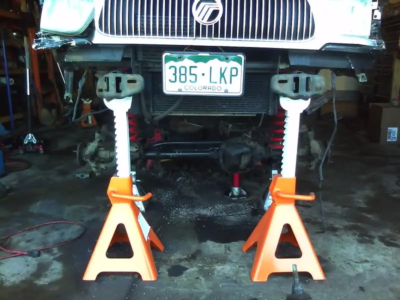

And I got some new super jack stands to make it easier for my big @ss to get under there.

Yeah the hour of grinding sucked getting it out of my ears was worst part. LOL

I will have to check out his steering. I have 1st gen box from a 92 Ranger I parted out last year so I am good to go there. At time I didn't know why I needed to keep it but I did anyway. I even kept the steering shaft. I am getting excited now seeing the axle under the truck.
yea the plasma cutter has to make that a whole hell of a lot easier, I couldn't imagine doing it with a sawzall and grinder. have you put any thought into how your going to do the steering yet?
Going to use 1st gen steering box. You will see soon. I masterminded the steering on that Liberty this will be cake compared to what I pulled off there.

LOL, those HF 12 ton stands are a must! Moving right along too, nice.

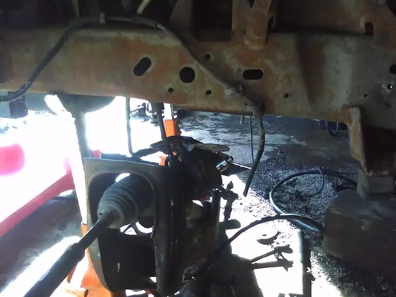

Got the lowers ready...
2" .250 DOM been sitting beside my garage for awhile got a little rust going. LOL
Didn't get as much as I wanted done today. Only spent a hour on it today. My Bday hung out with family.
Took next 3 days off. So hopefully by Wed I will be able to roll it around. Thurs I have 93 Ranger to regear so I need the garage back by then.
