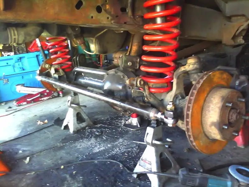

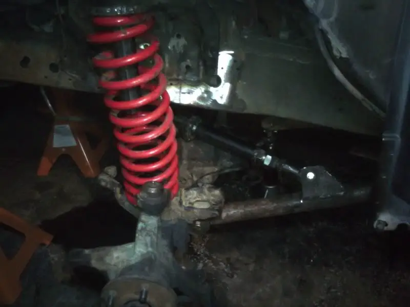

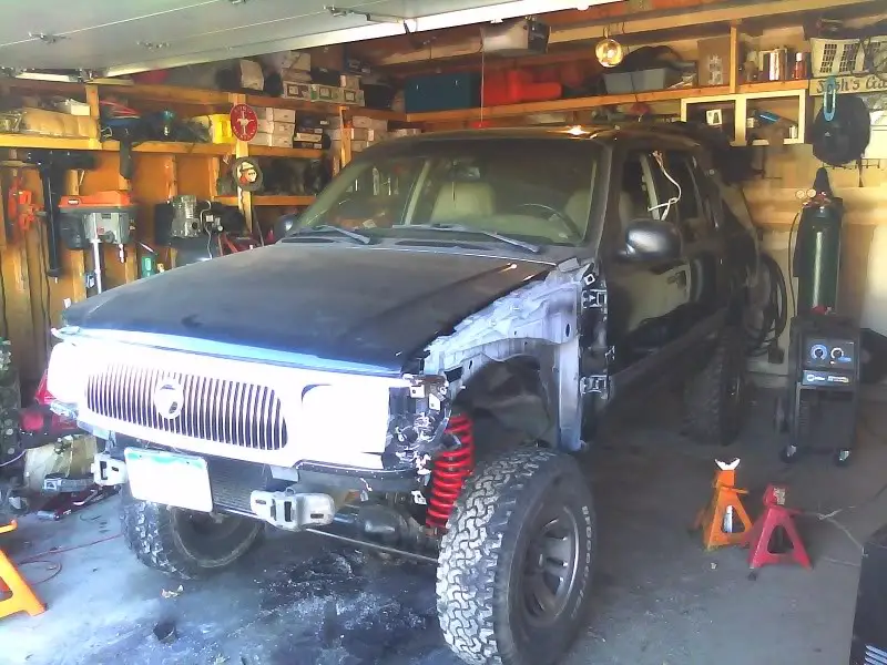

Got one bracket up. Looking like they will work great. I will probably use the shock mount on this bracket. And do shock hoops later.
If you look at bottom right of bracket there is rivet hole. Lining that hole up with hole in the frame works great for centering the wheel. The brackets are mirror images of each other and so is frame so hole trick works for both sides.

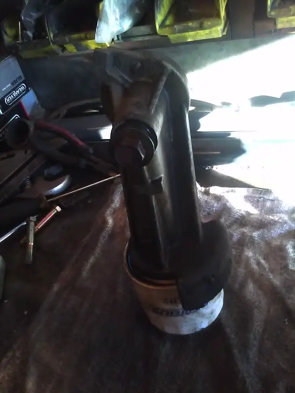

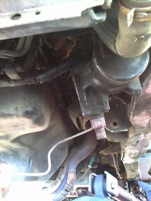

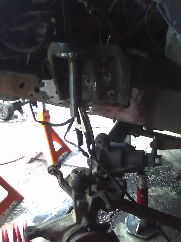

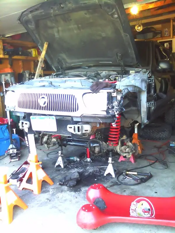

Working on the steering box today...

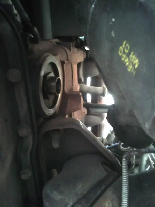

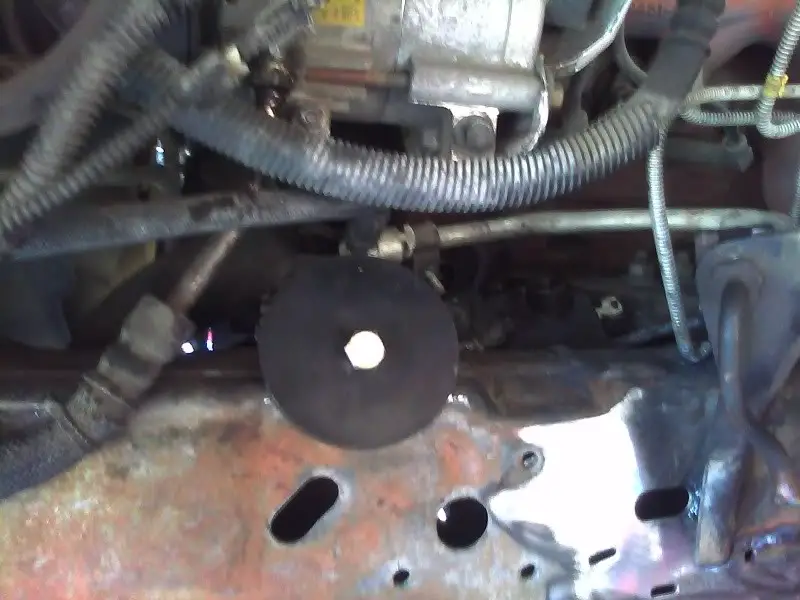

Ordered a oil filter relocation kit with double filters. Figured I may as well upgrade since I have to move it anyway.

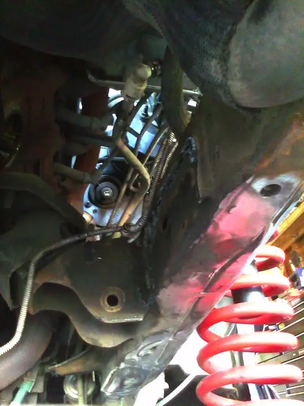

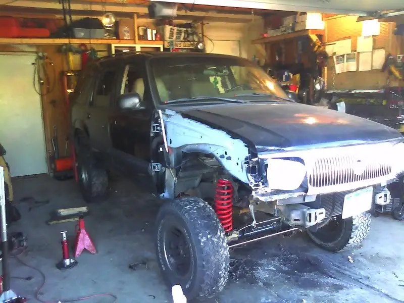

Had cut some more bracket out of the way. Spent another 20 mins grinding it clean. Also had to move the starter and ground cable to make room. Should fit fine. I guess I don't understand why everyone thought this was hard. I guess if this is all the worse it is then I should be happy. :)
Nice progress!! And all the grinding does suck but you will love it in the end!! Should be a blast.

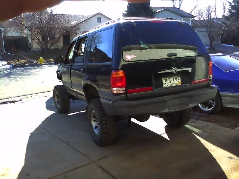

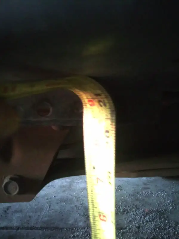

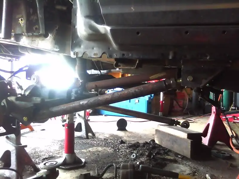

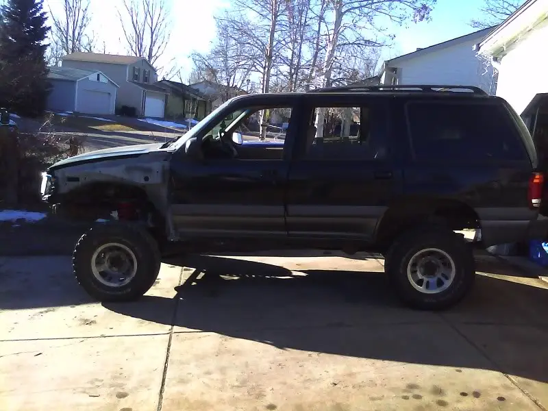

And here we go boys and girls ride height revealed....
Front to pinch seam...
Rear to pinch seam...

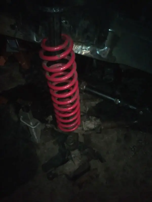

Mmmm... tasty
I am either really good or just really lucky... My dad always said better to be lucky then good. LOL
Compliments on those coil bucket/mounts. You're really blazing along with this so you'll have all the bugs worked out by the spring!
Thanks I wanna wheel it so bad I can taste it keeping me motivated. I have bad habit of putting stuff off if it starts taking too long so I am forcing myself to go as fast as I can.
looks incredible, you work fast as hell im very impressed. so what little odds and ends are left. and are you going to keep those coils the way they are they look pretty bowed in the pics.
