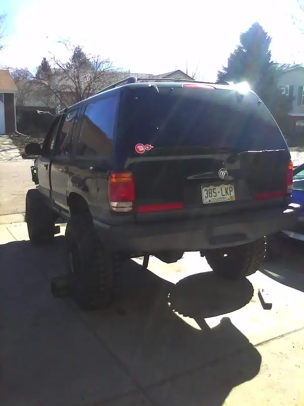

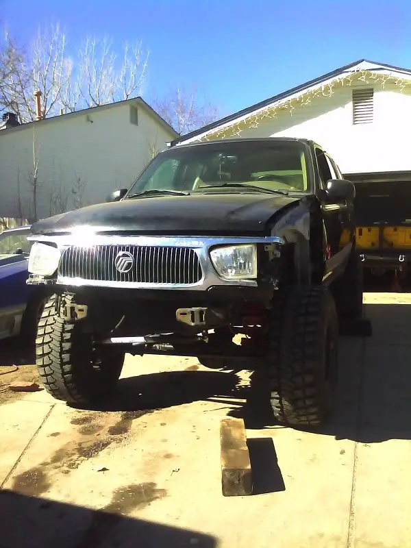

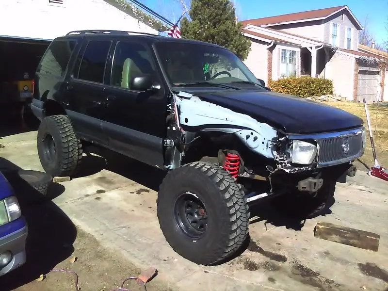

I couldn't wait any longer. Still have more to do but went ahead and borrowed the Kevlars from the TJ.
Donig :burnout: would be cool but very expensive and those tires don't look cheap

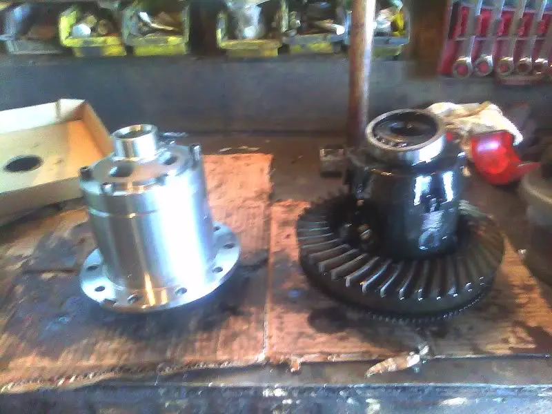

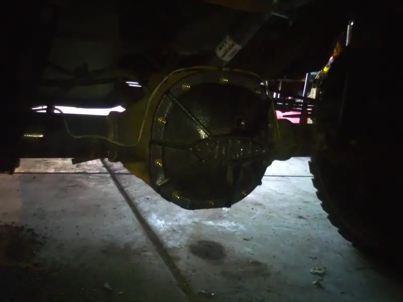

I just took it for spin with 4.88s, Detroit, and bald 31s. Thing hauls. Tire chirp in 2nd gear. I need a sway bar lol. Comes out of a corner and Detroit locks up and pushes the front corner into the sky. And man this thing rides like cadi over bumps so smooth.

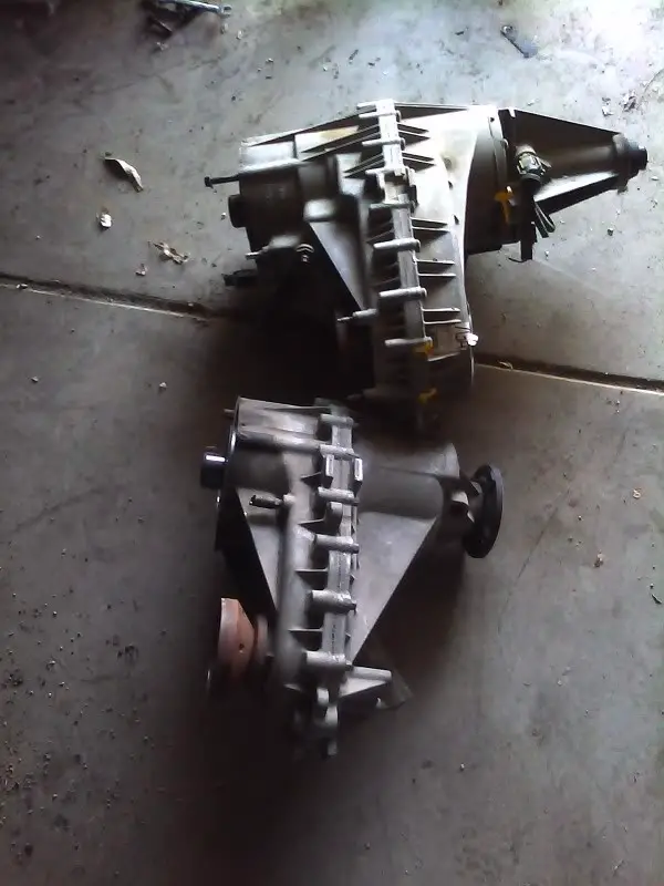

Today I will finishing up the Tcase swap. Luckily this year the speedo runs off the rear axle abs sensor. So I am good to go. Even though I have right Tcase for a speed sensor in the tail cone.
As you can see the AWD case on the bottom is tiny compared to F150 BW4406 manual shift case. So I have clearance a few areas for it to fit. The new rear driveshaft uses massive 1350 u joints. So should be able tow with this rig pretty easy. :)
Gas tank and trans tunnel mod for fitment of that beast. I wish that case was somehow used in all Fords 4x4's stock. Your MPG will be great with that t-case too. Did you get the rear shaft out of an Expedition? What are you using for the front shaft? Sorry if you posted it already.

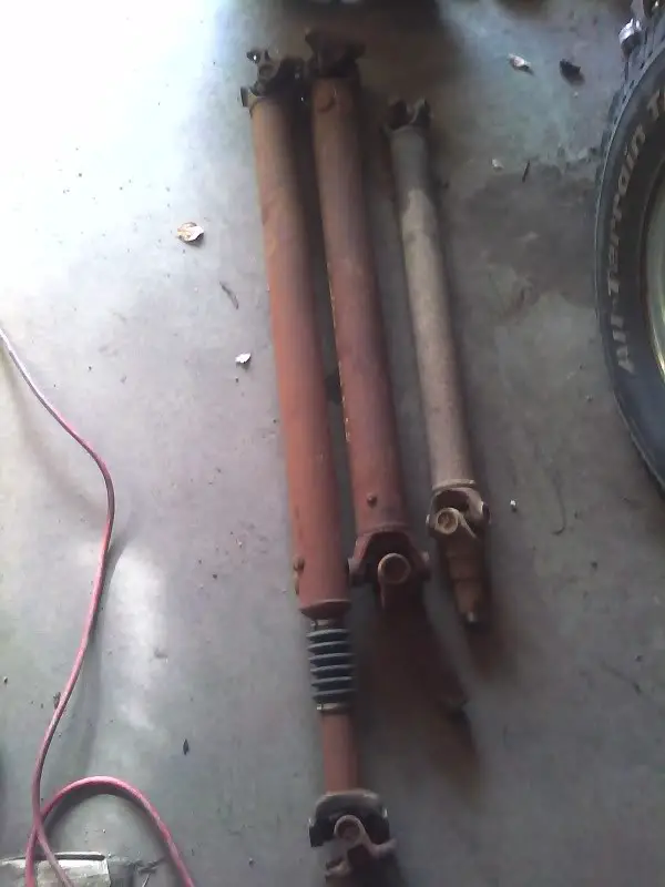

Yep Expedition rear. Since I am Ford guy and Jeep guy. Going to put together a ******* front shaft. If it works you will see. Just need the case in so I can measure.

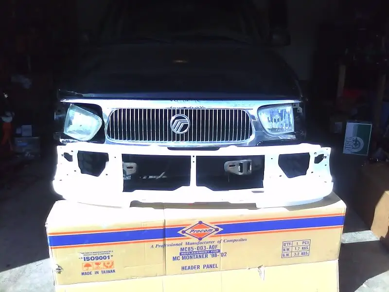

I was going to take it for shake down run tomorrow. But my new headlights still have not shown over week now. Kinda pissed.:mad:

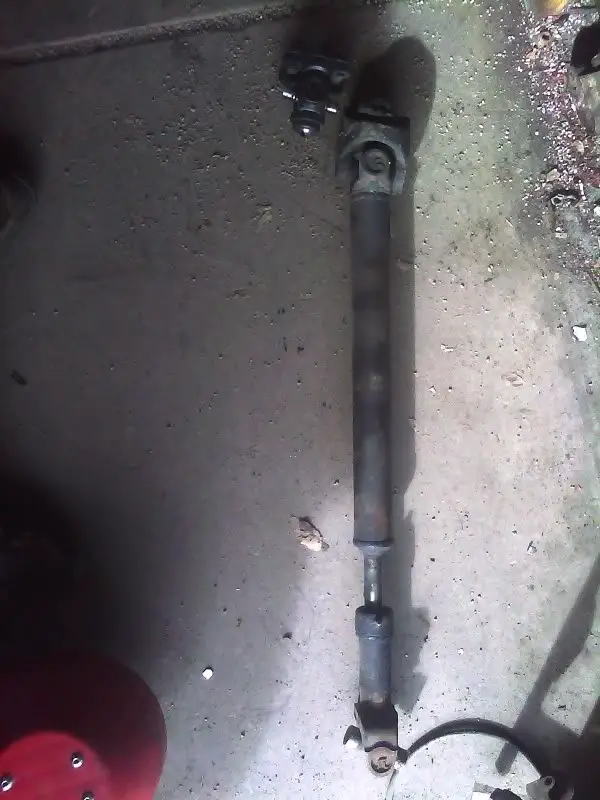

Long shaft old Merc rear. The middle is Expedition and tiny one is Jeep Cherokee. Poor Jeep. :D
Don't know if this has been done(probably has) only thing I could find was using they hybrid 1310 1330 joint. I didn't like the idea of that. So this shaft is from Automatic 4.0 NP231 Jeep Cherokee. It is perfect length. And then I have this yoke for double cardan from a Lincoln MK VII Tbirds. Fits like glove. And no weird U joint to mess with.
And I will say this installing the case was a ROYAL PITA. Everytime I got it up there was some other thing in the way. LOL My cats I had to strapped over. And the gas tank barely gave me enough room. Thank goodness the truck was on E when I bought it. I had to add couple gallons to get it in the garage when I got it home. I almost went filled it up the other day so glad I didn't. :D
Yeah, most drop the tank in the front, & trim the tank area a bit for clearance. I have also seen someone use a Toyota front half/ Ford rear half slip cv, for the front shaft. If that makes any sense. :rolleyes:
Yeah makes since. I just figured XJ shafts are dime a dozen at the JY and I mostly wheel with Jeep guys so my spare shaft can work for there rigs too. I will probably build a second keep as a spare.

And on another note *******s I ordered my headlights refunded my money today after they sat on it for week. Said the part was out of stock. WTF!!!
Got shafts in. But I am going to have to make some mods to the crossmember since the front shaft is touching it now. And still need to finish the hole in the floor for the shifter.
