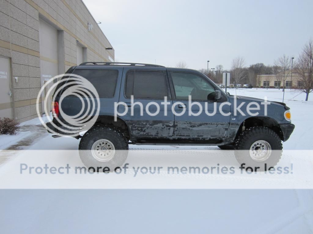

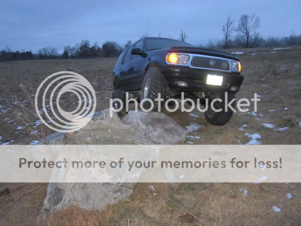

Hi there. Last year I bought this $600 beauty.
This November i turned it into this beast.
Last spring i did the BW4406 transfer case swap to be done with the AWD poo.
Then i spent the summer collecting parts, narrowing the front axle and getting the gears set up.
The list.
Factory v8 212,000 miles on the clock.
'78 bronco HP dana 44 narrowed 6" completely rebuilt
Chromoly early bronco shaft's
Detroit locker front
4.56 gears
Custom long radius arms
Wild Horses 3.5" coil springs
Rancho rs 9000's F/R
Thunderbird calipers
Gen 1 explorer front shaft modified.
Inverted chevy tie rod ends, 1 1/2" tie rods
Bronco2 steering gear rebuilt and tapped for ram assist
Original 8.8 completely rebuilt during SOA
Welded center housing to axle tubes
64" chevy rear springs no overloads graphite paint
New True Trac rear
4.56 gears
Dutchman shafts
Solid 8.8 diff cover
1" longer boomerang shackles
Old 15" by 8.5" American Racing wheels
35" BFG Mud Terrain's
Expedition c/v rear shaft
Dakota Digital speed correction module
Much more to come!!!!
Build thread is here http://www.explorerforum.com/forums/showthread.php?t=412160
Some initial testing at my friends place.
