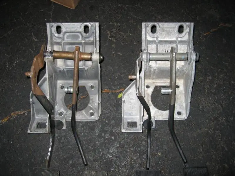

So I figured out what the problem is. It finally broke to the point where it was obvious. I had noticed that I lost 1/2 of my clutch pedal travel a little while ago and got under there to see if maybe the problem might have been air in the system. To my surprise, the clutch pedal casting was broken at the pivot lug. There is a pin that goes through this pivot point which holds both the clutch pedal and brake pedal. Needless to say, the whole assembly swings up every time you step on the clutch. The brake pedal loses some travel too, but not as much. It's only a matter of time before that side goes and I'll be without brakes. I really need to thank Ford for yet another unbelievably stupid design with potentially deadly consequences. So much force goes through there and there is such a small amount of aluminum at that pivot point. This is mind boggling!

Well, I thought I'd post some more progress and the final solution. Last week, I had to take a trip and needed to get this thing fixed. I took the bracket off and had it professionally welded. The welder said it did not weld properly and the weld was quite porous. It must have been some kind of magnesium alloy....don't know, don't care....the whole design was garbage to begin with. It lasted just over a week and the weld came straight off. Good thing I wasn't too far from home and I had defeated the clutch switch so I was able to start it in gear and make my way home in 1st.
Not that it matters much, but just for comparison purposes, I spent $40 on getting it welded, drilled and reamed. Had I contacted the dealer, I would have realized how cheap the replacement was. My cost on it was $60, including the pedals!!! That must have been Ford's way of subsidizing this garbage and potentially dangerous design, which might have kept a recall at bay.
I thought I'd include photos of the old and new bracket. Notice the reinforcement ribs that were added in the trouble area.

What is that part number!?~
Do you know the part number of the casting pictures that you posted. I am having the exact same problem. My dad gave me his ranger if i'd replace the clutch, and that damn piece just broke off! And i'm pretty sure the clutch doesnt even need replaced because he said that his issue was that he had to hold his foot under the brake to press the clutch in, and now it just finally snapped with barely any pressure. It would be a huge help if you could identify that part number for me!
:salute:
I just got this part, $94 in DC. Part number K863G was stamped on the part but 6L5Z*2455*BB Pedal Asy is on the invoice. BTW I had to buy a new master cylinder because I broke the clip, didn't know how to remove the rod without breaking the clip. Hope this help.

I'm hoping the pedal assembly Part # 6L5z2455bb listed above will work for my Explorer. I'll be ordering it off amazon.com. The parts look identical, except for the crack on mine and extra ribs on the new one. Everything I've found says that it's for 2006 to 2011 ranger though. Looks like a couple people have fit it into '98 Rangers. I just can't find any info on it being used for Explorers.
