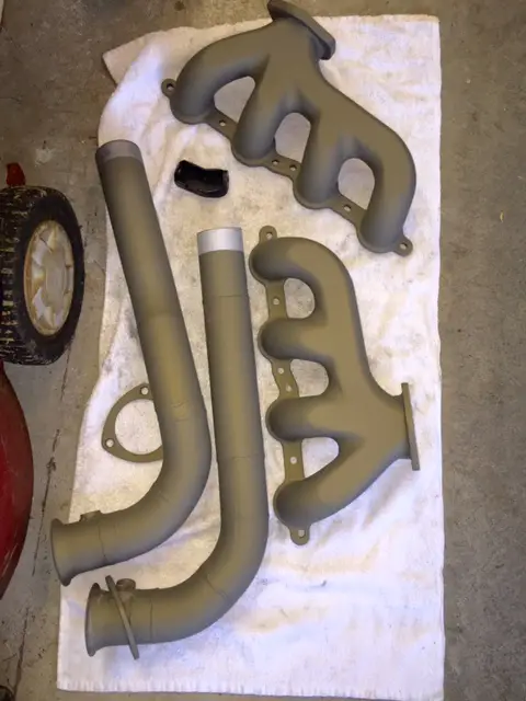

Sounds like fun. Have you seen the manifolds available, and on the engine? This one below is an aftermarket, but SS, and he(Michael) had them coated. That's what I want for my truck, and those below are 1.75" big throughout.
The factory exhaust manifolds that came with this engine look like they flow way better than the crummy stock manifolds for the explorer 5.0. I am going to run a turbo, so I am flipping them around. I may get some 'up and forward' style headers from ebay. The steering shaft is too close for comfort, so if I go with a welded tube header I should be able to more easily modify and reroute for some additional clearance.
