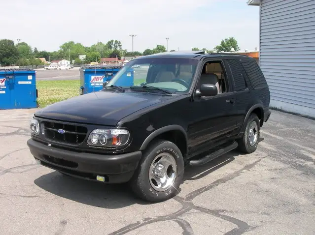

Just finished my HID Retrofit
Looks great Brad. Now I'm not the only one in town with the retrofit in a 2nd gen Ex.

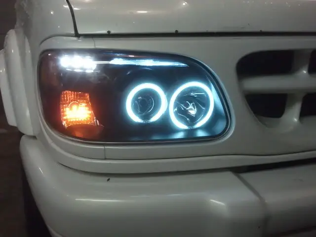

Are you looking at these ones:
Or these ones:
Theyre both very easy to hook up/install, its definitely time consuming though, take a good 2 hours todo it right.
The first pair is what I have now, the CCFL Halo Projectors, the 2nd pair on the black Ex is my old set, just the LED Halo Projectors. Lookwise, I love the first pair (CCFL is such a better Halo then the LED, so much brighter), and I like the way everythings layed out in them. The projector in them isnt my favorite, the projector in the other set is alot better.
Which ones are the second pair of lights?
