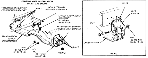

Trying to find out if the bushings of the frame mount/crossbar for the trans are something that needs to be ordered from the dealer? Not looking for the actual trans mount, but the brace that goes from side to side of the frame & what the mount is attached to.
