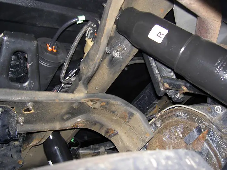

I want to replace all shocks on my 99 v8 explorer. I believe I have an automatic air ride suspension in the back? I hear it turn on sometimes in the back not really familiar with it. Lordco said they don’t even have listings for what shocks work for me. Any advice? Thank you

the air ride shocks are shocks and they have plastic air lines that run all over the place under there
To remove them just unbolt all the shocks and cut out all the plastic bits
There is a switch in the rear hatch behind the jack cover that allows you to turn the air ride suspension to the off position
That is about as far as most people take it
Next you just replace the shocks with regular, non air ride, shocks.

Those ARC systems are great when they are in good shape. The air line connections are the weak links, if the o-rings or seals in any of them wear and leak too much, the compressor will run too much. The system is very reliable other than the leak potential after 10-20 years. The rear height sensors have a joint in them which pivots, it's a metal ball/socket design. If that gets worn from corrosion, same thing from 10-20 years of age, then the sensor will be erratic in what it tells the module to do.
So if everything works but has air leaks, you can replace the shocks(all four for 95-98's, or two for 99-01's), with OEM NOS or equivalent Monroe's. The original shocks had electrical connections so internally they would alter shock valving slightly(like the 80's Turbo Coupe's had). I had the rear shocks watching on eBay, they ran about $60 each last I looked(I gave about $95 for a pair years ago).
If the compressor is allowed to run too much, that will kill it eventually, like all air ride compressors. Turn the switch off in the back to save the compressor if you hear it run too often.
To disable the system, just turn it off, swap the shocks, and disconnect the ARC module, which is behind and to the right of the radio(two connectors).

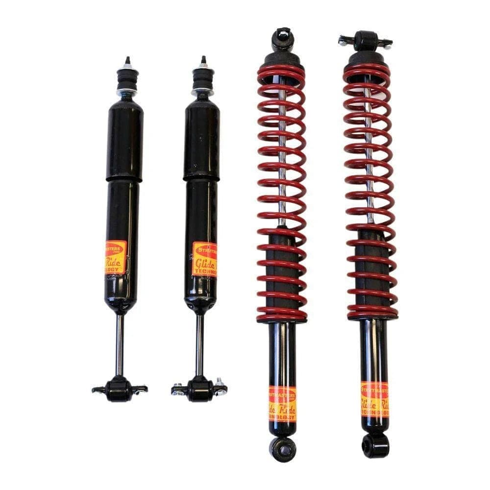

Air ride also has softer springs and torsion bars. The air acts as an additional spring.
You may want to replace the rears with the Monroe coilovers. That would be equivalent to the air.
You don't have to buy it but a suspension conversion kit is that:
Strongly suggest these:
https://www.amazon.com/dp/B000C53RXK/?tag=serious-20
For the front, you should probably get:
https://www.amazon.com/dp/B000C3ZDEI/?tag=serious-20
or even Bilstiens.
Remember, you have very soft springs. Cheap shocks will create tons of body roll.

I highly recommend the Monroe Load adjusting coil over shocks. They have fixed my saggy back end and given a much better rear ride. They are comparable or less then Rancho and Bilstine I believe. If you are ditching that air.
I agree, I feel much more confident driving with them. They should have been stock in my opinion. I transported a very large load (1500ish lbs-probably at the GVWR) for a short distance and was very impressed with the handling. No shock can make up for a spring. Shocks are supposed to control damping RATE. You want to nip the damping before it has to control it :lol:

^ The irony is that you wrote stock. When I first put the Monroe coilover on mine, the impression was that it returned the vehicle to the stock ride properties. IMO, having them on from the factory would have been far too harsh. Ford was already recommending a questionably low tire pressure to combat the harsh factory ride.
It's just an impossible combination, a relatively narrow but tall, body on frame vehicle with torsion bars and leaf springs. Something has to give and that something was ride vs handling. There is no way to make it ideal for both ride quality on bumpy roads, and handle well with a load or on curves. An adjustable air suspension has that potential but it would have to actively adjust to every situation which was a feature before its time.

thanks a lot guys, think I’m going to get those Monroe’s for the back and ditch the air ride. Also got KYB’s for the front already. Appreciate the info
