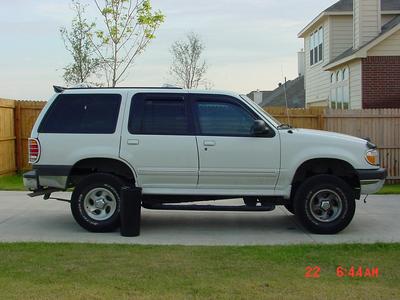

hokie, u trying to post them pics? nothing in here. yah, the BL is hard to do if it is the first tim eu are doing it. i learn it the hard way. good thing the guys came to the rescue. find someone in your area that had done a few. air tools are a great help.
looking at the measurements again, i think i got almost 4 at the front and 3 1/2 at the rear............hhhhm.....how can that be eh?
and about bigger tires..ginner then 31's, i dont think 32 or 33 will fit if i want to turn the front wheel. i hate to trim body parts. i like them too much.

They will fit..... Trust me :) You can still torsion twist the front of yours a bit more. The trimming only occurs on the most inner side of the tupperware so you really dont ever even notice that you just trimmed it.
Digger had the same thing when he did his 2". He got a full 2.5" all around. Did you measure the length of the lift blocks? I'll see if that happens to me when I do my 2"
hokie, actually idid measure the blocks and they were 3" go figure, right?
hhmm...brian, those 33 looks more and more tempting. someone got some 33s that we can swap and let me see what it looks like? just a ittle on the inside eh......hmmm.
33/12.5/15 or 33/10.5/15 bfg mt
If you're worried about rubbing, i'd go with the 33x10.50's. Also, you probably wouldn't want to run 33x12.50's on a 15x7 rim. I could be done, but I wouldn't do it on my truck. I wouldn't think the bead would ever sit quite right on the rim

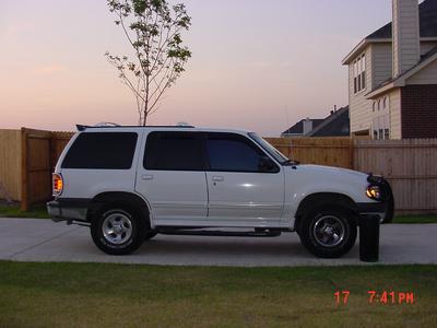

Trying this again...
sweeet. hmmm... do we need bigger meats on there?
Just go ahead and call 4 Wheel Parts and get your 33's. Take the hit in the pocket book for a couple of weeks. He He am I helping? The 33x12.50x15 will mount fine on your rim since your not out rock crawling. Just always check your tire pressure and rotate/balance them. But you can also go w/ a 33x10.50x15. Just get the 33's :p
