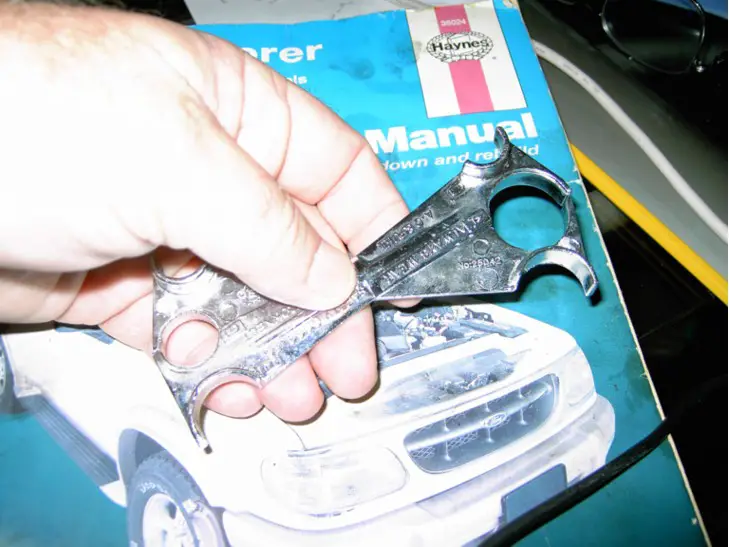

Special tool is simple and is shown below.
Good luck and ask questions.
