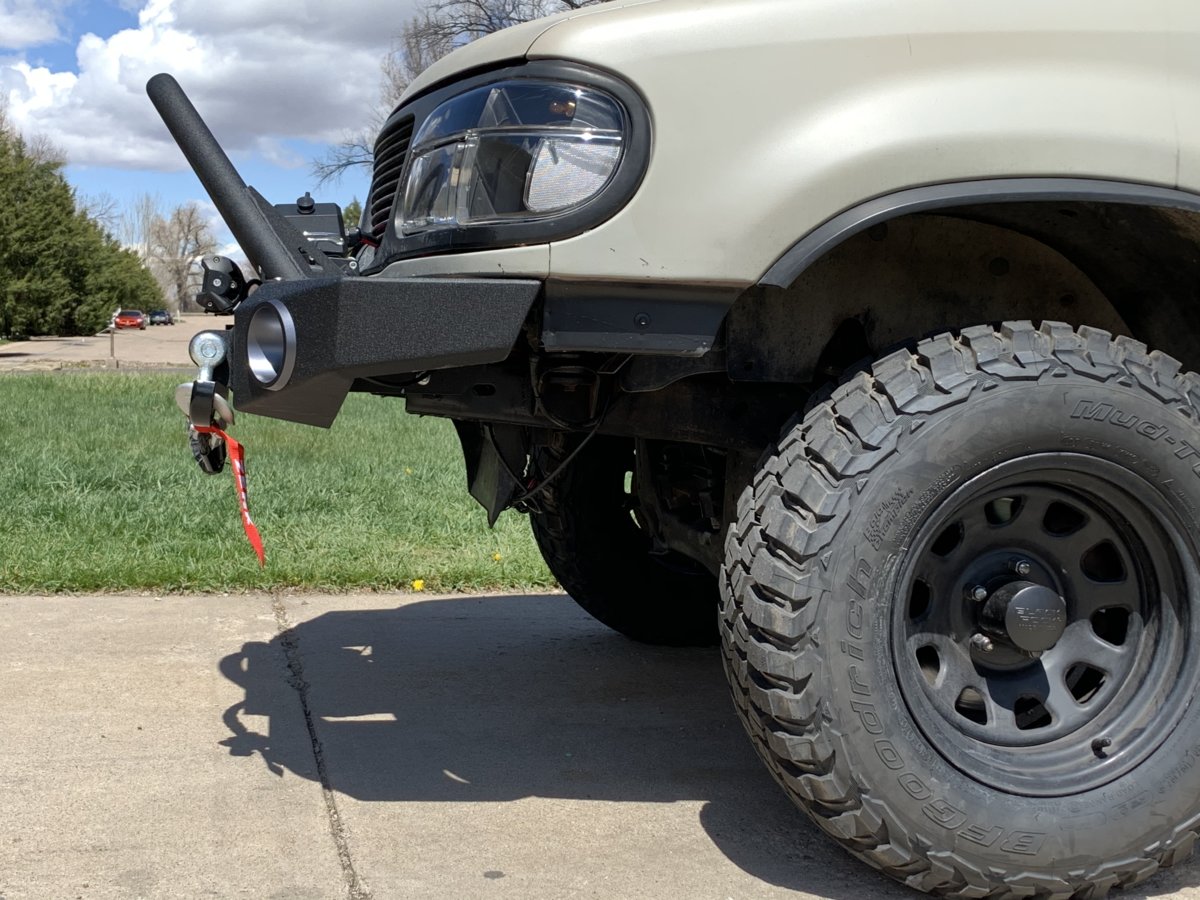

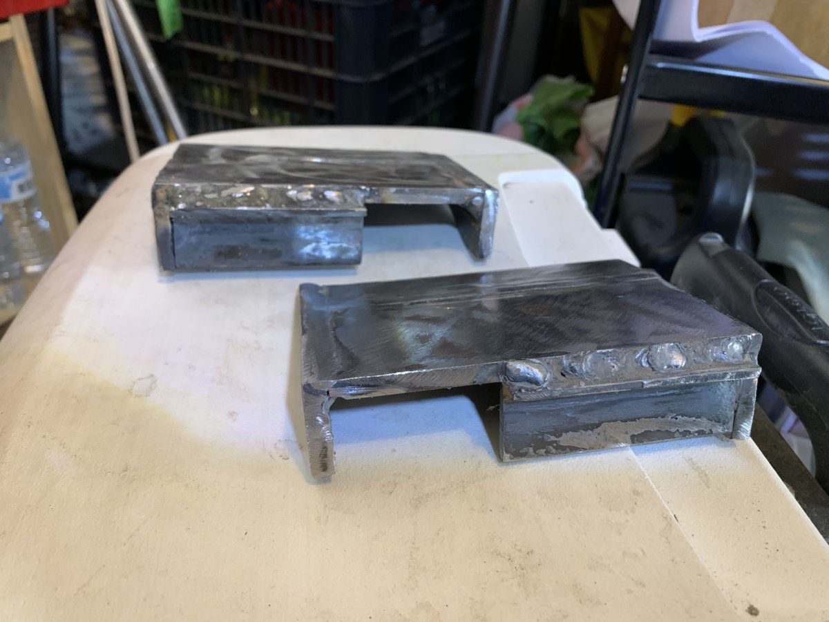

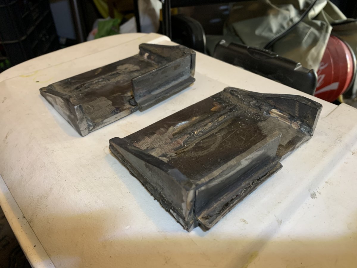

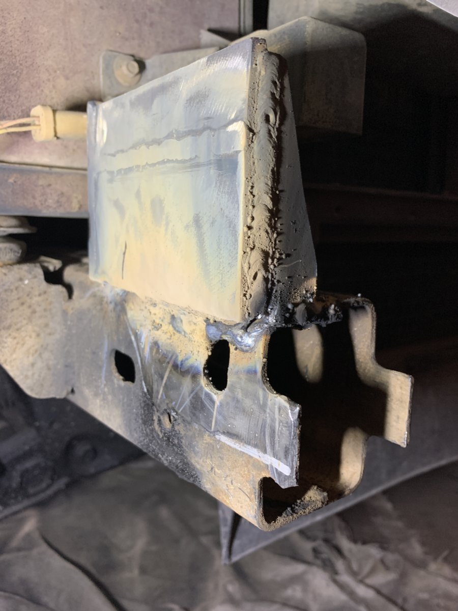

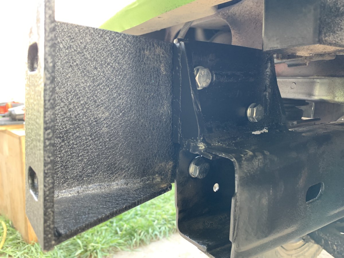

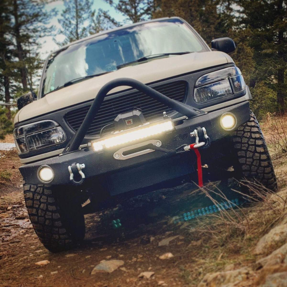

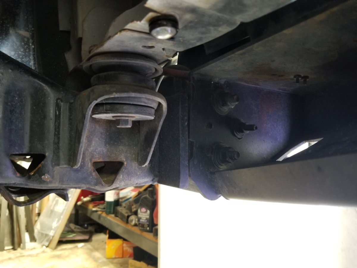

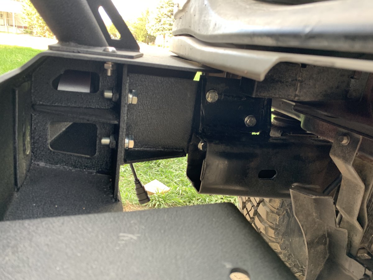

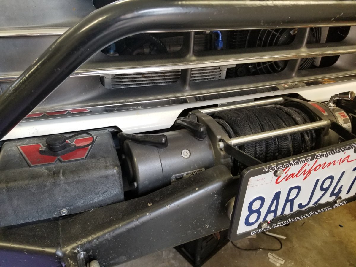

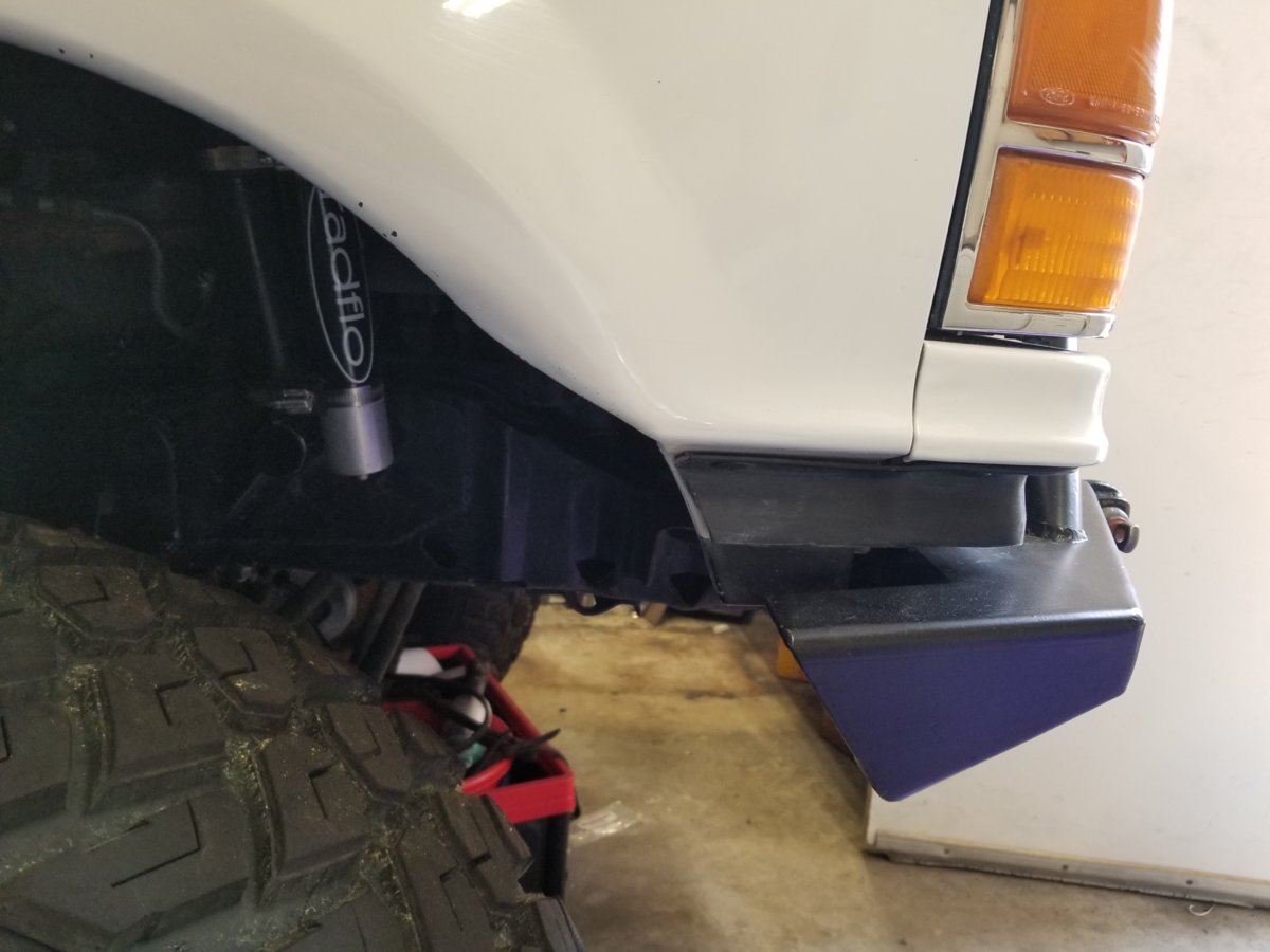

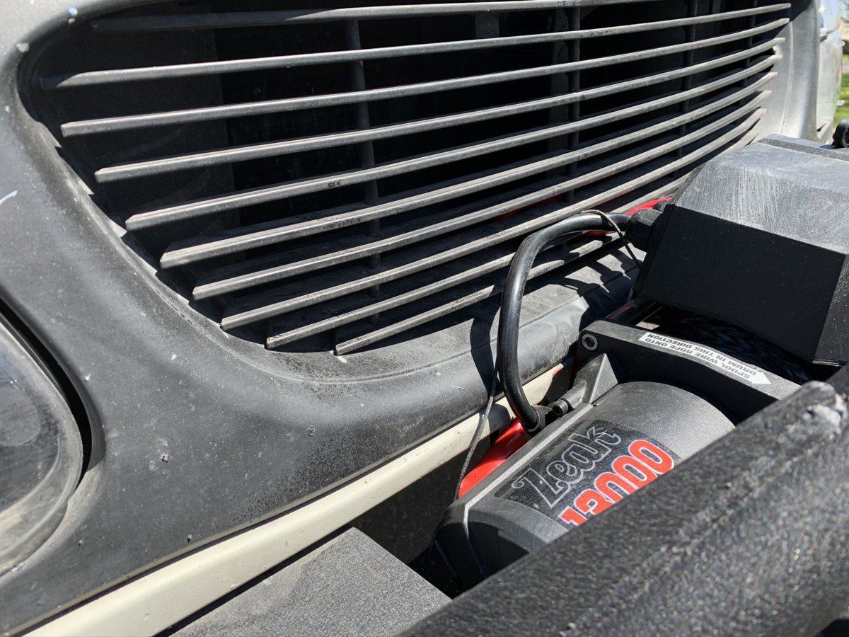

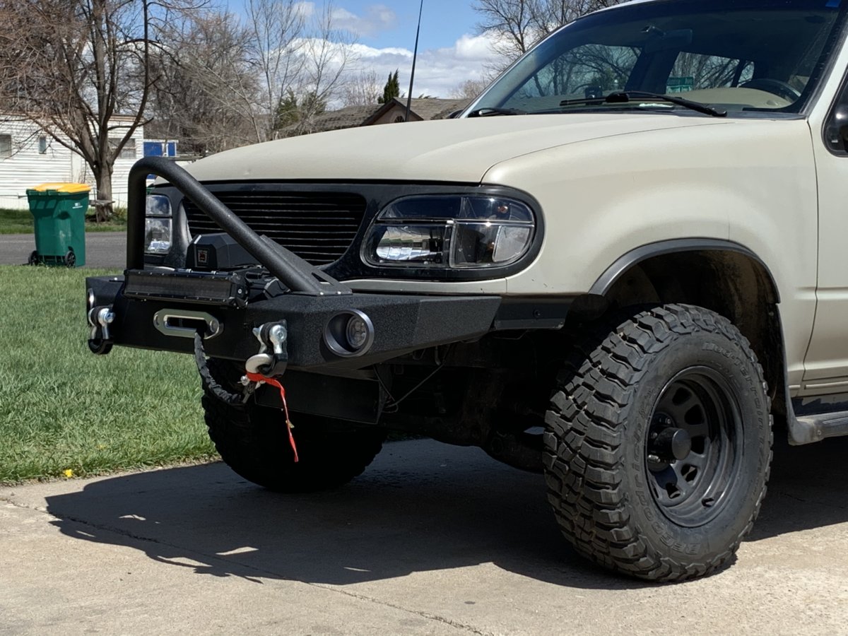

Hey guys for any of you interested in custom offroad winch bumpers willing to fabricate mounting brackets I had really good success with this one made for a Jeep XJ and it's only $265 but really good heavy duty quality.

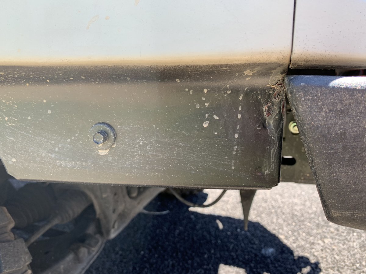

I did have to cut the lower part of the body panel right above the bumper and I wound up cutting a small rectangle out for the 13,000lb winch to fit but that might not even be necessary if you install the winch on the bumper before mounting it. Let me know if anyone is interested and I can provide more pics or answer questions.

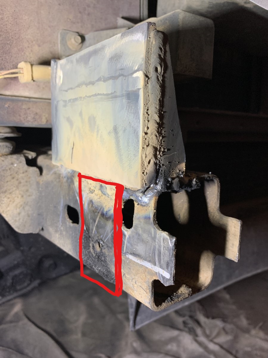

I'd recommend making the bracket then test fitting the bumper to find where to drill the bolt holes.
I may add a skid plate and tube piping in the future.
