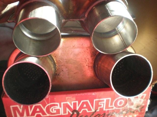

Absolutely...There is too damn much back pressure....For those who may not have the California specification or an older than 99 Explorer my truck has 2 convertors in the head pipe down from the exhaust manifolds and then 2 convertors in series after the exhaust pipe flange and before the muffler...
By keeping the exhaust velocity higher and opening up the old 177k mile convertors to high flow units, I expect to use exhaust flow to assist removing the spent gases from the cylinders and enhance the fresh fuel/air mixture...
What I purpose to do is keep the front convertor configuration and split the rear convertor unit into a seperate unit per exhaust pipe and use the rear o2 sensor in one of the output sides of the rear convertors...By using an x-pipe and opening up the exhaust system to maximum flow and maintaining velocity I suspect that the low end torque levels with stay consistent or improve... I also plan to lengthen the intake runners with an aluminum spacer to increase lowend torque as well.

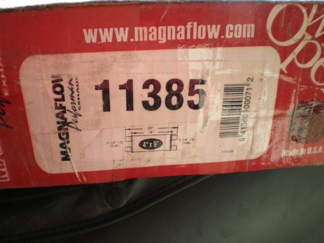

I have a Magnaflow dual-in/dual-out muffler for this experiment...I used these on my Charger and my Ranger with positive results and I have no doubt this will work out on the Explorer as well...In the pictures you see the x-pipe as well as the muffler I have selected for this ...
I have to pass a visual inspection as well as an electronics test here in Texas and I can't remove the rear convertors...
