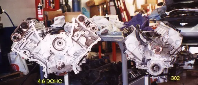

You won't get the mod motor under the hood. Waaaay to big...somewhere on here there is a pictorial comparison of a 302 and a 4.6...4.6 is mucho bigger.
here is the aforementioned picture
